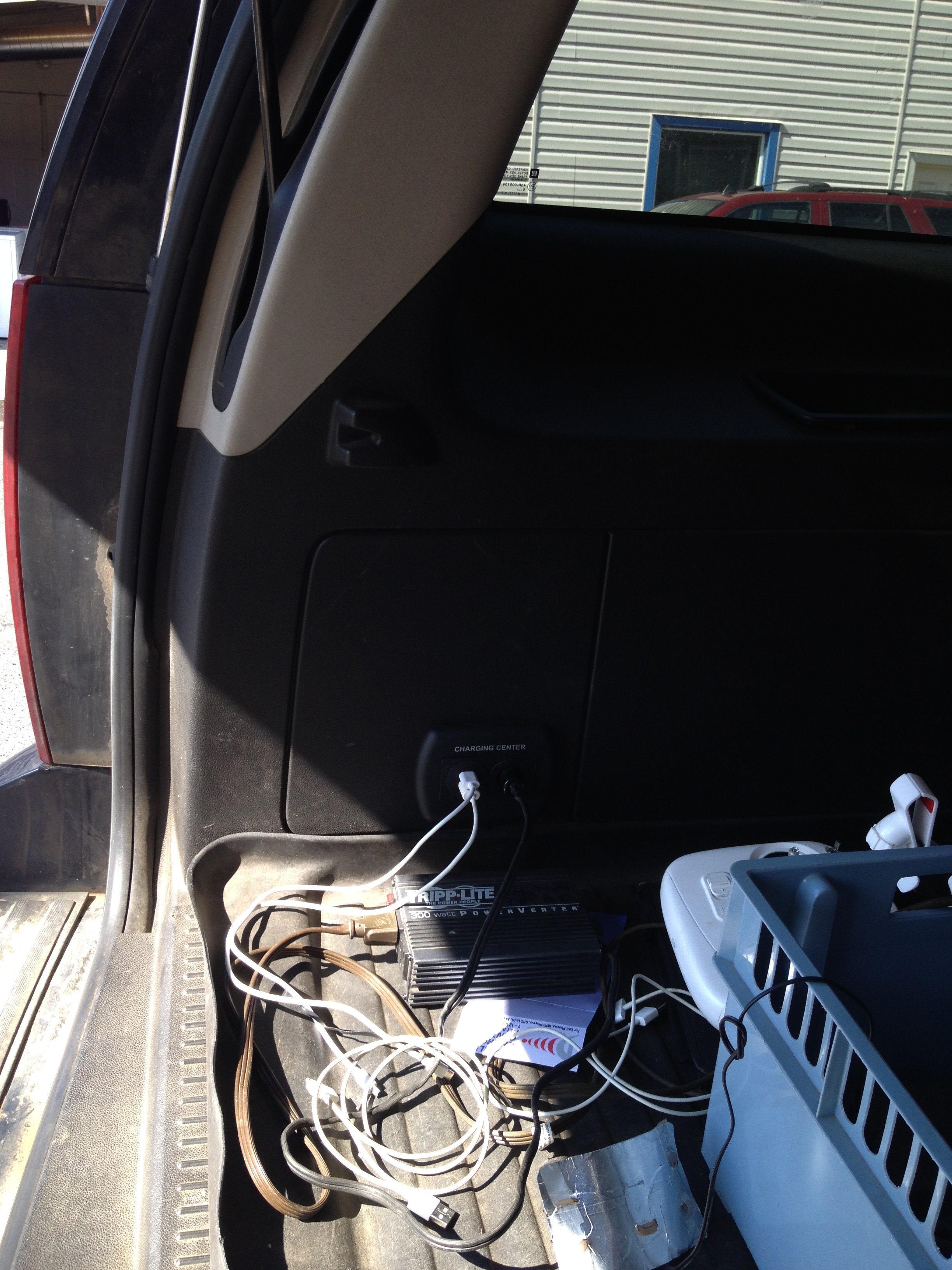

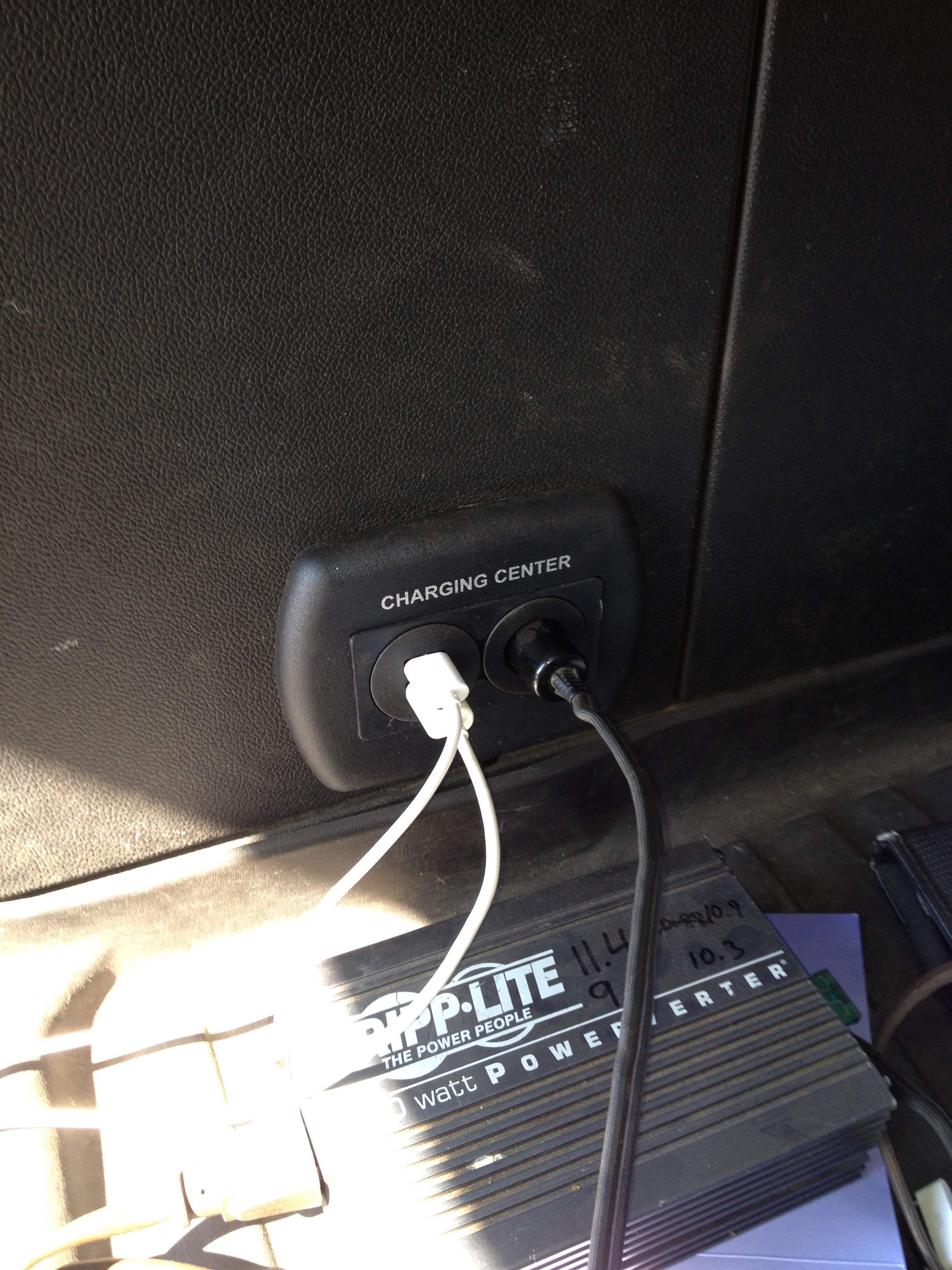

    But just recently I figured out a problem using my inverter in my 07 Yukon, So for the past 9 years I thought it was the inverter. 5 Cig outlets, none of them would power up a 200 watt inverter with out the thing squealing at you and would turn off every time you started the rig.
    Worked fine if you weren't charging anything.:rolleyes:
    Works Great Now!

    So here is what I did, I cut a hole in the plastic and tapped into the power that feeds the motor for rear power door. Got 2 USB jacks, 1 Cig jack, works great!. I think I will use some Velcro and find a place to stick the inverter
