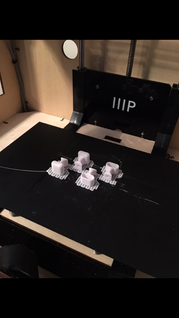

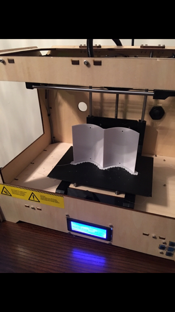

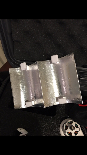

    I first tried a home 3D printed, windsurfer type parabolic reflector and was surprised how much it improved my distance (about 50%) - but it didn't improve my penetration very much through the trees.

    No - the windsurfers aren't just for looks. Out of the box, the antennas on your remote are omnidirectional - meaning they radiate the signal in all directions. Omnidirectional is great for a TV or Radio station or on any type of fixed mount antenna - but on a handheld antenna that you can easily move - more than half of your transmit power is being wasted - sending the signal behind you and beside you as well as in front of you towards your Phantom...
    The windsurfer antennas work by reflecting and redirecting the RF signals that would have been sent out behind and beside you and wasted. It sends them forward where they add on to the Rf signal radiating forward, giving you a stronger signal - but a more unidirectional one - meaning the signal only radiates in a single direction (in front of you).
    With the windsurfers - all of the generated RF signal is sent out forward in a fairly narrow cone. This increases your range, but you must keep your antenna pointed directly towards the Phantom. If you aim too far to the left or right, you'll miss and you may get a lost connection message.
    The Itelite antennas are also designed to send the signal forwards in a cone - but a wider cone, with far more efficiency than the Windsurfers - and with the opportunity of inserting a booster in series, adding even more power and range!
    So - the ITElite panels and kits are better than the windsurfers in every possible way - but if you can't afford an ITElite kit at the moment - the Windsurfers can be used to get a small improvement in range over the stock antennas. You can even build them yourself if you have access to a 3D printer! (Search Thingiverse for the designs)
