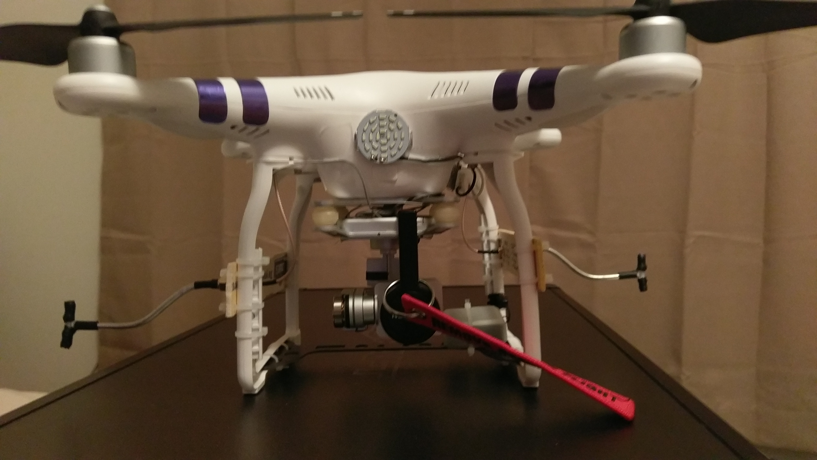

how are you orienting the leg antenna mods? When you turned, you got signal back pretty good ..
Maybe its orientation? See dirtybums posts on that antenna mod thread, he changed the orientation a bit and i think it helped.
also, same location what distance do you get boosted? i see this was unboosted.
Ok i will check antenna mod thread when i reading.
My brid antenna mod front from new 2 x Parts Inspire RC Antenna (B) and Back brid old with 2 x stock RC Antenna. I will check what see my old 2 RC Antenna if wire clean or bad.
Terminator Boosted (brid stock Antenna) at 10,000m No Signal, Strong brid stock Antenna.
MaxxRange Unboosted (bird Antenna Mod) at 8,000m Signal Lost.
