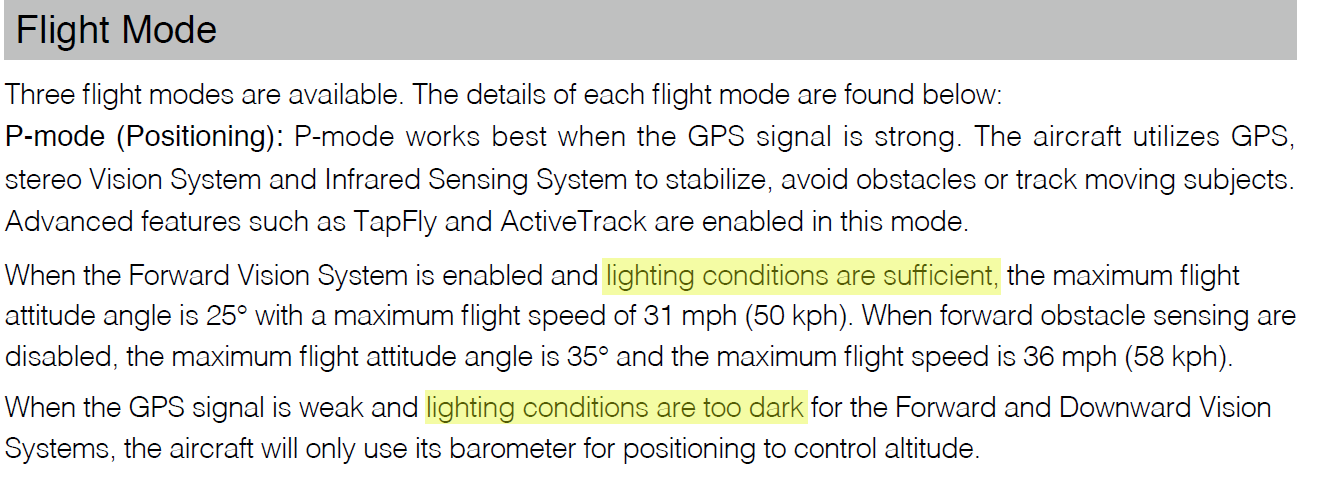

Certain Light conditions can cause this. See the manual.

And was the drone pointing toward a low, bright sun at the time?
That's the usual explanation for mid-air obstacles.
Like Ianzone says, if flying in the open, turn OA off and enjoy the extra speed.
Thanks for all your advice, I think I will turn it off when flying in open spaces.
