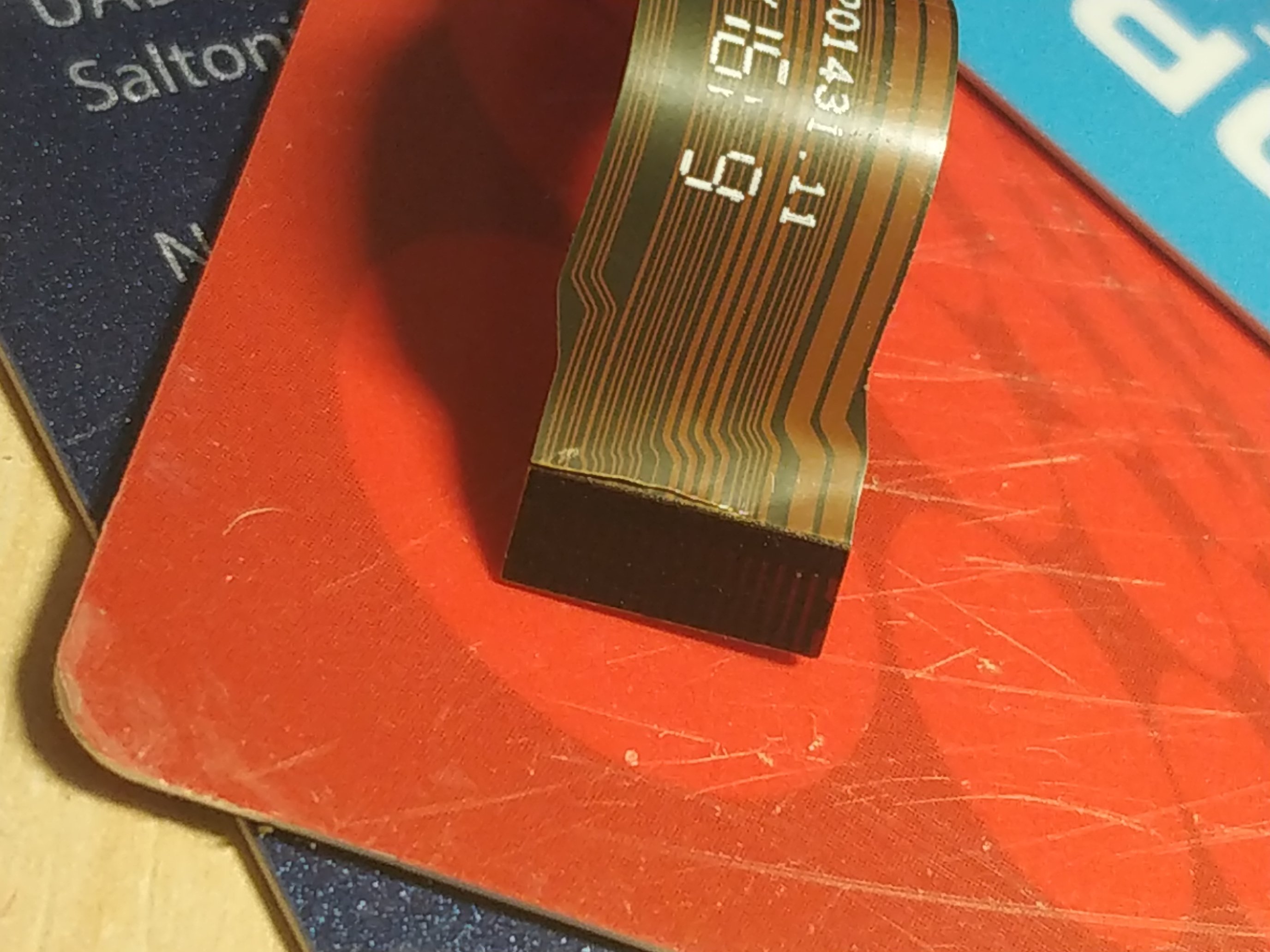

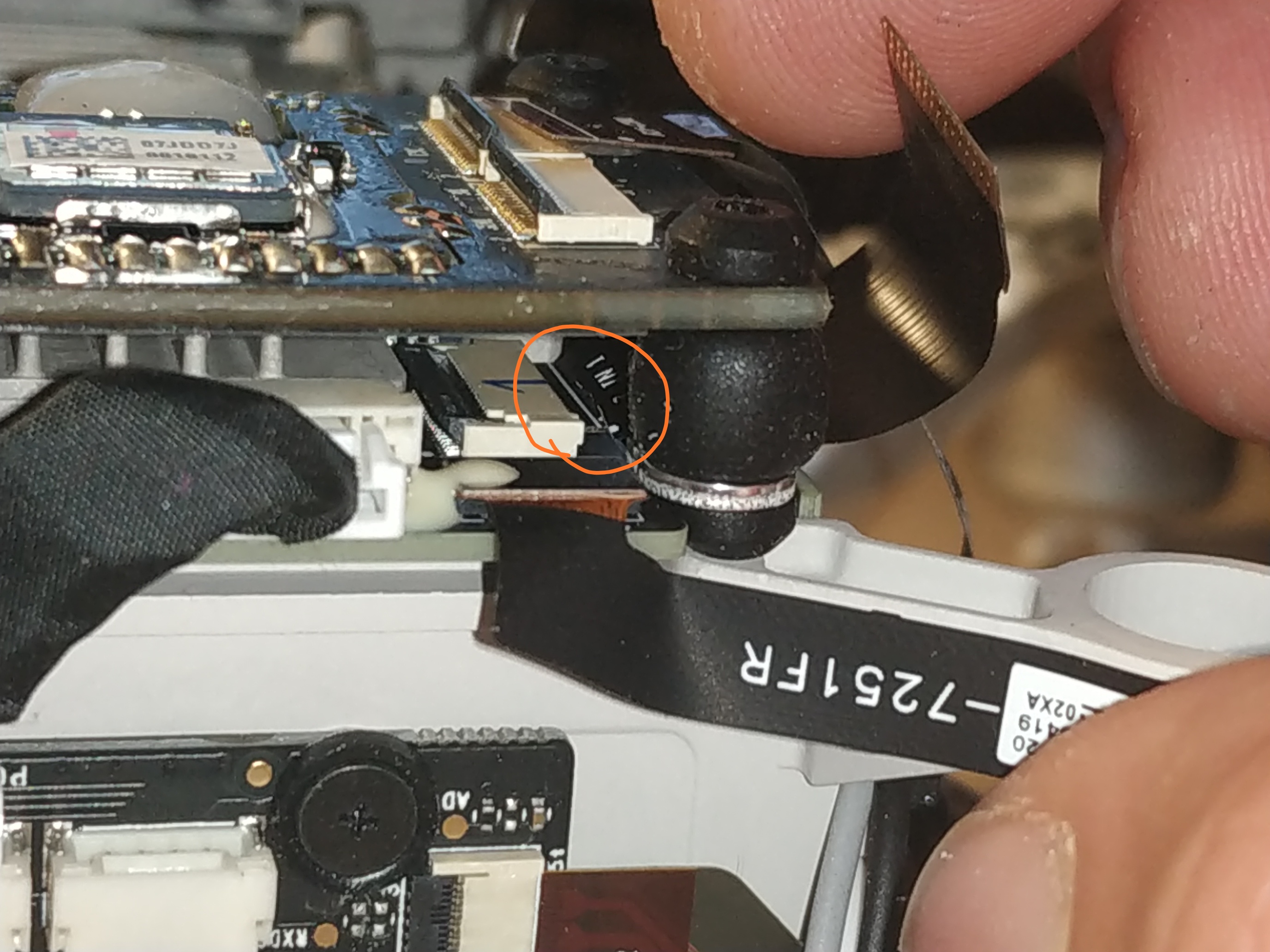

so took apart drone, removed bottom cover... found bad news :(
One flex with TAG FLY_CTRL that goes under internal SDCard is cut in half ;( where I could find it? I really hope I dont need to buy like full internal organs...
Edit: As I understand that flex is one of Part50... Need to find it local :/
So as far as I understand this flex is part of phantom 4 part 34 set or part 50 set? Because at my local stores one say its from part 34 set, other say its from part 50...
