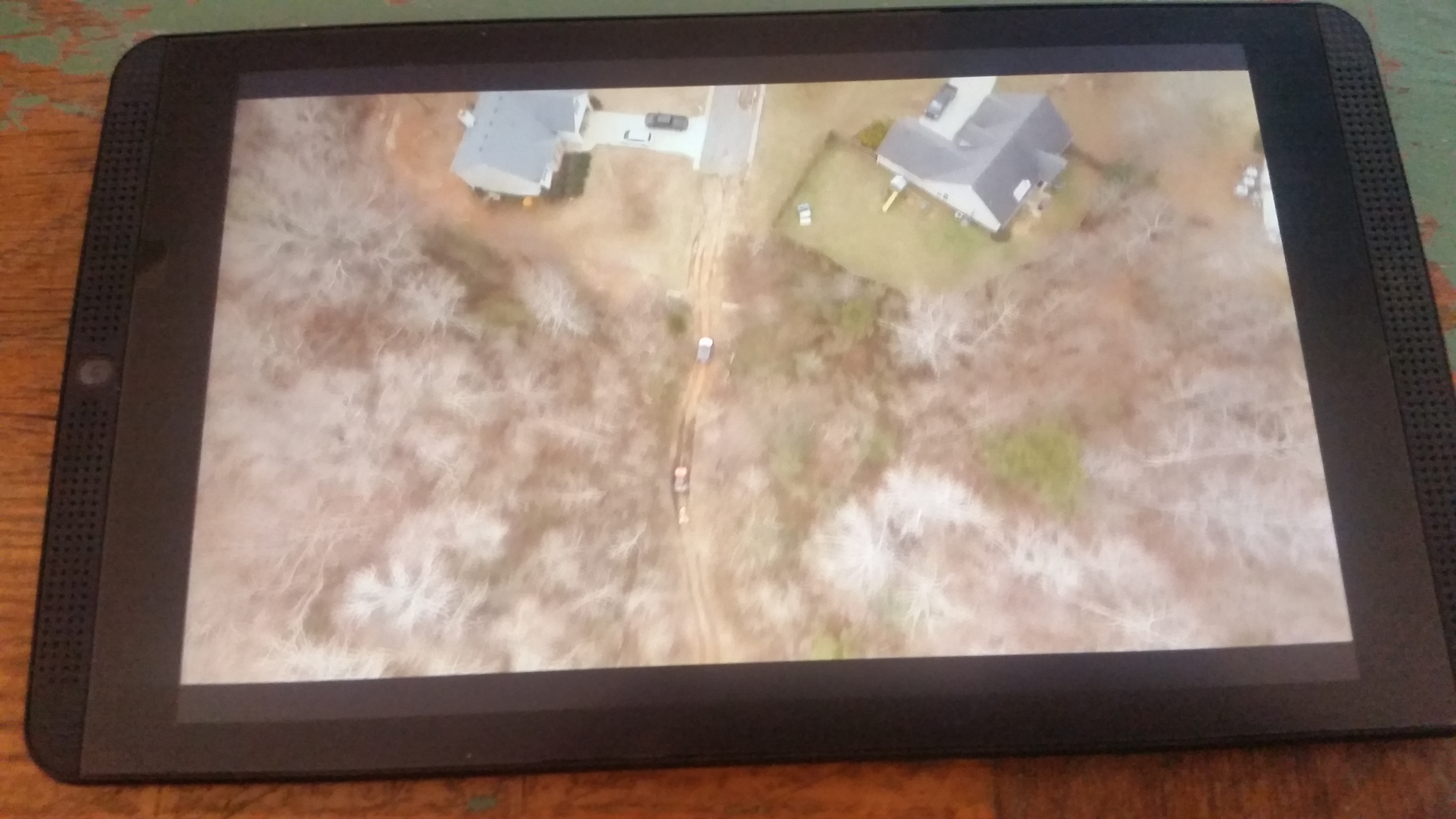

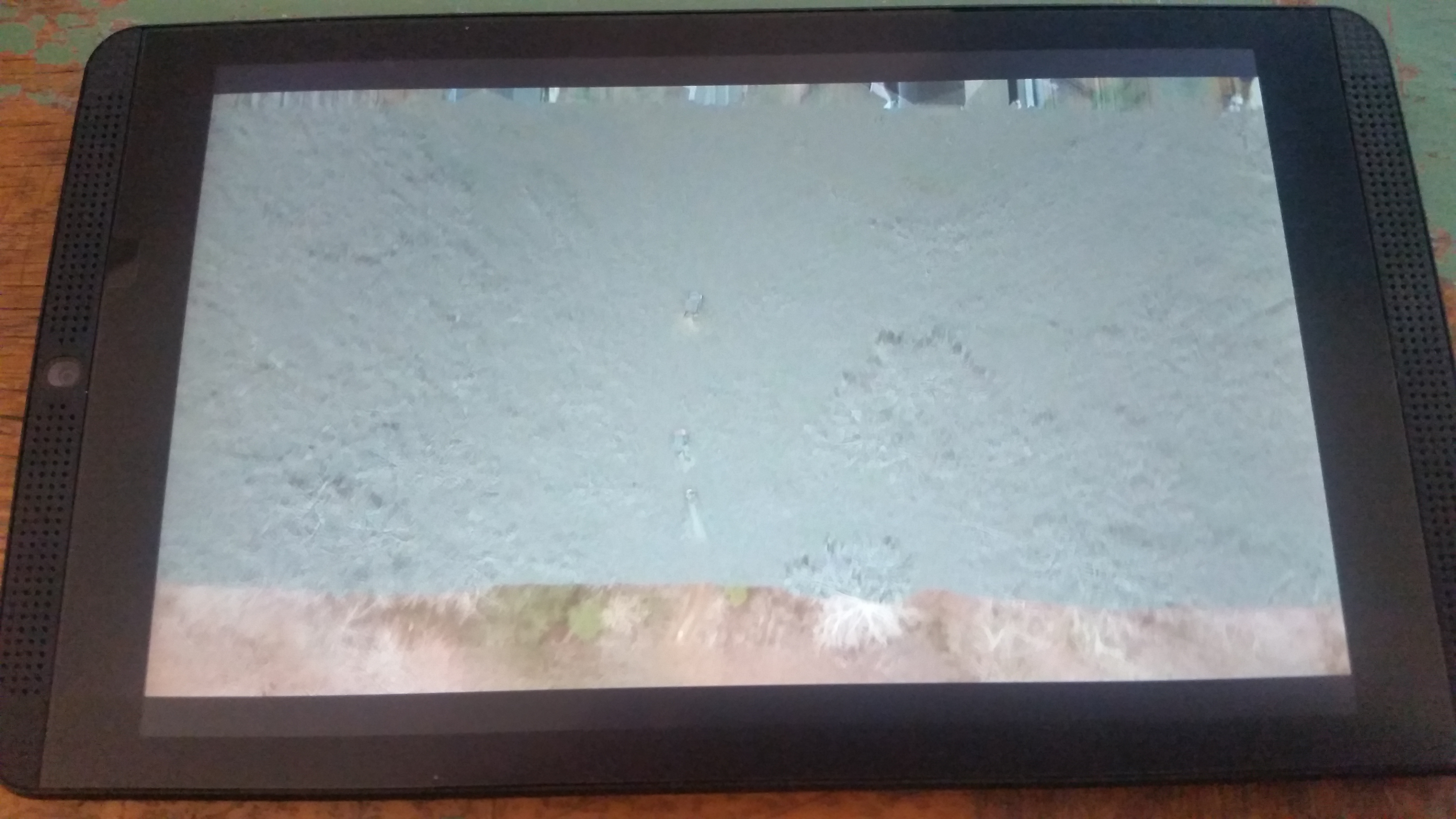

It has done this since day one of owning the tablet (January) I just havent mentioned before now.
Sometimes it does it, sometimes it doesnt.
video gets glitchy sometimes...I can see the glitch when its playing in dji editor, I can see the glitch when it playing direct from SD card inserted into the tablet.
I CANNOT see the glitch when the SD card is mounted on my desktop and played through any editor or player.
this is the glitch, grey screen, portions of the video drop out, a similar glitch happens every time I snap a pic, screen go black, takes a few seconds to rebuild the image, some random colored bars appear for a split second then back to the normal fpv image.
I can get t to replicate if I go into the camera video settings and change the color value from d-cinelike to vivid or someting, then it grey glitches and takes a fraction of a second to rebuilt the image on the screen.
I wasnt able to get a screen cap from the tablet, so below are a couple pics i snapped with my phone.
glitch
no glitch
glitch
no glitch

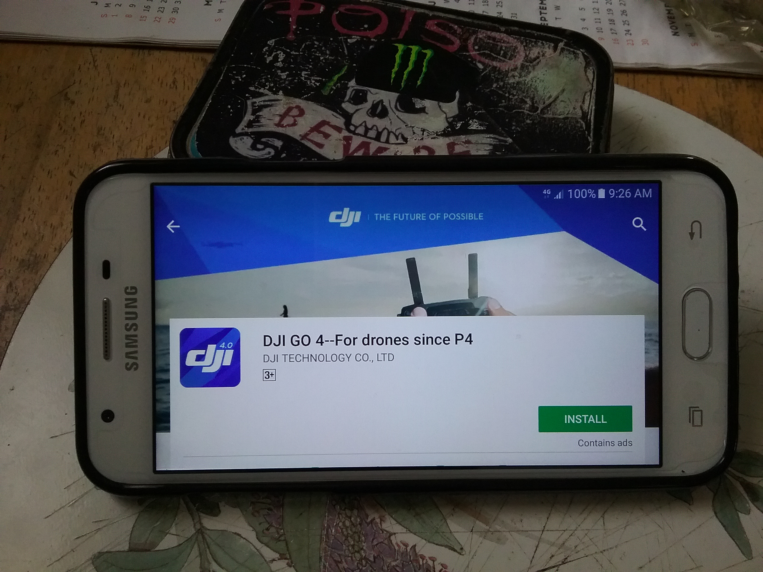

And why u use dji go app thats now for drones before p4 you NEED djigo4 app
no I dont need it, it did the samething with Go4
this is a p4, not p4pro.
