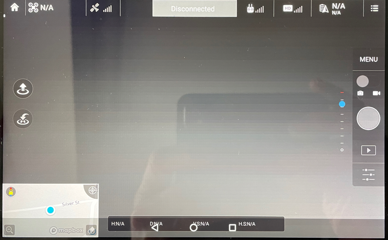

Anybody out there fly with a Nvidia Shield K1 Tablet please?
I've been using mine for years but think I might have changed some of the settings by accident and can't remember exactly what one has to set to use with the DJI GO App.
I remember that you have to go into the Developer mode and set USB Debugging to ON, I think, and USB Configuration to MTP.
Is there anything else one has to set as my Nvidia just won't connect to the RC. The DJI GO App runs OK, allows me to select the Phantom 3 Standard drone and enter "Camera" but then the screen just shows "Disconnected". See photo.
The drone flies just fine but obviously only visually as my screen is blank.

I have been flying my P3A with the Shield since 2016, in fact only last week so there is no software issue. My problem is that the RC is not connecting to the Shield as it was last week, something has gone kaput!
Try clearing the cache on the app you're using (e.g., DJI GO)

Are there any "settings" one has to make on the Shield, like in Developer mode? What have you got set to what?
Mine worked just fine last week!! Thought I might have changed some setting without realising it?

It turned out to be a problem in the Remote Control, probably the USB Interface port. Sent it all up to Drone Optix who confirmed this and I bought a refurbished Remote from them for £99.99. They tested everything, flew the drone with the Shield, and expecting it back tomorrow.
