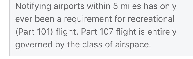

I'm having a hard time accepting that you have passed the Part 107 test but don't even remotely understand the regulations. Notifying airports within 5 miles has only ever been a requirement for recreational (Part 101) flight. Part 107 flight is entirely governed by the class of airspace.

No - that has been entirely superseded by the requirement to obtain authorization via the FAA portal or LAANC. Local ATC will not give authorization for Part 107 flights. And the 5 mile requirement that the OP mentioned is only for recreational flight under Part 101.

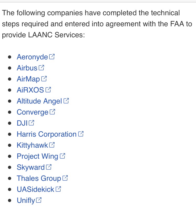

It has not been superseded by the FAA Portal or LAANC, as you CANNOT get LAANC approval from FAA Portal or LAANC. You can only get it from:
And the 5 mile requirement I was quoting was not from OP it was from your statement:

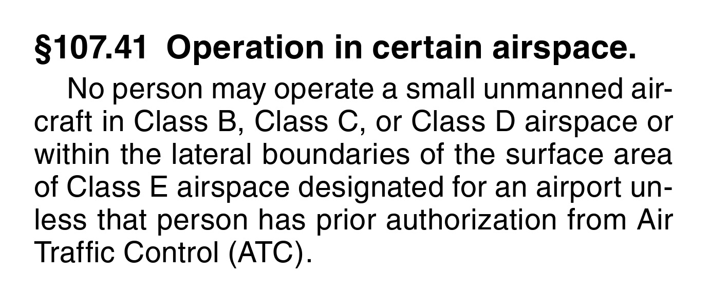

Which contradicts 107.41

And when I pointed out that contacting local ATC had been superseded under Part 107 by going through the FAA portal or LAANC (depending on whether LAANC has het been implemented at the airport in question), you are now arguing that you cannot use the FAA portal (yes - you can) and cannot use LAANC. Or rather that you cannot use LAANC without going through one of the FAA partners administering it - which I never said you could.
As for 107.41 - it states exactly what I said - under Part 107 there is no requirement to notify airports. And the ATC authorization that is stated in 107.41 is now achieved via the portal or LAANC:
