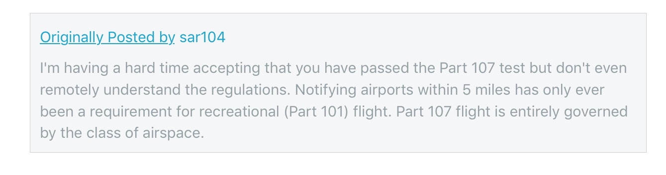

At the beginning of this thread someone said, "I'm having a hard time accepting that you have passed the Part 107 test but don't even remotely understand the regulations. " I am having a hard ime accepting that anyone passed the test because no one seems to agree on what the law is.

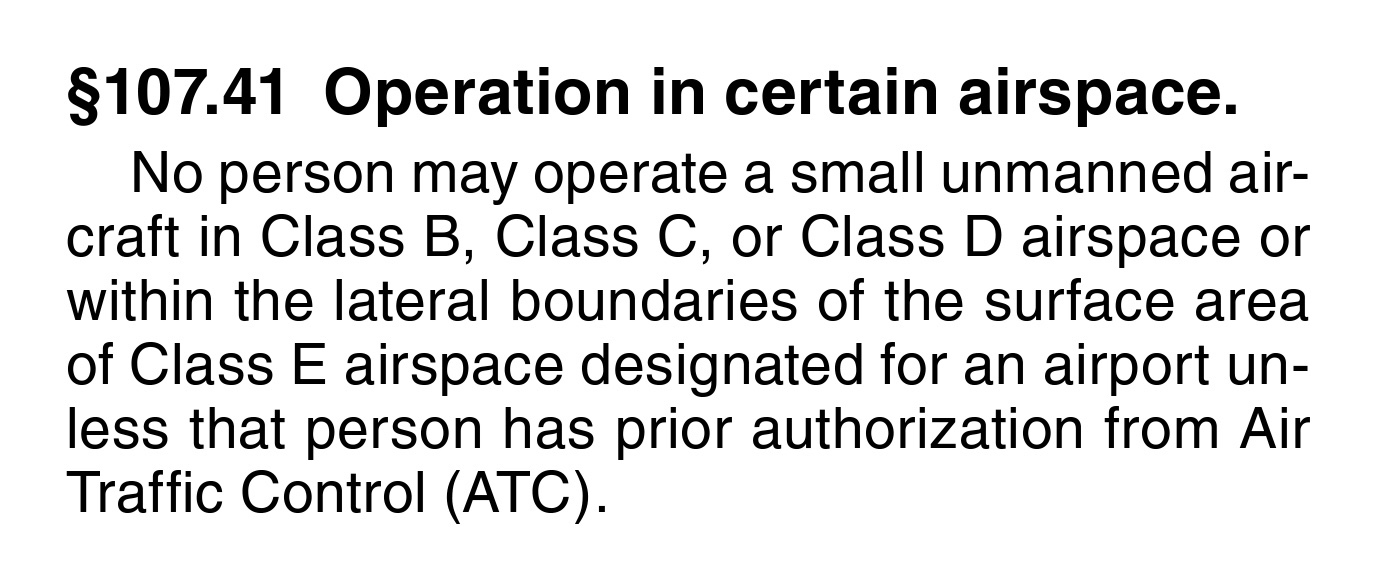

That's certainly how it looks, but it's because people are posting without even bothering to read the law. The following two links are essentially complete. The first one is the full set of Part 107 regulations. The second is the current FAA description of how to comply with 107.41, which is either via LAANC or, if that has not yet been rolled out to include wherever you are trying to fly, the FAA portal for waivers and authorizations.
14 CFR Part 107
Flying Drones Near Airports (Controlled Airspace) – Part 107

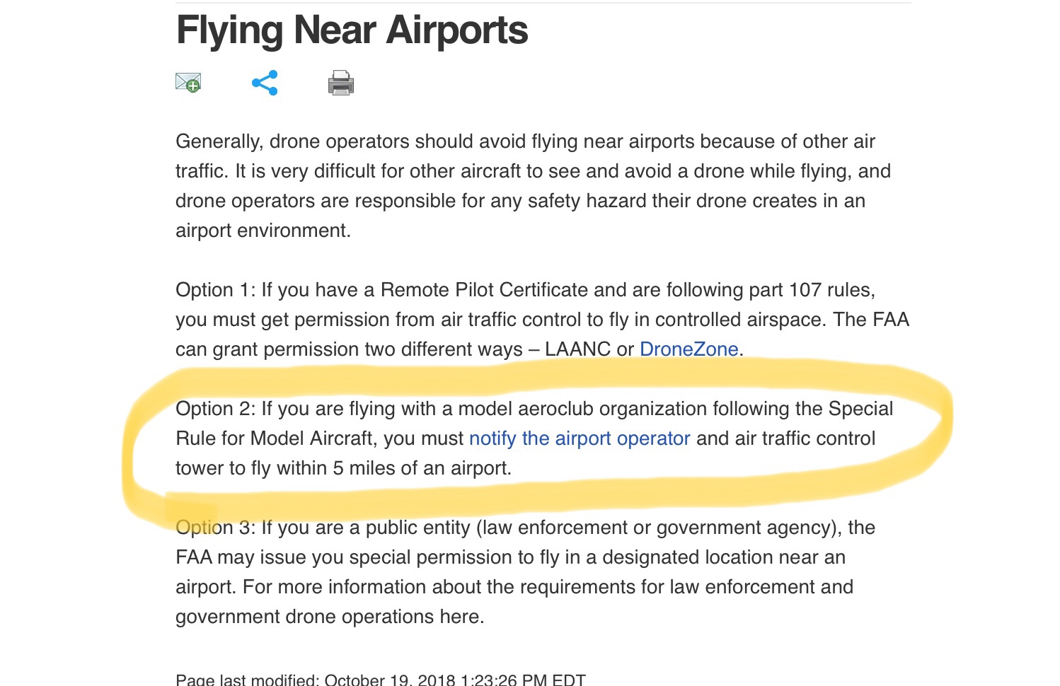

You are posting random disinformation. First of all you stated that notification to airports was necessary under Part 101, presumably confusing that with earlier requirements to get authorization for non-recreational flights directly from local ATC.
And when I pointed out that contacting local ATC had been superseded under Part 107 by going through the FAA portal or LAANC (depending on whether LAANC has het been implemented at the airport in question), you are now arguing that you cannot use the FAA portal (yes - you can) and cannot use LAANC. Or rather that you cannot use LAANC without going through one of the FAA partners administering it - which I never said you could.
As for 107.41 - it states exactly what I said - under Part 107 there is no requirement to notify airports. And the ATC authorization that is stated in 107.41 is now achieved via the portal or LAANC:
You really have no clue what you are talking about.
You have a big play on words and misplacing quotes
Follow your posted link and it will take you to page of listed providers to access LAANC or the DroneZone to fill out airspace waiver that could take about 90 days to get approval.
I have no other words to exchange with you and will end my conversation with you here.

You are back to quoting recreational rules. What is so difficult for you to understand about the distinction between recreational and Part 107?
Reactions: FLYBOYJ
