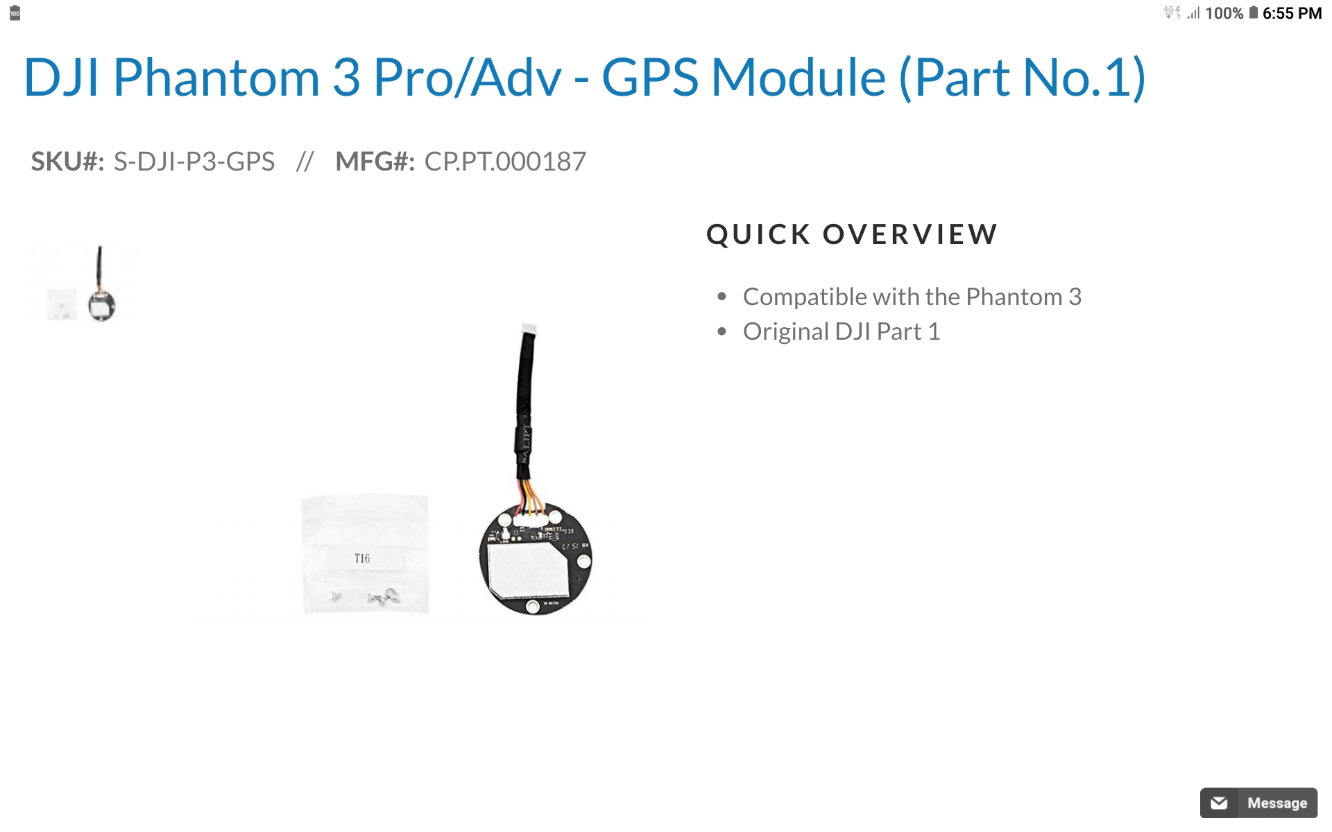

It could be GPS module, got another to try...looks like this,,if you getting no sats or greyed out this baby could be the fault

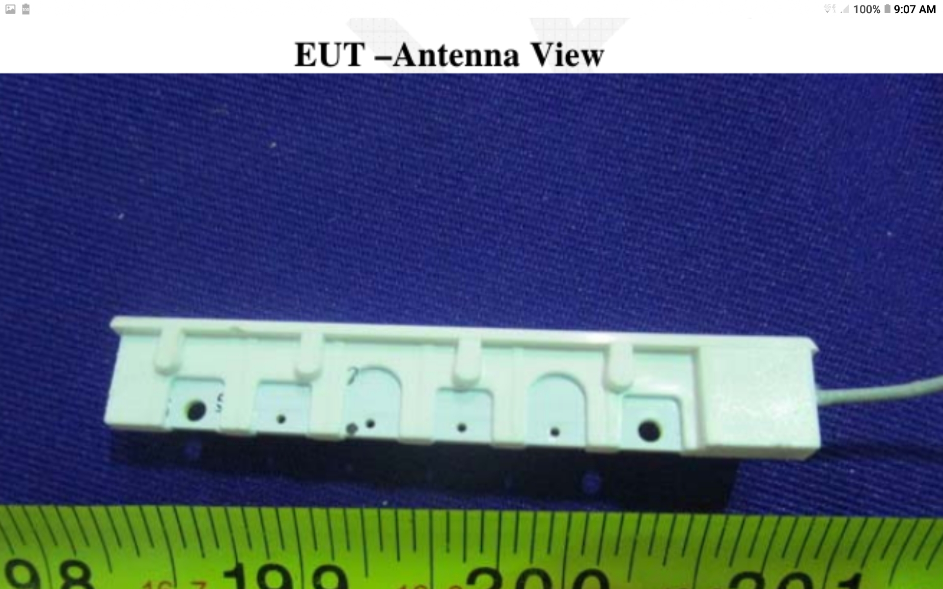

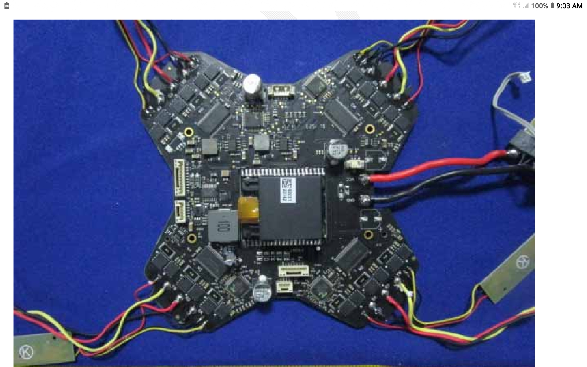

Ok you mention a compass module change did you check the antenna or try change,,,its bit tricky with damaged drone to diagnose,,becomes guessing game,I got sore eyes from searching a result on this....thers nothing on top of shell is there to block it working,,,,if changing all these bits and it doing nothing it might be main board damage somewhere,do you have this in your spares,,,I dont want to advise to buy it cause yours might be ok ,have good check of pins where GPS plugs in ....also what's it say in app in STATUS,,any prompt there saying what not working
