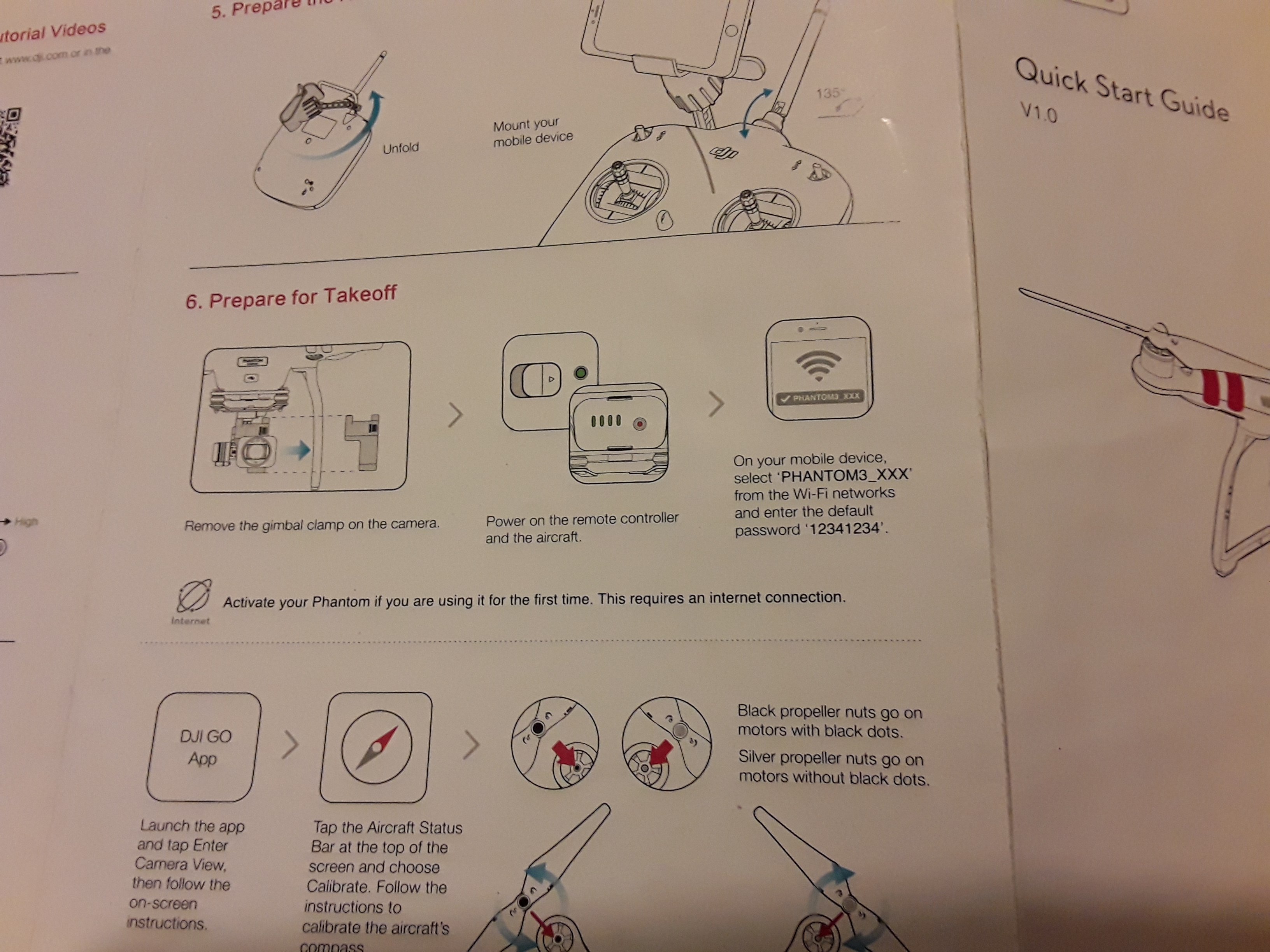

Yip have you done this from quick start

try turning the RC on.........it is the 'router' for the phantom network..

HI Yip rc lights are normal I think it something to do with your WiFi set up,,,,do you have a saved phantom on your device,eg phone,,"phantom3_xxx" 12341234 this is default password which needs to be saved in WiFi networks for phantom to connect :)if you been connected to this you should have it saved in WiFi, ,,,
