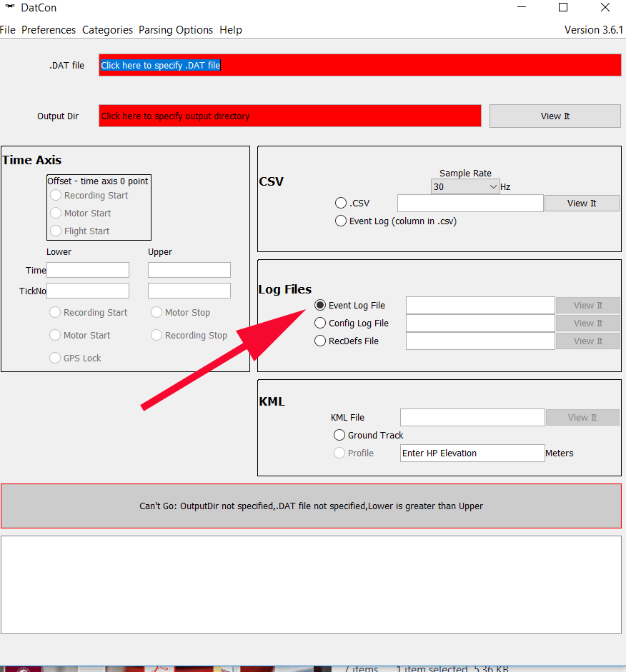

Did you get all that from FLY320.DAT? I used csvView but I couldn’t see near this much data.
Do a re-extraction of the dat file with DatCon. De-select the CSV and Select the event log. It will create a seperate .txt file that you can open with notepad, word or whatever you prefer to use. That's the quick and dirty way.
Do a re-extraction of the dat file with DatCon. De-select the CSV and Select the event log. It will create a seperate .txt file that you can open with notepad, word or whatever you prefer to use. That's the quick and dirty way.View attachment 104219
Thanks, I’ll try that after supper. I did initially use DatCon but tried to open the resulting file in Phantom Help viewer which didn’t work
@Fly Dawg
That worked, thanks. Opened it in TextEdit on my Mac. I have learned a lot from this.
