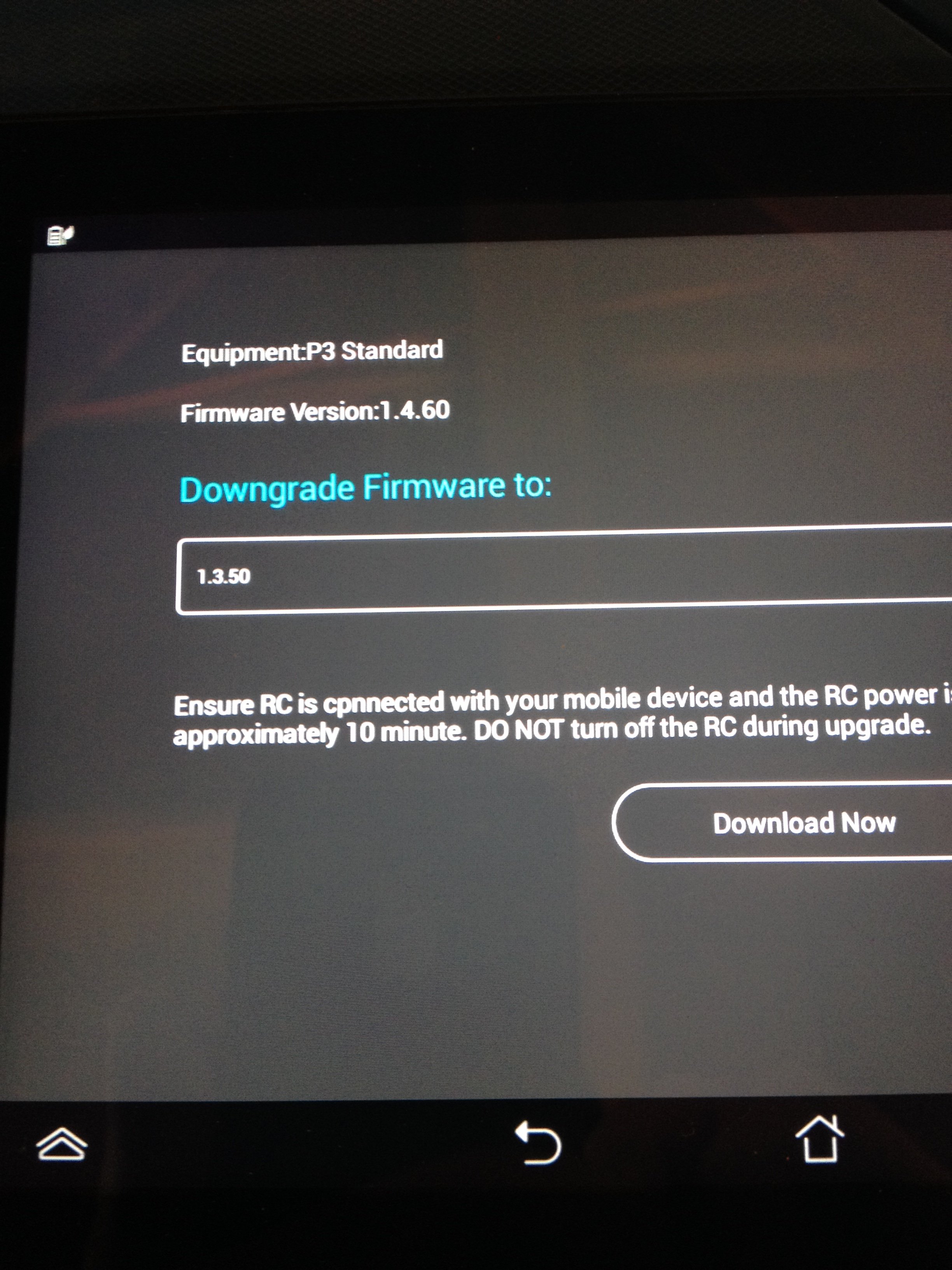

Didn't get very far last night, this was an option on my Android Friday the 15th.
Firmware now is 1.5.70, Now it is gone on the Android.
The IOS unit never showed a downgrade choice.
Did the firmware with the IOS, oops, should have used the Android, I don't know.

Gave up for now, at least for the firmware backwards routine, If we had not went to 1.5.70 we could have downgraded, I think. I still think that once this problem occurs at least on a firmware update, it is not fixable..
