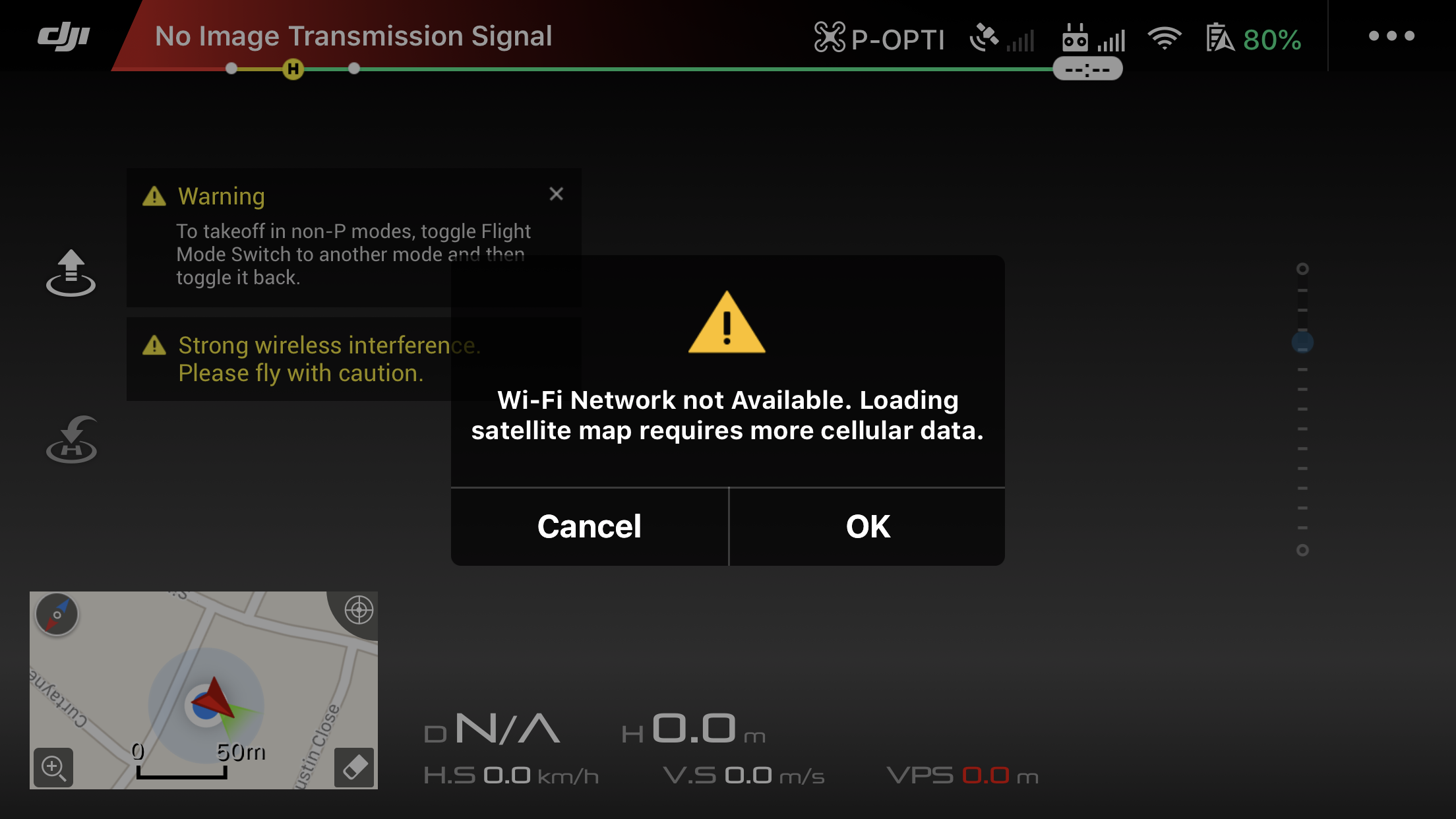

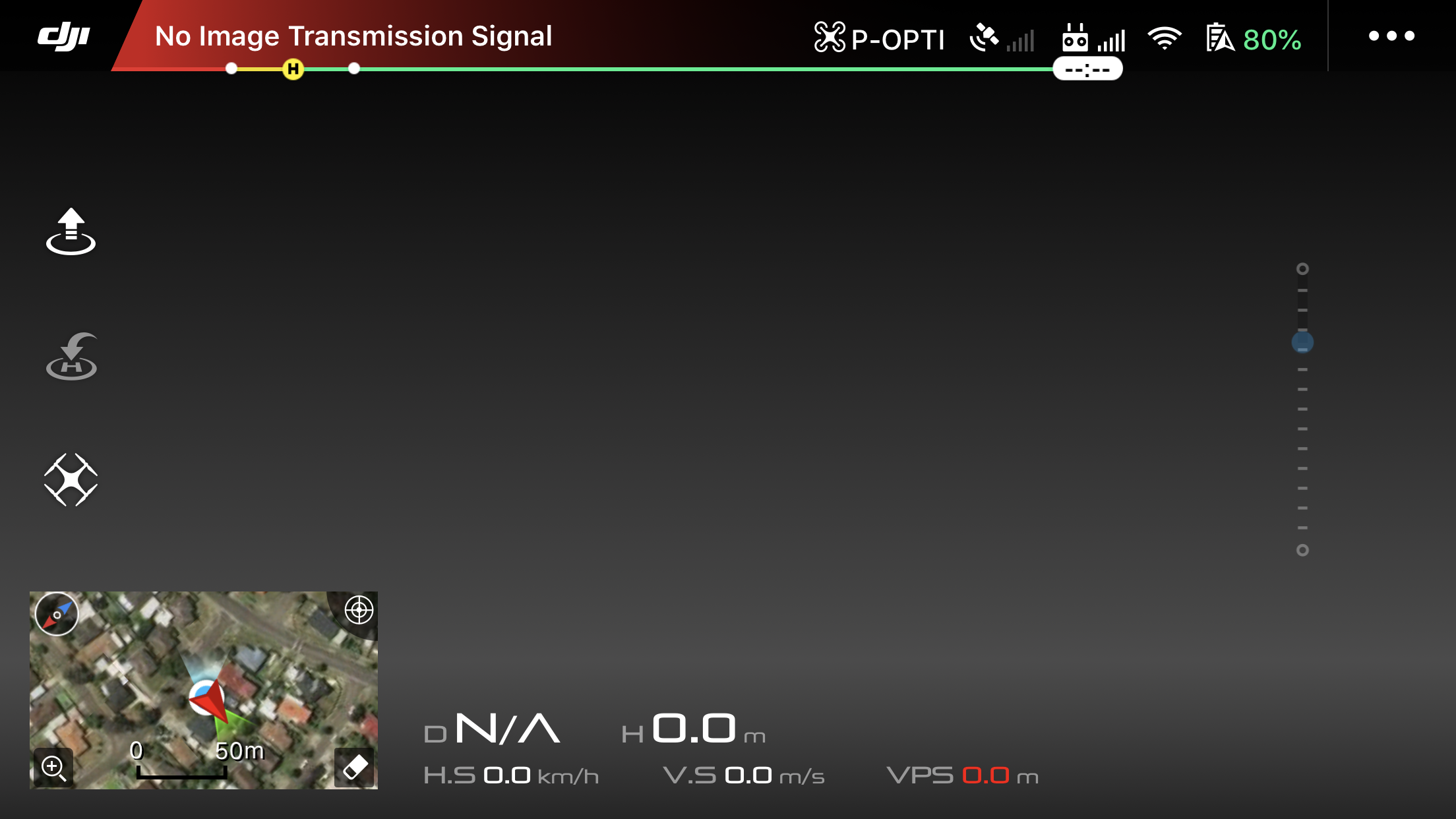

My phantom 4k fell into water few days back it, after drying out right out given everything a good clean and put back together it seams to work fine with everything but the camera has no image on my phone and the warning “no image transmission signal”
The camera does that full range of moton thingy it does when turning on works in manual for a few seconds after. It then stops!

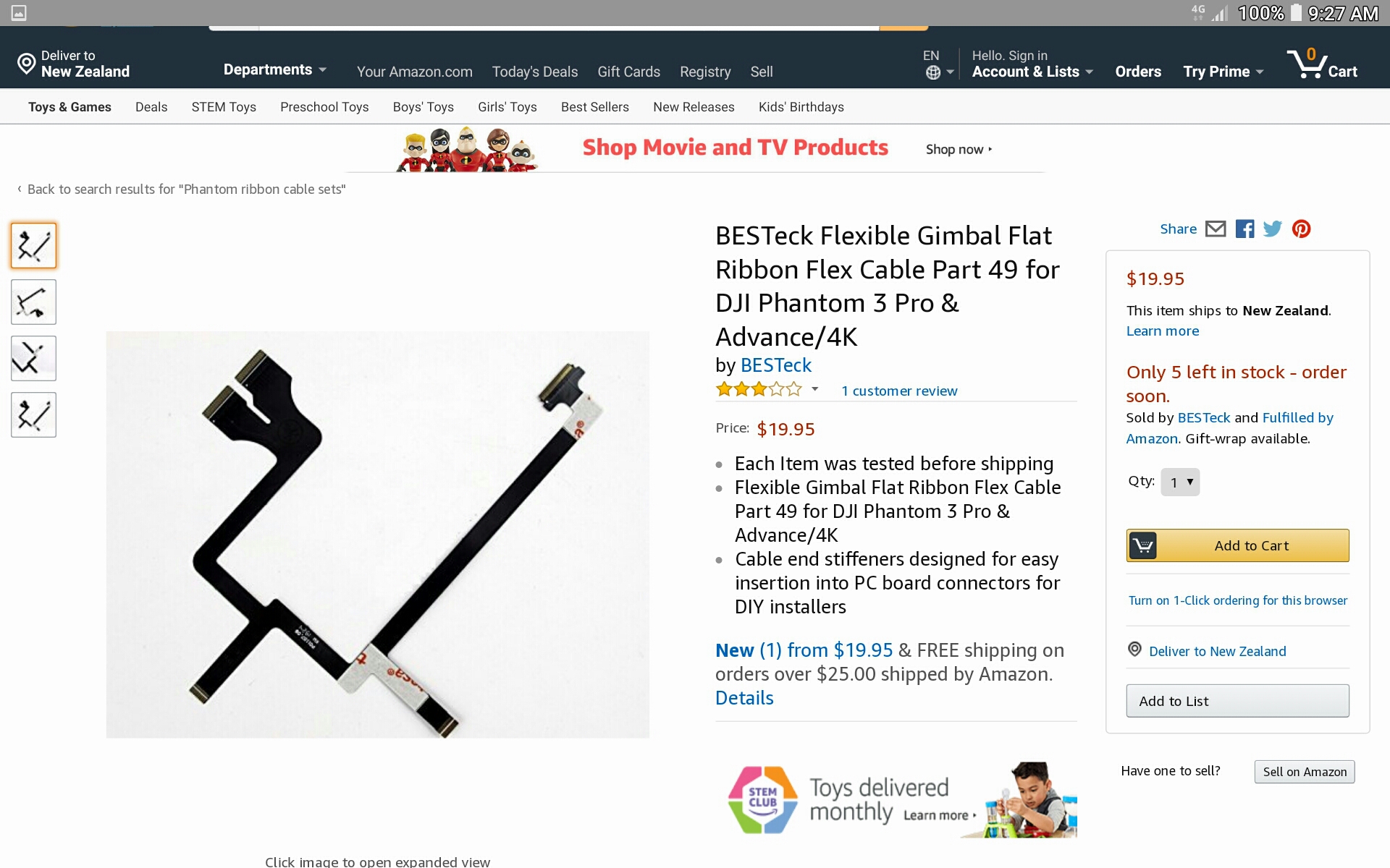

Mayby try a new flat ribbon cable set,,I could have helped you but I just mailed my cam overseas,cable sets are cheap which is good.....,,,$$20..

Mayby try a new flat ribbon cable set,,I could have helped you but I just mailed my cam overseas,cable sets are cheap which is good.....,,,$$20..View attachment 103429
Yeah thats a possible option, do you know if that ribbon is for the motor and image or just one? Because the camera motor work until it fault out.

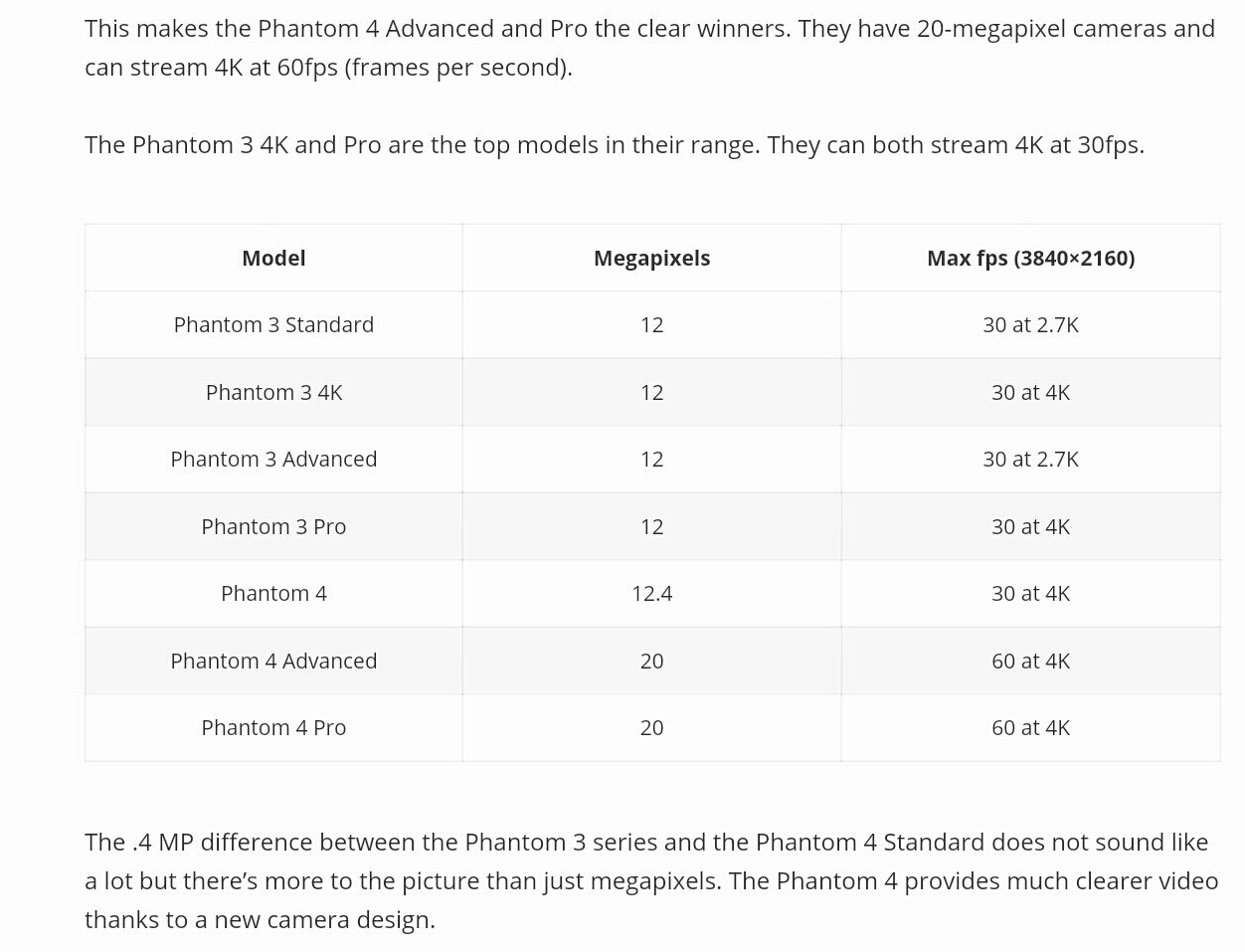

Are the 2.7 camera from a standard or advanced compatible with a 4k?
They for use same camera but have a feeling the ribbon cable might be different just to be annoying,,p34k is just a p3s with vps module on the bottom, you could try this but I would have both ribbon sets on hand in case

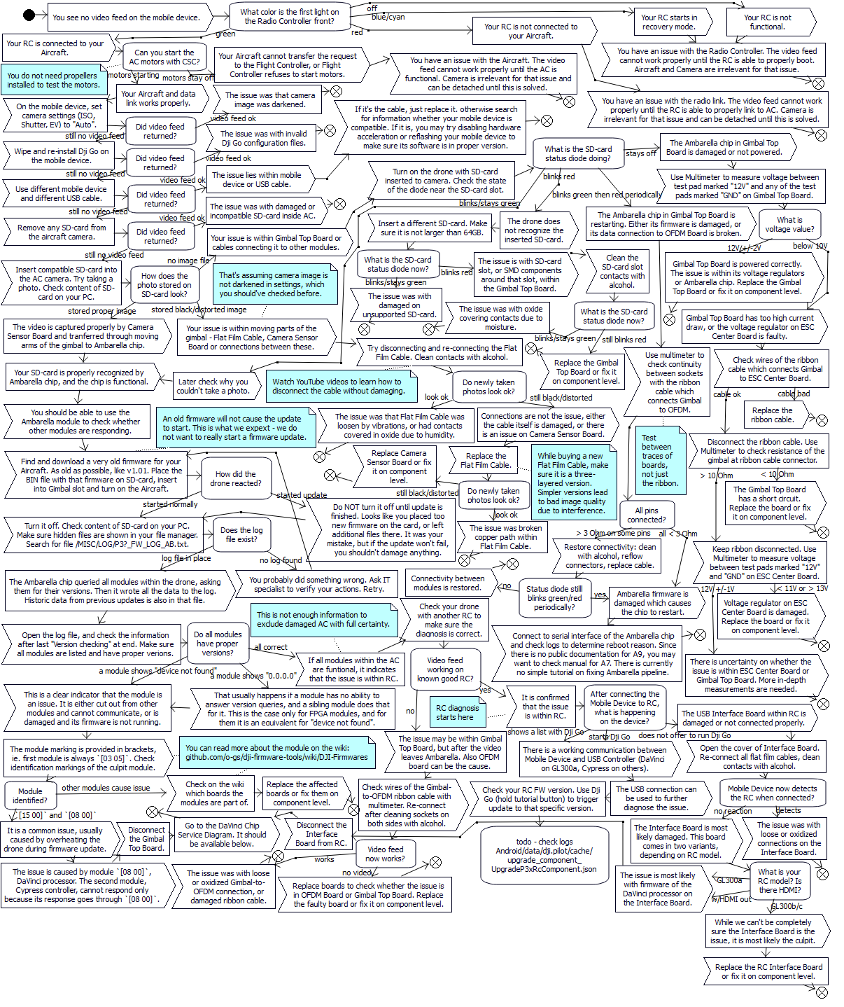

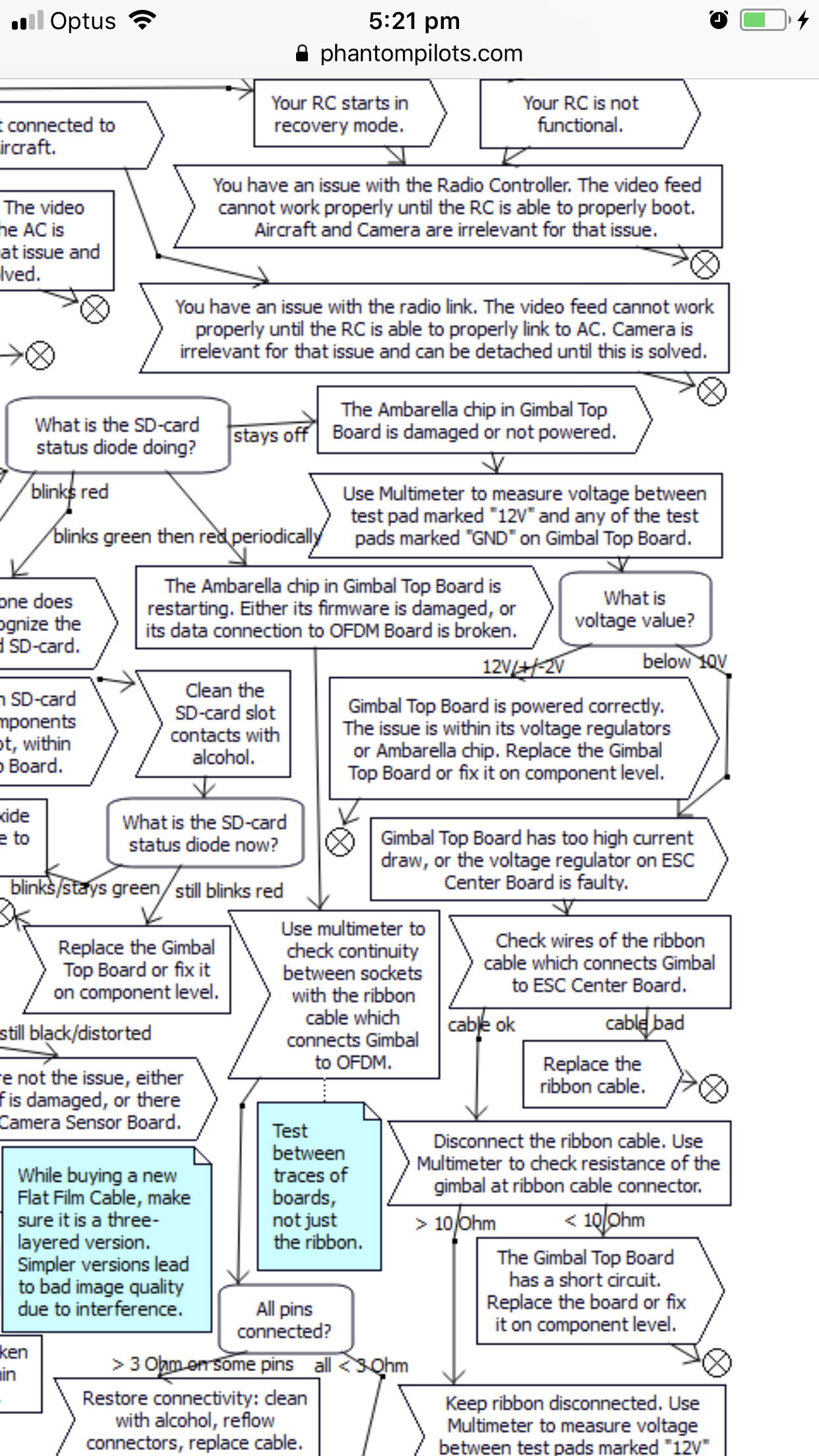

Most of my research is from this, I found in the advanced/pro section.
