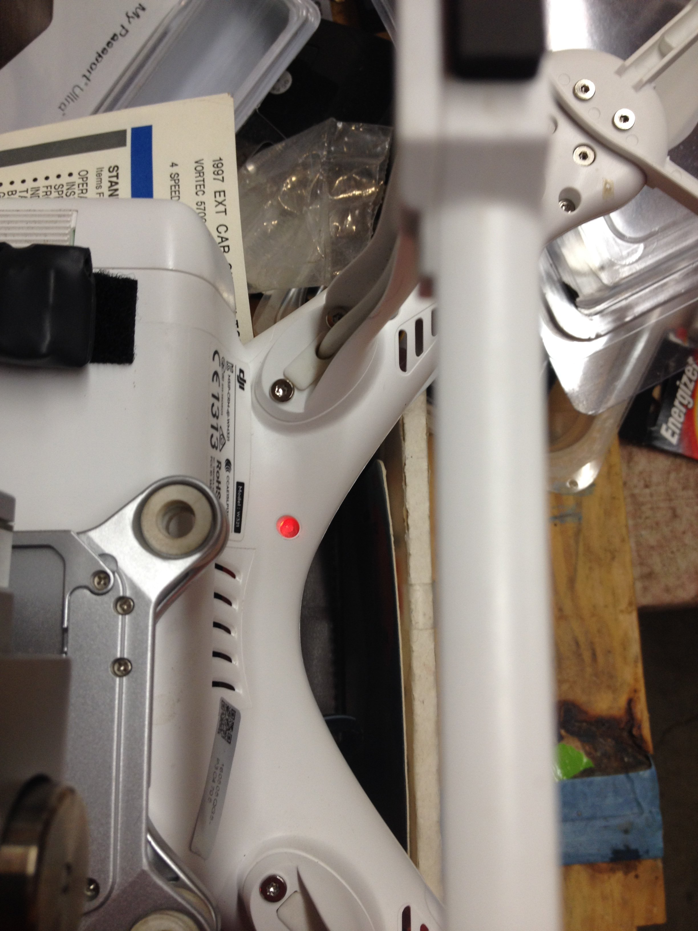

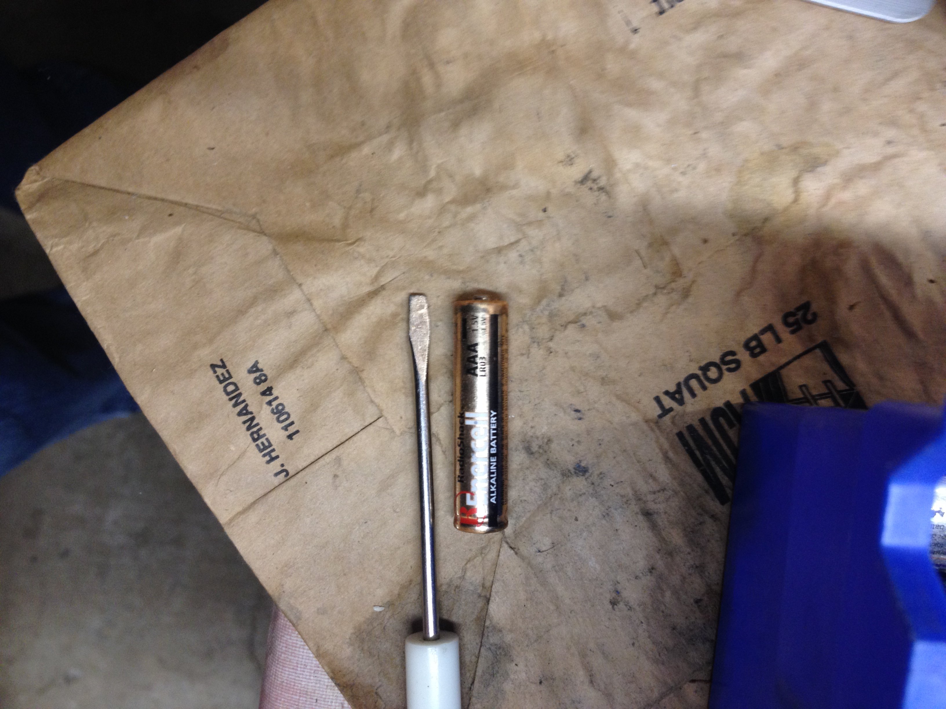

Ok, here you go...
Just did this just for you, ;)
Using this size or smaller.
Bird upside down and powered on.
Red light solid, remote control off.
Do you have a light?
If phantom is on and the remote is off, the light should be solid red.
If the remote is on and linked the light turns green.:D
If its green, then its linked.
So when you poke the (button/light) you can feel the (button/light) depress and also hear it. Even if the Phantom is off.
Don't hold it, I don't know if that's a factor or not, its just a simple tap.
So when I poke the (button/light) and release with remote powered off, the light which should be red, starts flashing on-off red.
I don't want to go farther from here, tell I get a update from you..

Ok, here you go...
Rod

Ok, here you go...
Rod

Wow, flashing green?, I will look in the manual.
The link button looks like it may have moved because i can see two thin red wires to the one side.
Yes, now your on it, I is stuck on (depressed) that has to be it., I looked at your picture twice, it has moved.
I kept thinking of what @Ohiowoodsman said about the remote was green and realized when I was doing my testing yesterday that if the remote power light is green, it knows it connected the Phantom.
The phantom is stuck in a re-link mode, etc. I should be red solid when powered on with the remote off. When I was testing,
Remote on, phantom on, both green.
Remote off, phantom red solid.
Remote on, phantom off, remote red solid.
Pressing link button on phantom, flashing red.
Crap, now it so obvious, take the top off that sucker, and fix it.
There are some instructions on here on how to do it, but your going to need those two sizes for those screws by the motor.
