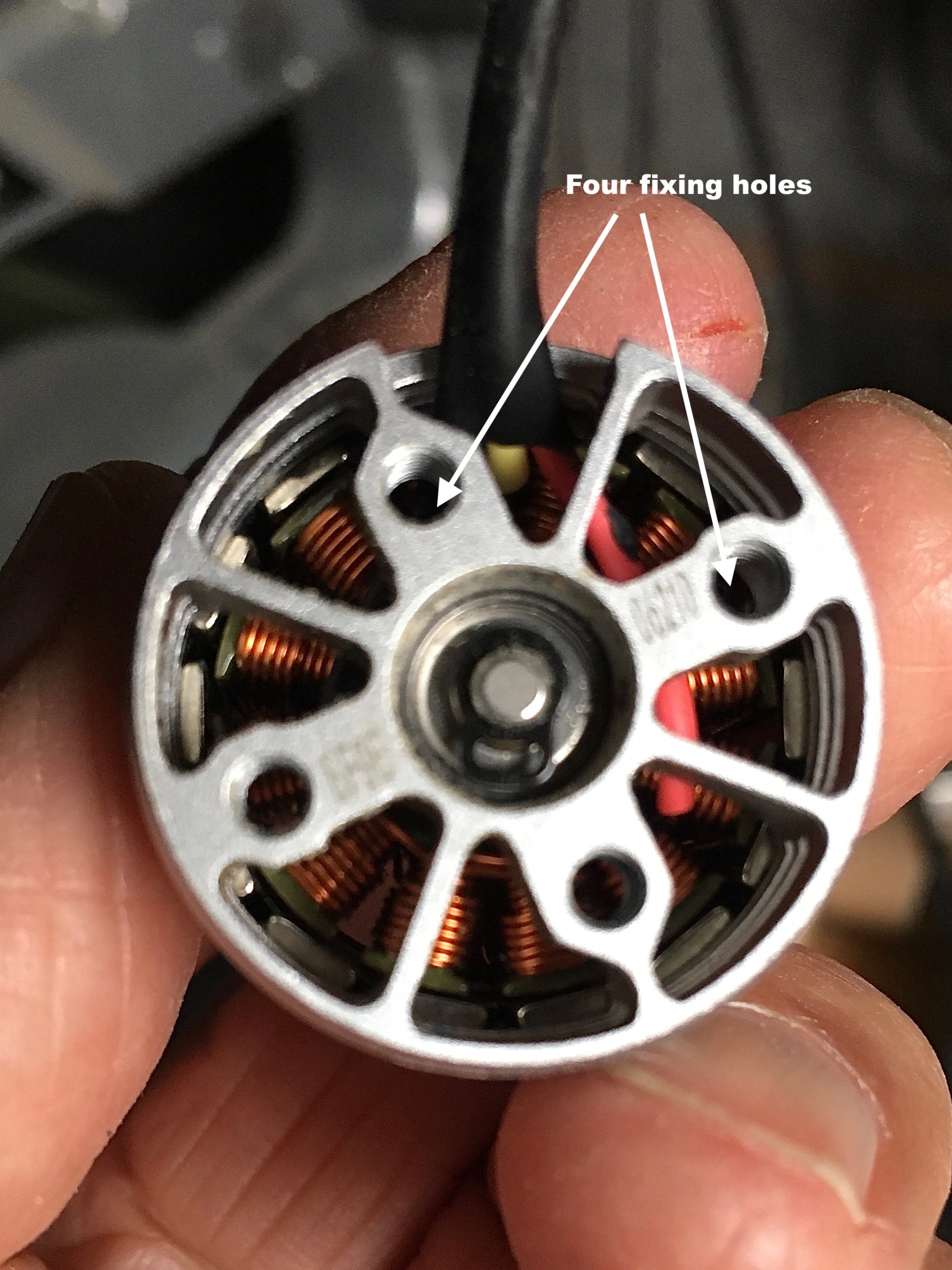

"Yeah I guess that would be a good starting point seeing as how the guards are removed and the screws holding the motors on are loose I guess I’ll order 1 new motor for testing purposes their only $18 and won’t hurt to have a spare if they end up being ok"
Definitely take all four motors off and check the windings as it is very possible the longer screws for the guards have been put back in. You can see in this picture, the holes are only 4mm deep.

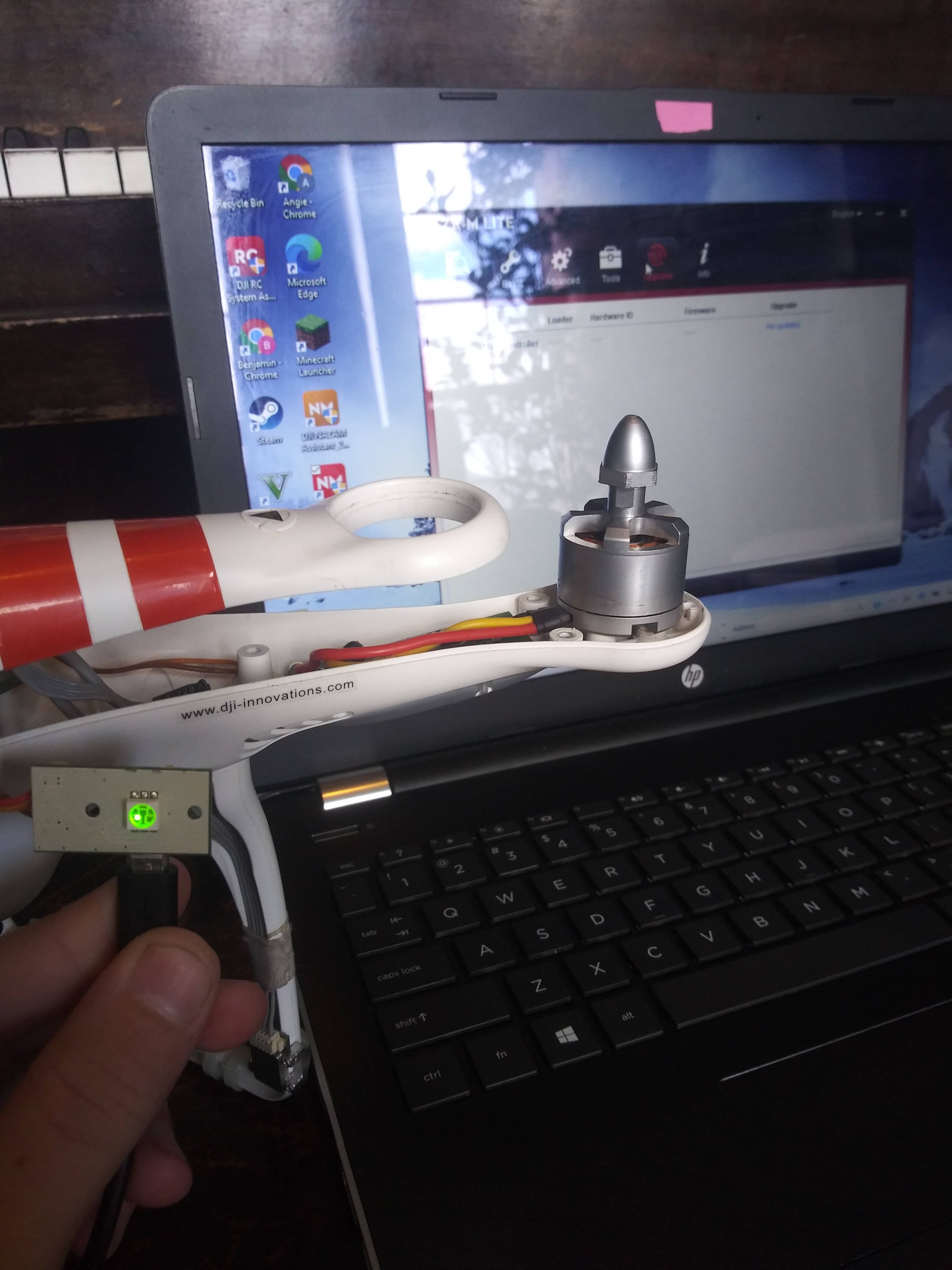

Hi i have a dji phantom fc40 and when i do an update and plug it into a pc it gets a very dim green and it falshed red fast 4 times how do i fix?? Thank you in advance
