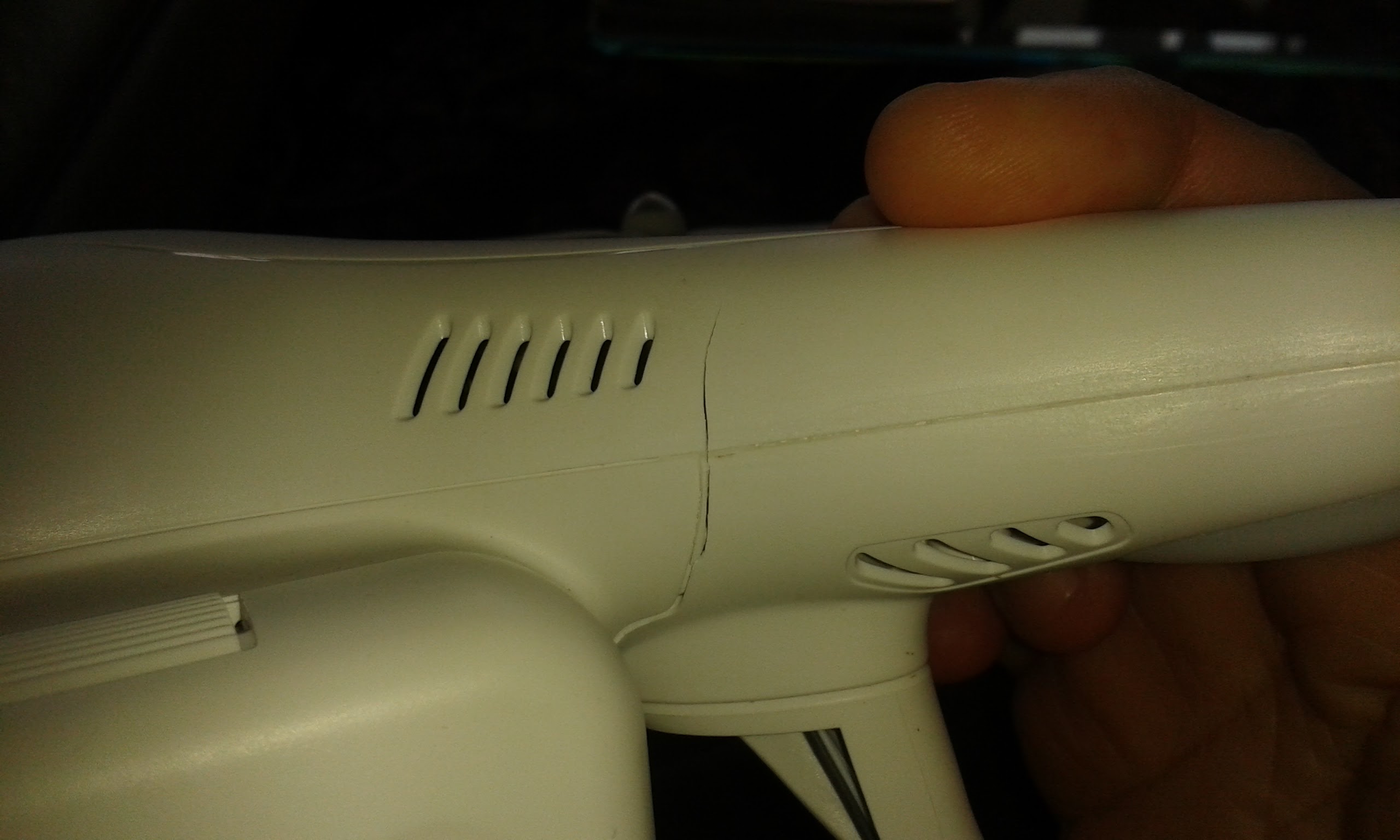

New stress crack location

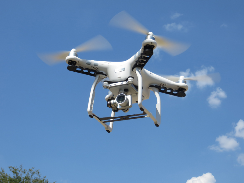

Thought about a lower shell in carbon fiber, but the expense would be high, so I designed a subframe. I've been flying with it this week to try it out. It makes the Phantom's arms rock solid! No twisting at all.

Looks interesting!
Is the subframe CF? What does it weigh and what impact is there on flight times?
The subframe is made from a carbon fiber reinforced filament. The carbon fiber makes the material extremely stiff for its size. The entire subframe weighs 35g. I've made one without the carbon fiber reinforcement (in gold color) but it had to be thicker and slightly heavier.

Looks like even the Phantom1 have divisions between the shell parts. So to me it looks like this is not cracks, but just how the shell is put together. But for the threadstarter the crack goes parallell next to this divisions and also up in the upper shell.
yep this is the way the phantom is put together and not stress cracks

Just check my phantom 3 and same crack as you are, I just get my P3 from DJI new replacement about 2 weeks, and flight about 5 time, and that what I see it now.
I am going to ground my P3 for few days until I found solution.
Here is my 2 cents, If I flying again, then I will hold the P3 from the top, not at the landing gear,
even during calibration, and will easy manual landing, this will put less stress on the place that already crack.
Hope DJI come up with solution soon...
I just ordered your StrongArms, now looking at the SubFrame. Looks like the SubFrame would be the way to go, as it strengthens the arm. Have you noticed any affects on flight characteristics?

This one absolutely blows my mind. No, no crashes ever. No hard landings. Hand catch every time. I've never ever crashed a phantom which is why you won't see a thread from me looking for a gimbal in this or any forum. In fact I think DJI gimbal are more than up to the task strength wise. But the shells..... I tell ya. Anyway, photo needs no description. On a crash free phantom this is inexcusable. If I had sent my phantom in for warranty on all the stress cracks I've experienced I would have barely flown since June. After all, all four side by side screw holes cracked, two motor mounts, one front, one rear. I have a brand new in box phantom. I might start using it while retiring the old one. But this time I had enough. I might stop flying altogether. I'm tired of this. Whie DJI electronics are arguably the best, the quality and structural integrity are garbage. No better way to put it. And their attitude regarding this matter is the worst possible.View attachment 29685
