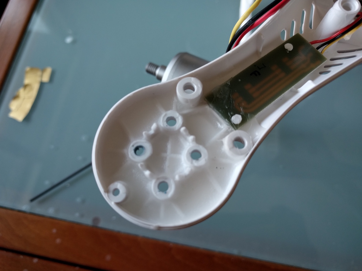

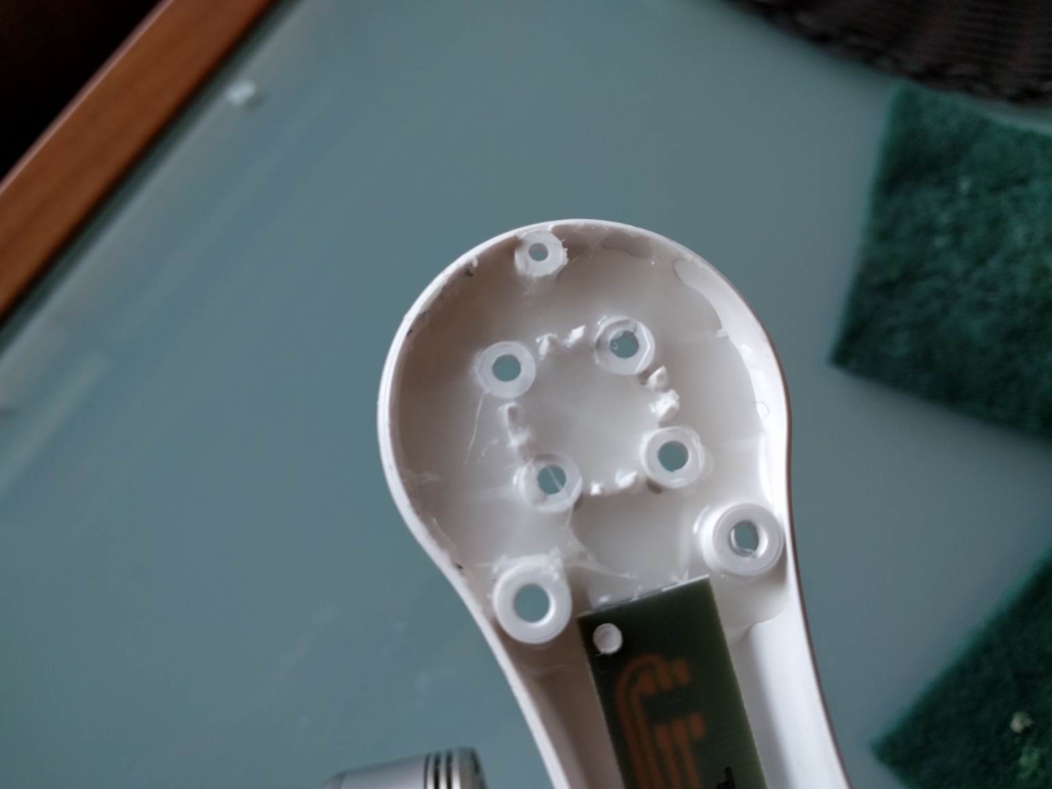

Hence I applied the plast aid solution that has been discussed here a few times. Now my motor mounts are flat and flush against the motor and I have all the extra re enforcement in the motor mount area around all the screws.
So far so good. I really think this might be the end of cracks, not that I had any to begin with. I really can't see the arm area cracking now because the motor mount area is almost half a cm think plate of hardened plast aid bonded to shell

This is definitely a step forward which DJI should have done it themselves. Still missing thing is that motors bases are not flat, you can't do much there.
Has this increased weight substantially?
Speaking of weight did you worry about equal amounts at each end....or does it matter?
Little weight difference doesn't matter as P3 will take care of it, what matters is the total additional weight, but I am sure its much less than the weight of prop guards so it may not matter at all. People use strong arm plates too and are very successful in flying.
The entire bottle of plastid powder is 112gms. I have not even used a quarter of that to do all four arms. So additional weight is negligible.
Infact now, my motor mounts are almost flat with the motors with almost no gap between the motor and the plastid base.so I think my motors are sitting very flush on a solid base.
