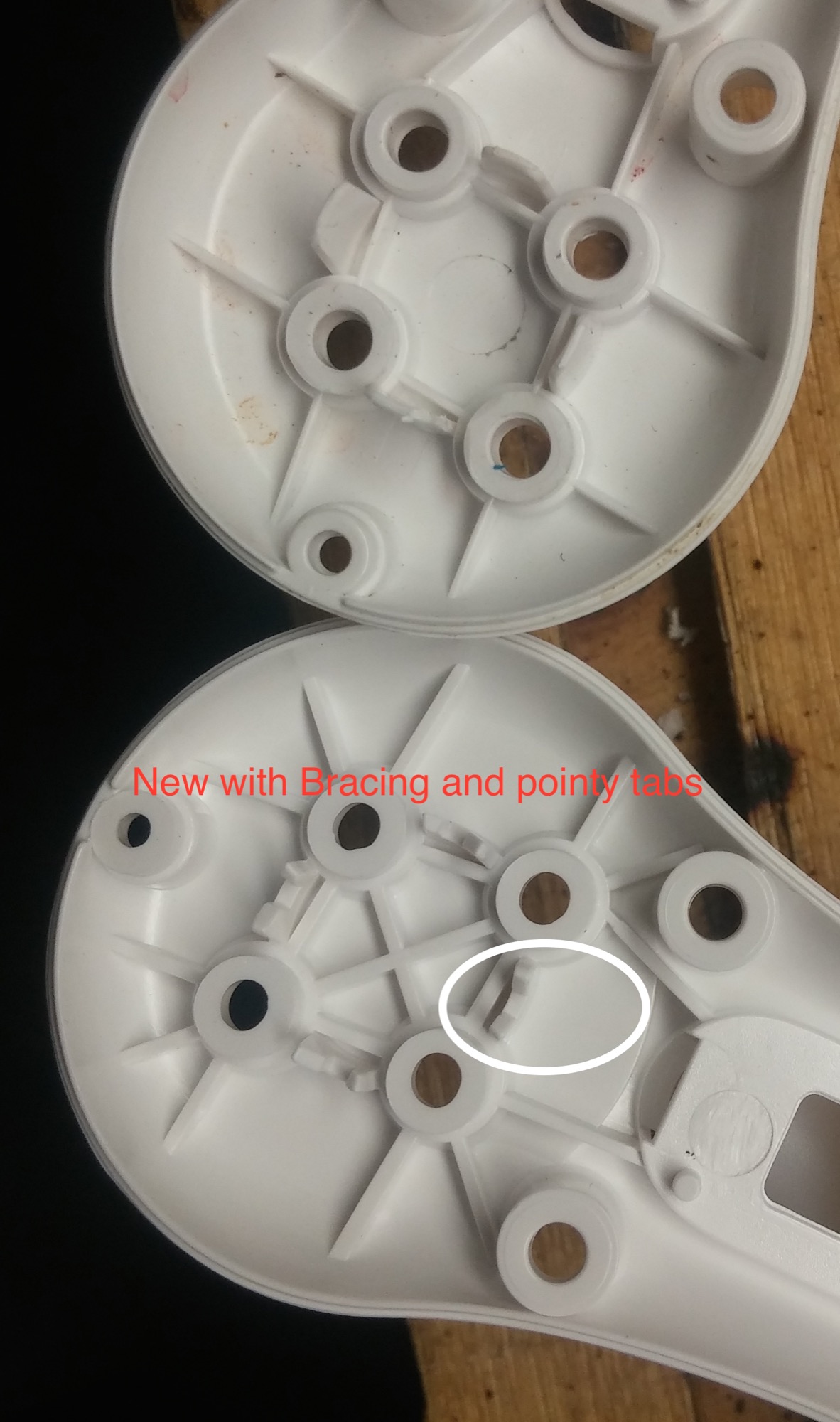

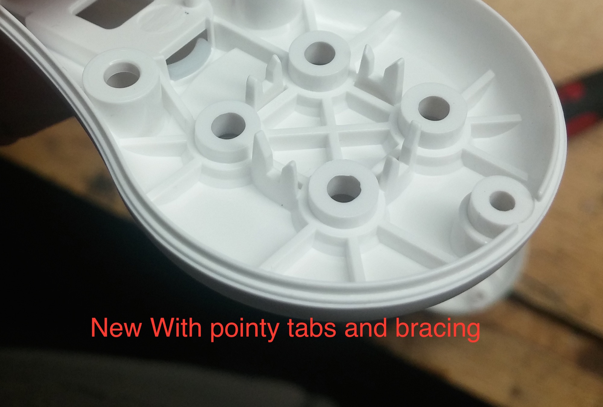

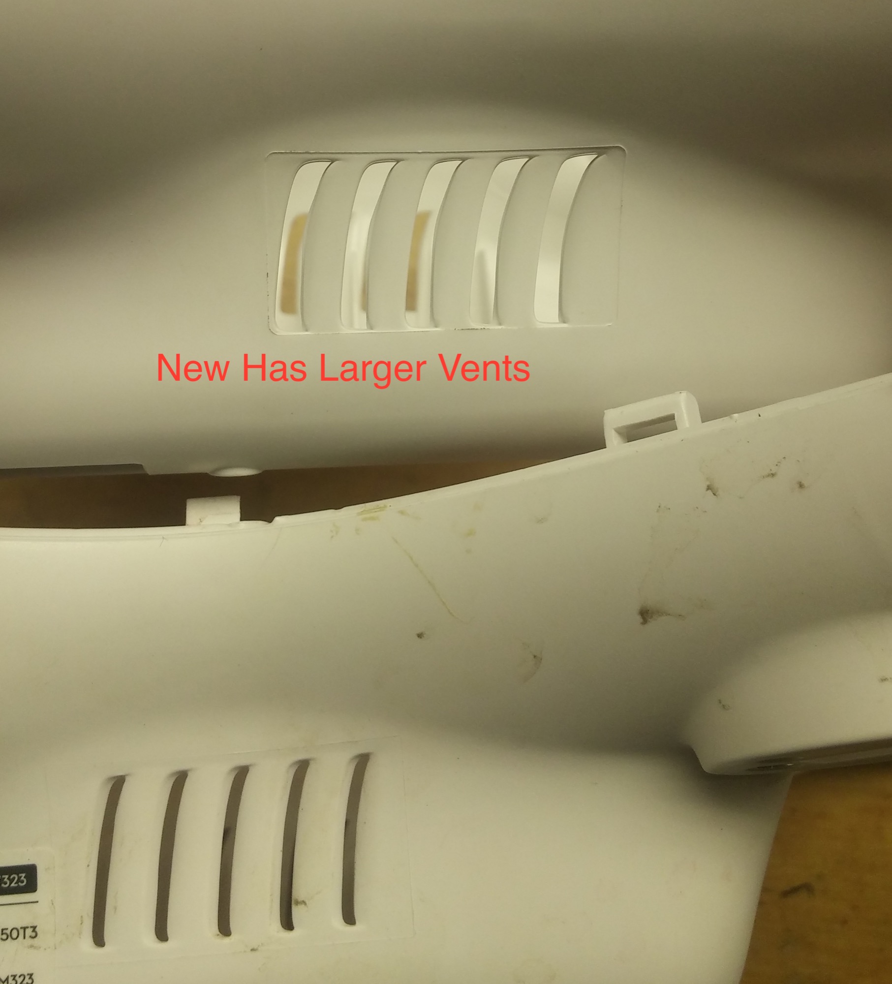

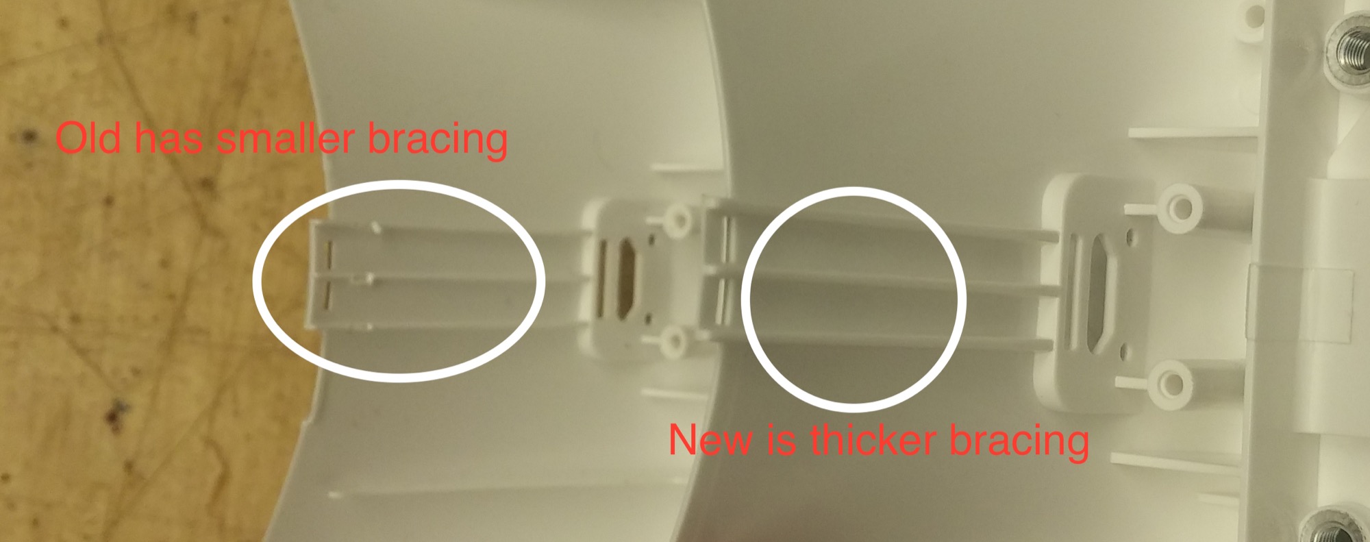

I took some pictures of the 2 different shells I have seen for P3A and P3P

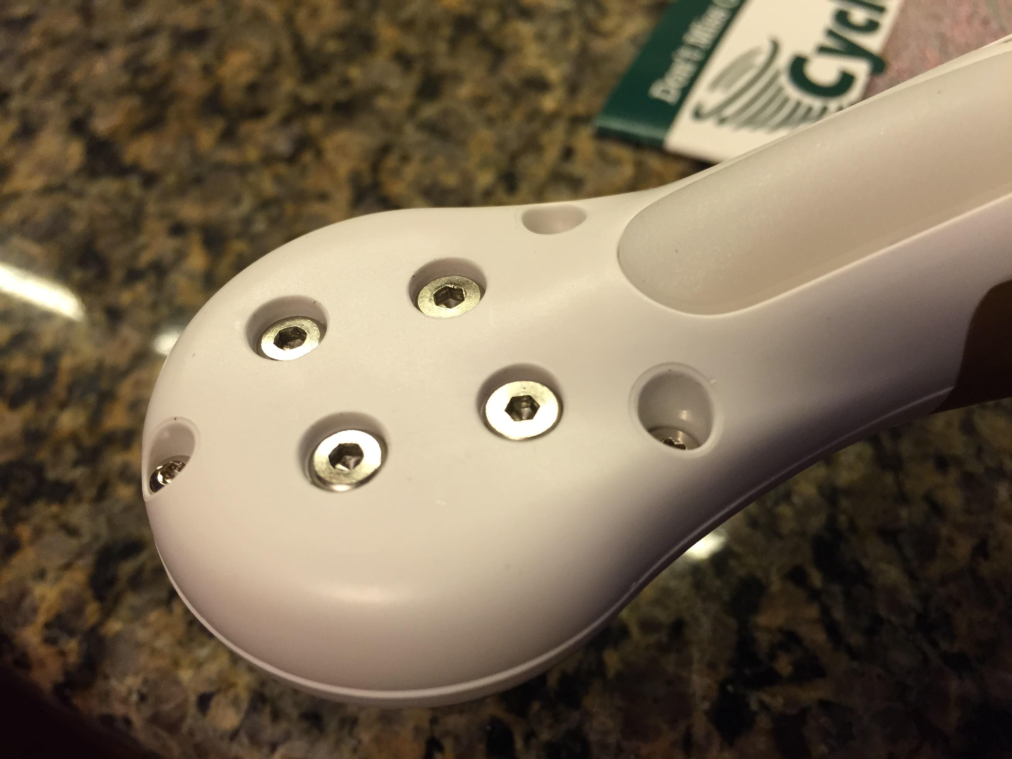

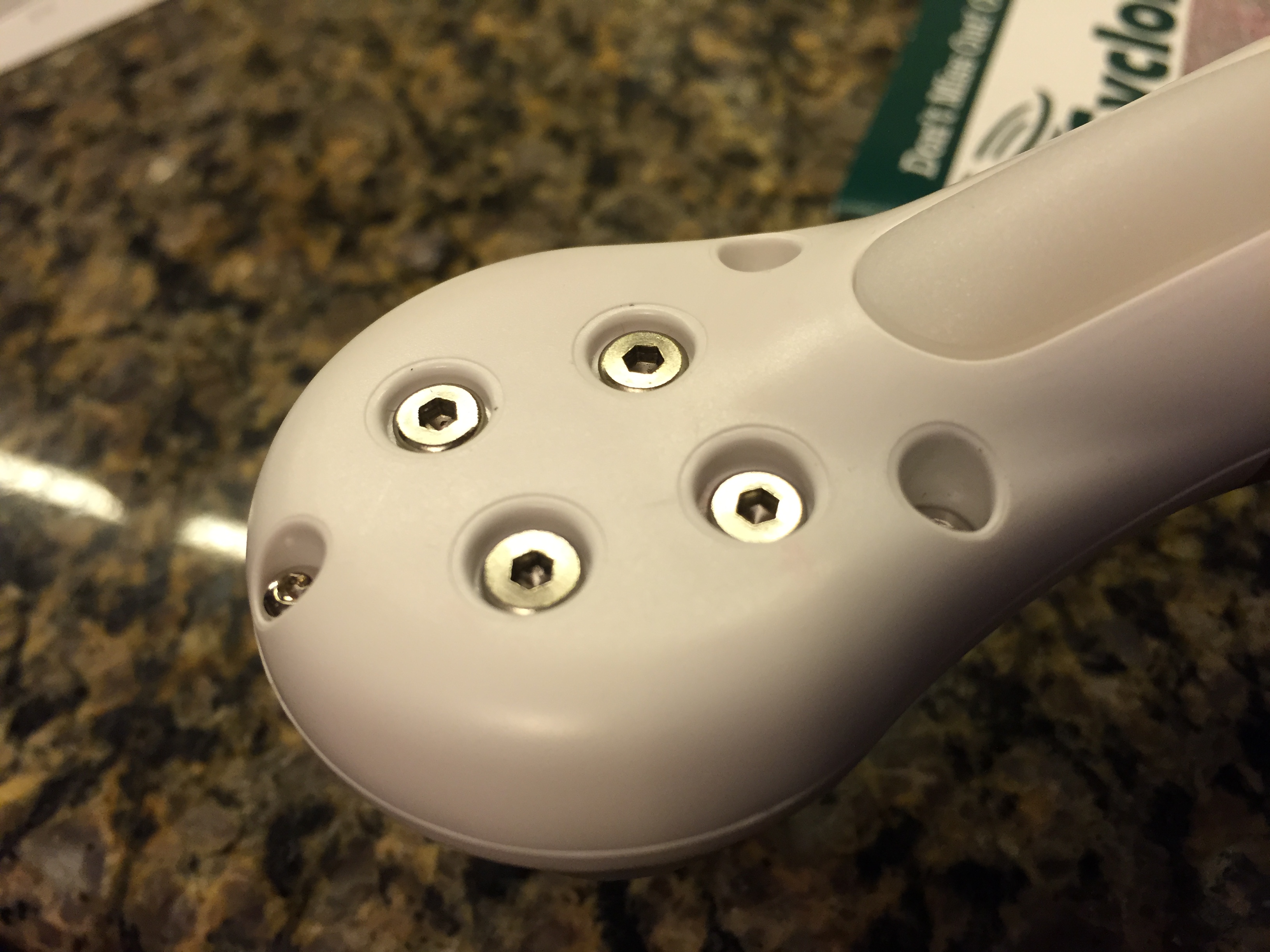

Could you show pictures of the motor screw holes from the bottom. I have noticed through looking at all the photos on this site of cracked holes that they look like image #1. I have never seen a pic of a crack on image #2. Just curious if the new shell design has these embossed radiuses on all the holes and on all the arms. Believe it or not these pics are from the same P3P with half embossed holes only on two arms which was strange! I never took it apart to see how it looked inside. It decided to take a swim so I don't have it anymore :( And my new drone has all holes like Image #1. :((
Image #1
Image #2

I will have to update the post again. Found a couple more older shells and there has been at least 3 iterations.
1st had small vents and sqaure holes where the legs meet,
2nd had larger vents and the little half circles cut out where the legs attach, but same bracing inside the arms, but had solid motor tabs
3rd has the larger vents, half circles at where the legs attach and pointy motor tabs with X bracing
Image #1
Image #2View attachment 32813
I have an 2nd gen shell with those halos on half the arms, the other half has no indents.
