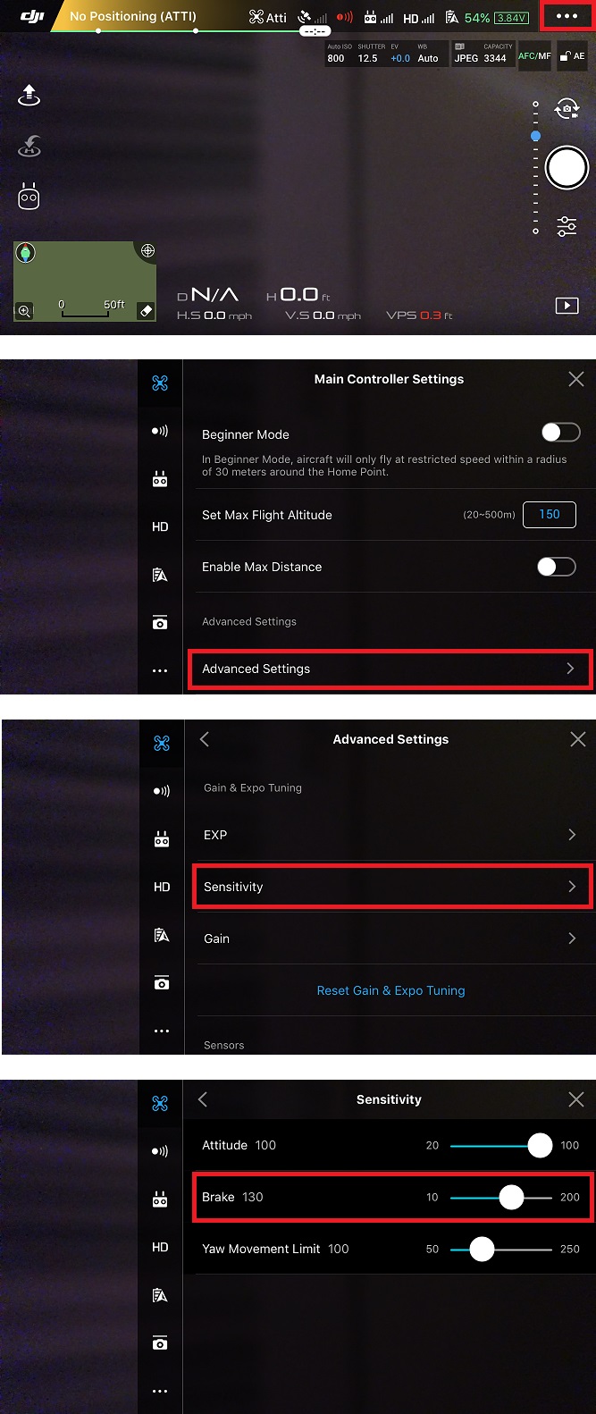

Maybe....but adjust your braking in the app.........Not sure why but the P4's for some reason have more issues than any other model....from what I have seen.
You can adjust the sensitivity of the brake in the following section of DJI GO:
Reactions: PhantomWetSuits
To be honest I never alter no settings I have found with the p4 if starts getting unsmooth on start stop I calibrate sticks again,you should be able to do a search and find what factory is set at,,if different then I would change but be ready to reverse in case stopping to slow especially around non open area,I would start at the sticks ;)

What brake settings are you all using?
I am using standard but I do notice it can throw the gimbal around a bit.
