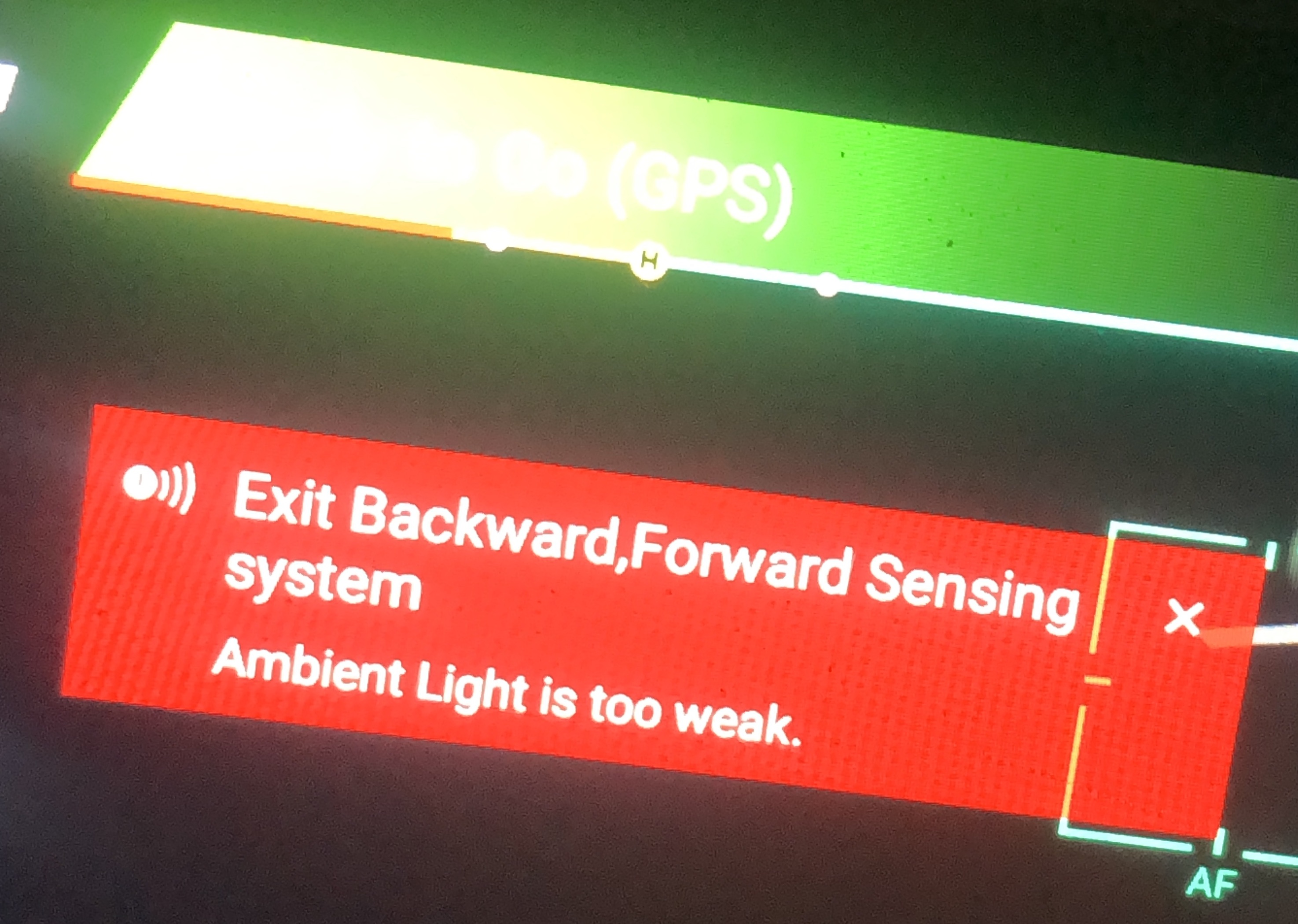

Last night I flew my Phantom 4 + and there was this message on screen that I had to cancel it to be able to fly . IMG_5451.JPG what is it?

what is it?
Double edge sword with those sensors. If the outdoor lighting is too weak they disable themselves. If the light is too strong, they tend to do odd things. ( I.E. Looking in to the sun )

Takes some getting used to, especially for me coming from a P3 standard to a P4P. Scared the poo outta me when it did that first time. I thought I'd just screwed the pooch. X out of it and fly the dang thing! Sensors are nice when they work, but I learned on a bird without all that fancy stuff... Fly with caution, but fly! Nothing to be alarmed about.

Thanks for warning
I was lucky that I didn't hit anyone and anything,
it was too dark and I was sure that sensors will avoid hitting anything

Best not to rely on the sensors too much. I hear stories, and they ain't all good! Haven't figured out how to disable them completely, but soon as I do, I'll be happier! They make me a nervous wreck when the rc starts buzzing in my hands!!!

You could try disabling obstacle avoidance in the app settings:
Then click on Advanced Vision Settings there to switch off the downward facing sensors:
Sweet! Thanks! That'll make me feel a lil better. I like to do my own flying!
