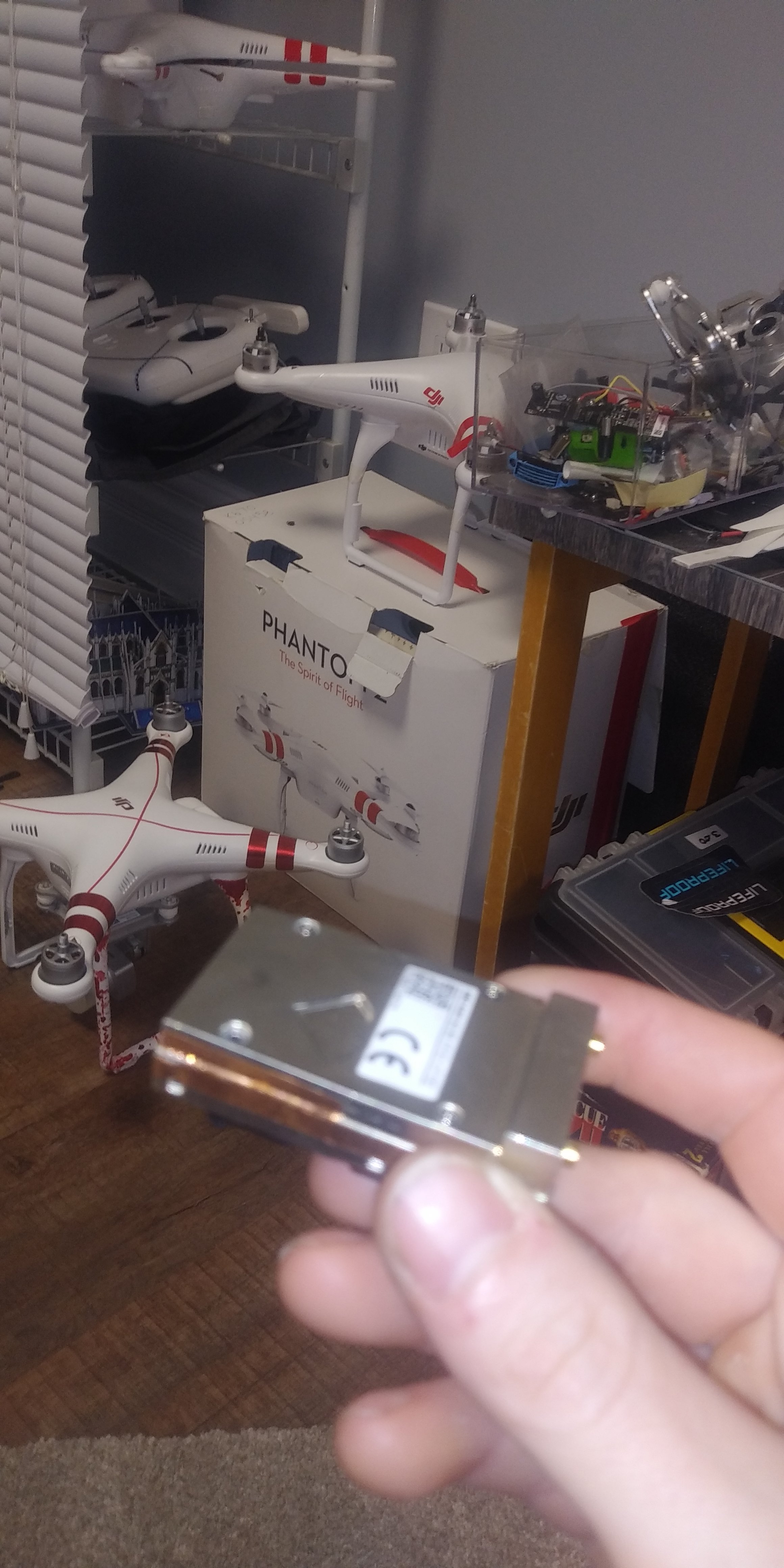

Where are you located I have a Wi-Fi mod box from a Phantom 2 vision plus that is not in use and I know for sure is working. This might not be your problem but when I had my Phantom vision connected to iPhone I never got the first person view even though it says iPhone 7 is optimized for the app when I did it with an Android phone that wasn't even on their list.... go figure it worked....I'm not saying switch to Android I'm just saying maybe find someone who has one borrow it for 5 minutes and check it out because you never know. Cheers
May 24, 2019
14
32
Here is a picture... however like you said I'm not sure if it would work with that Phantom or not I'm in the process of trying to find out myself for a friend if it doesn't I apologize

A P2V+ wifi box does not go into a P2V. Been into mine way to much but has been way back and is in this section if you search. I will when I have a spare moment .
