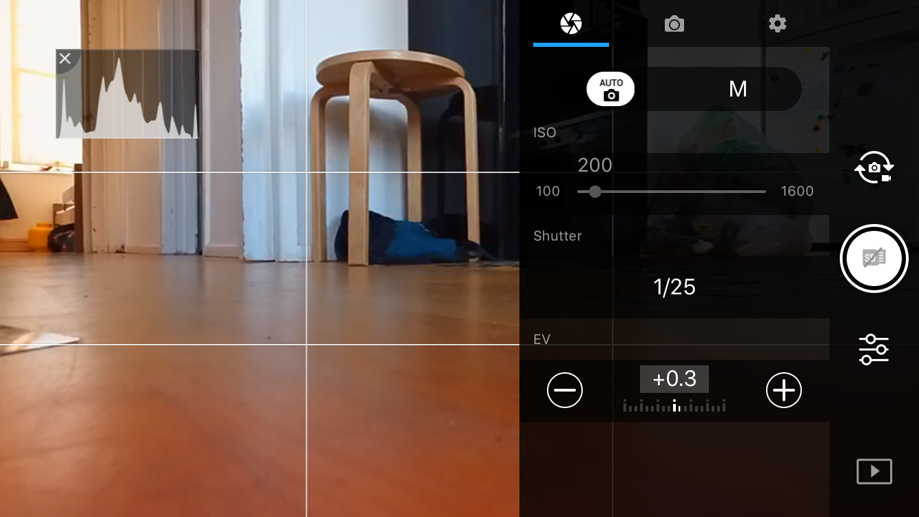

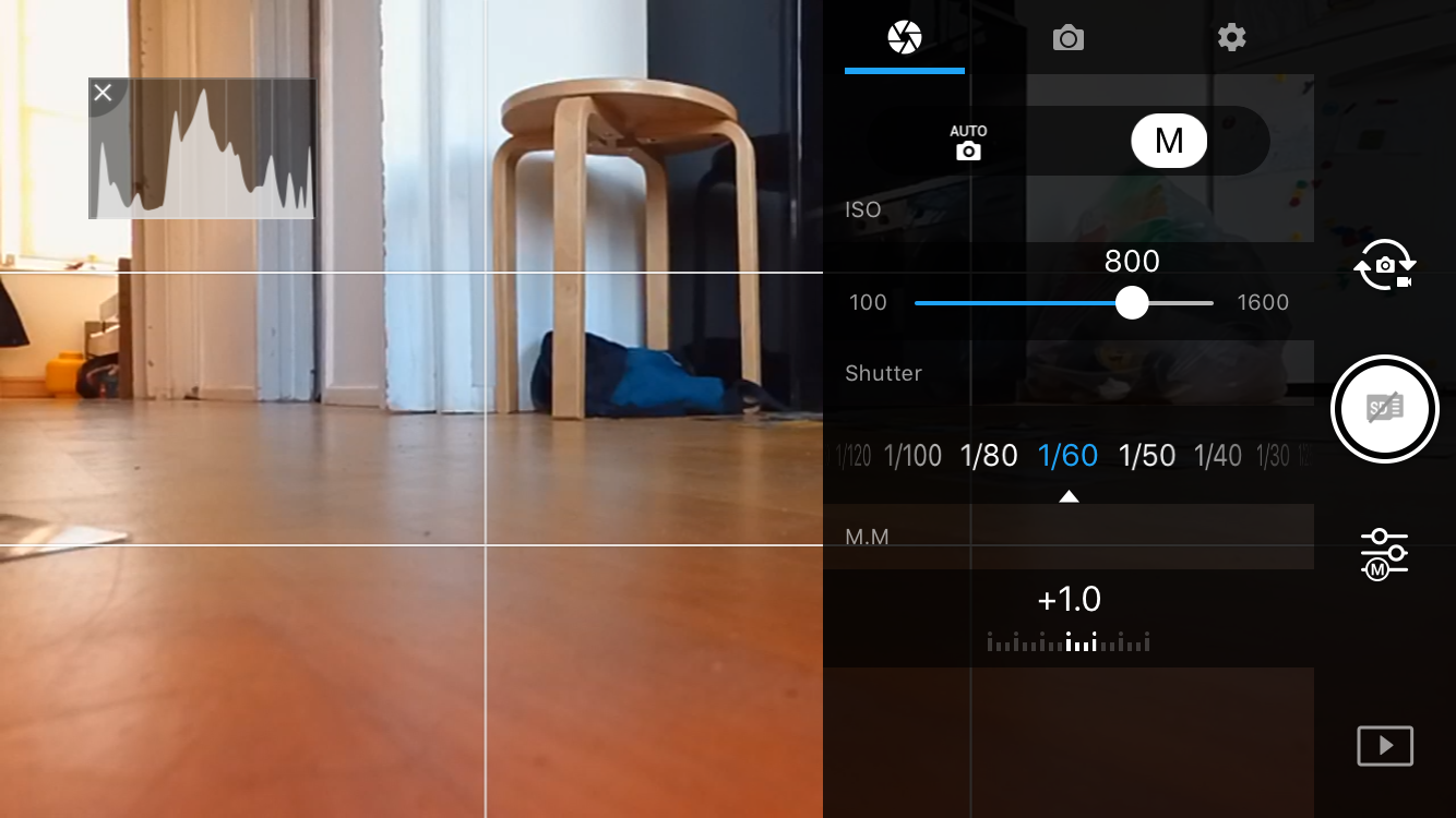

I changed my camera settings for(please see attached pictures)and hope I will be able to fly this afternoon. I'm not sure about those settings.

Remember video and camera stills have different settings. I shoot videos in auto and adjust the ev as needed. Videos need a slight blur to make them look right. That’s why camera shutter is twice the frame speed rate. Use neutral density filter’s as needed. They are a must for good video. Stay away from any d log settings unless you are good at editing. There are many ways to do things. Some people like to lock the light settings when doing videos. Your call.
In doing stills I usually use auto and again adjust ev. It’s a balance in keeping the frame speed up and keeping the iso as low as possible that’s where ev helps. I always shoot in raw and take stills with the light meter on the brightest spot. That way adjustments can be made in the raw editing.
