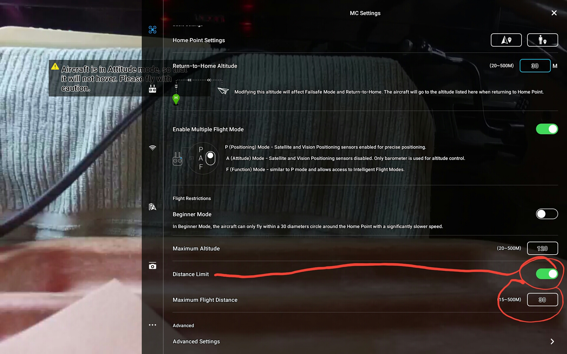

30m sounds like sign in to app might be needed,,that gives a 30 50 restriction,,,beginner mode off or losing signal at that range

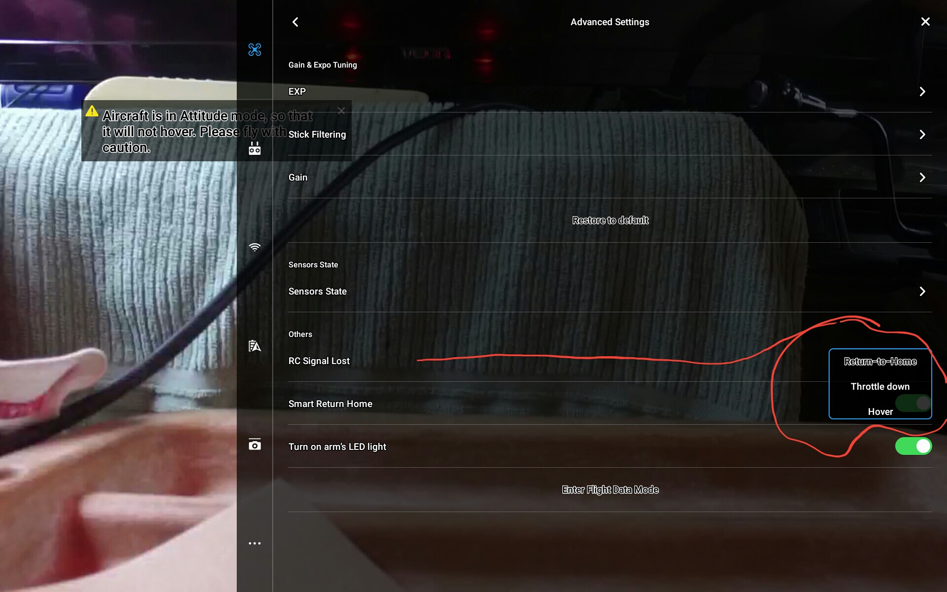

I post this anyway or check these settings ,,,I just tryed with distance limit on and factory settings is 30 so check if that on or off...sounds just like you discribe,I'm not sure install cause this or you would have very bad transmission issues
