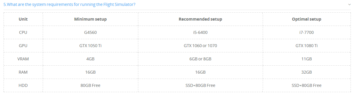

How did it run for you? It didn't run too well on my computer after 10 minutes or so flying in the flight simulator. Everything was moving super slow in the application (and on my computer since the process was maxing out the GPU).
Same for me (gtx 750 ti), even at low settings I was getting some lag, hopefully they get it optimized.
Seems to work well if you have adequate hardware (and yes, the requirements are high.) I have an i7 / 32 GB RAM / GTX 1070 (purchased for editing) and it runs smoothly. The UI is a little rough here and there (typical DJI) but OK once you get used to it and the simulator itself is very good. All in all it's great for a first effort. No simulator is exactly like the real thing but it's pretty close, or at least I think a newbie who had some time with the simulator software would have a much better chance of avoiding accidents on their first real flights. Takeoffs and landings are a little too easy (no real feel there) but I only have a few flights on it and maybe it's in an 'easy' mode. You can set all kinds of detailed flight condition (wind, etc.) so there is probably a way to turn up the difficulty, haven't played with that part yet.

Works great on my laptop. I'm amazed at the smoothness of the frame rate and with the amazing graphics. I have an I7-6700HQ Quad Core with 32GB or RAM and Geforce 1070.

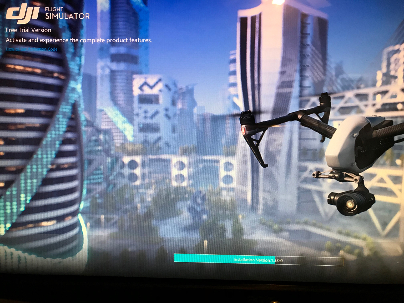

I was able to install the initial software. After that I'm stuck in a screen with an Install blue button. When I press it the gives me an error.
I tried it in 3 computers, always the same. What am I missing?

Change the directory. For some reason it always tries to install to a D drive.
Installation issue solved, I just had to launch the app with administrator rights.

Seems to work well if you have adequate hardware (and yes, the requirements are high.) I have an i7-6700 CPU / 32 GB RAM / GTX 1070 (purchased for editing) and it runs smoothly.
Well, works fine on my desktop (as above), but just tried it on a fairly modern/common laptop config (i7-4510 CPU, 8 GB RAM) and no go, even when lowered to 'medium' quality and 720p it's just too laggy to be useful. The DJI FS package is nice (and free) but does require a lot of CPU/RAM and a mid-to-high end graphics card to be usable.
