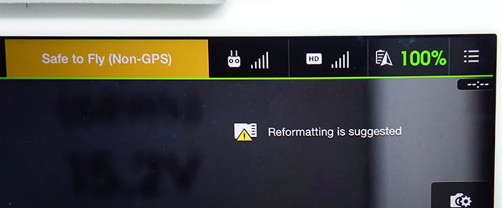

All updated, everything looks good except this. Reformatted the card twice, still the same. Any ideas?
Did you format it in the quad via the RC or externally through card reader and PC? I know that cameras can be fussy how cards are formatted, maybe the P3 is as well. If you did it one way, why not try the other - just in cases.
Thought of that but I can't find in the app, (IOS), where to do that. I went to setting/advanced settings/ format data recorder but that is not it as it don't touch the card.
OK, found it, in the camera settings/more area. It's all good now. Going to try it out later when it cools down a little
