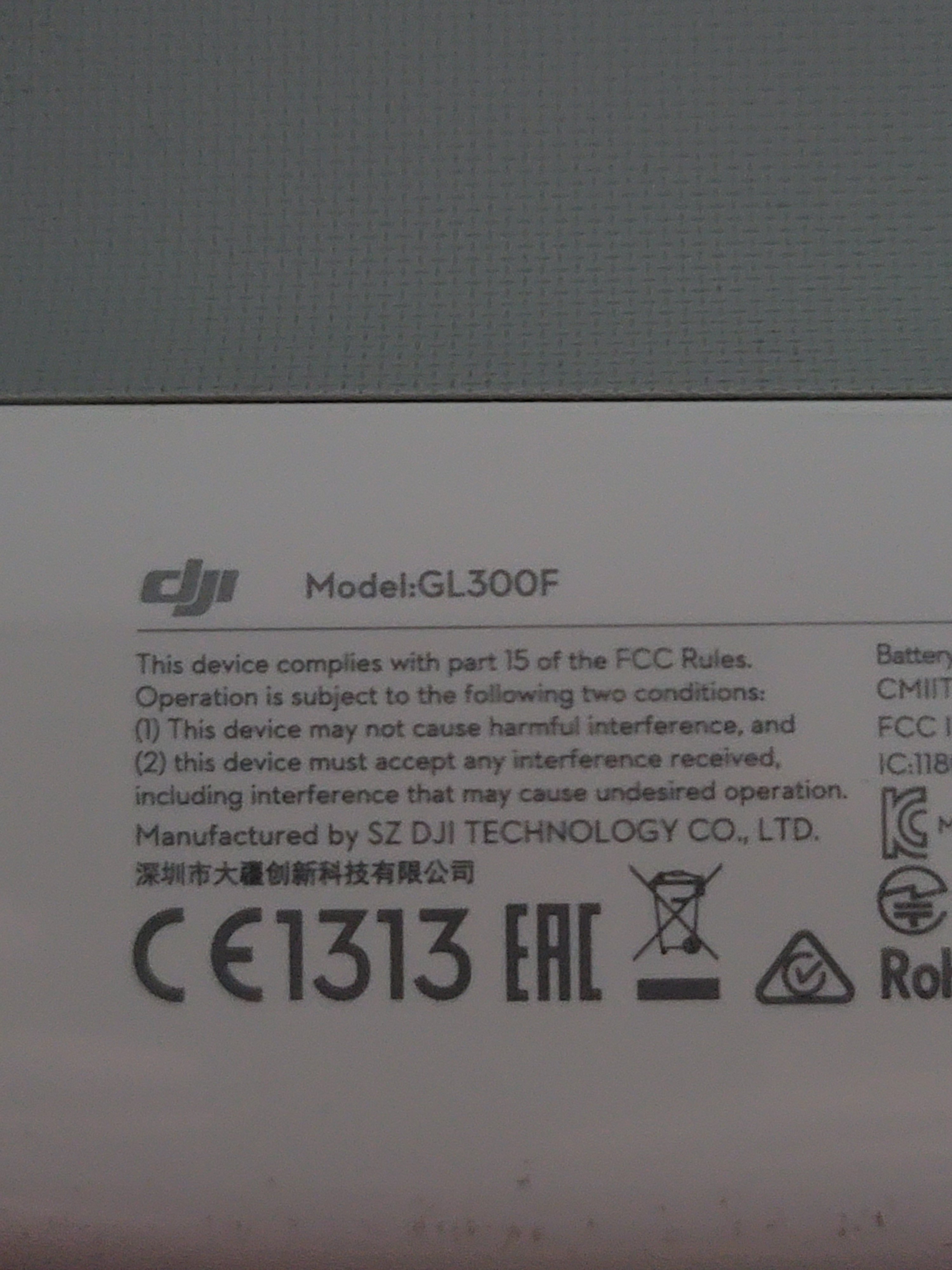

How strange. I followed the exact sequence of connections shown in your video every time, and after turning on my P4P controller, the words "Enter Device" at the bottom right of the DJI Go 4 screen on my Mini 6 never turns blue. I tried two different USB-C cables and one Thunderbolt cable, and always no joy! My controller is a GL300F. Which is yours?Here ya go...

GL300F works with P4PV1. I used all types of USB-C cables and the Syntec USB-A to USB-C adaptor. It never worked for me with the USB-C of iPad. It has however worked for some. I finally switched to P4P V2 on which I never had problem connecting to USB-C iPads.Question:
