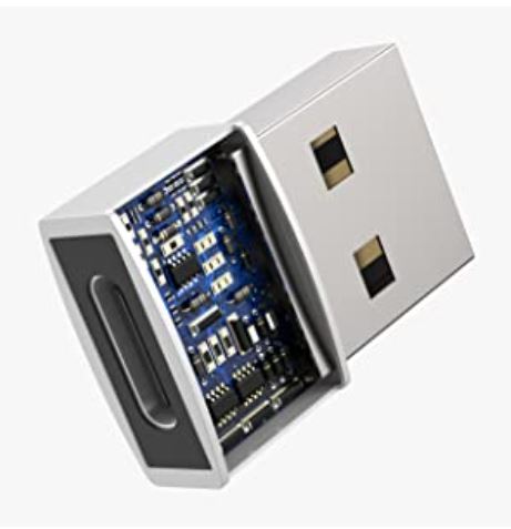

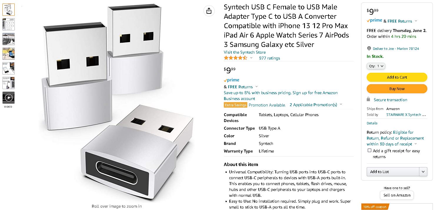

I have ordered mine and is scheduled to be delivered on 10 June. From what I think, if the interface firmware is on the adaptor, it should work.

That would be helpful. I just got this part this afternoon - no good with my Phantom 3 Pro. I'll get my P4P back in a couple of days and I'll report back how it works with that.
