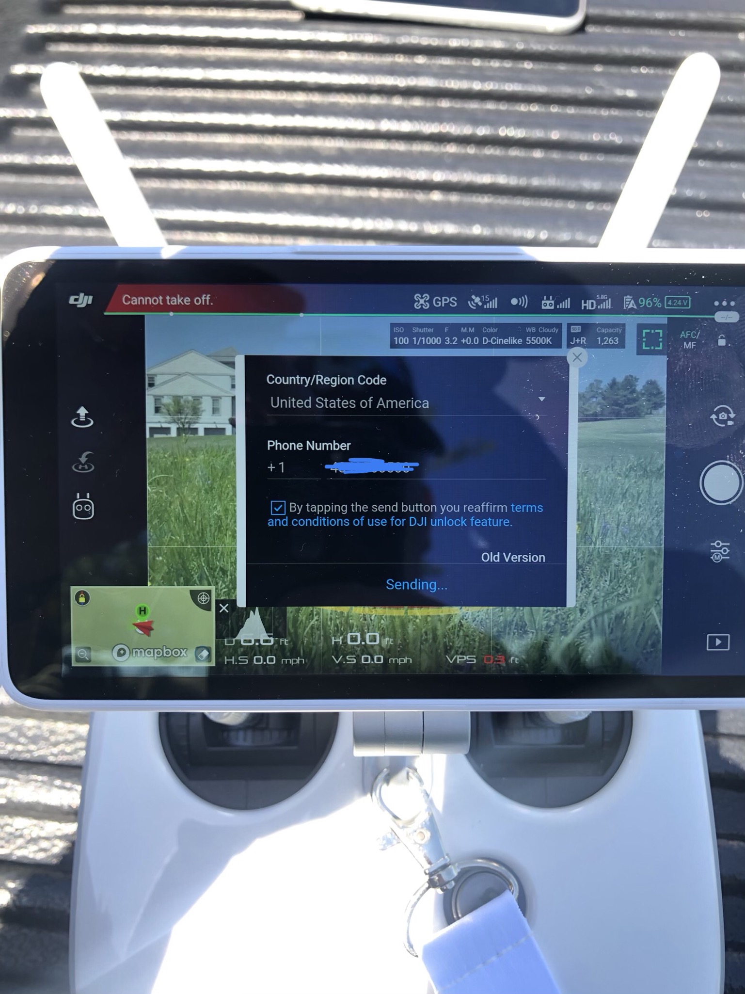

The “done” or “next box is lower on screen I believe so you have to scroll... after pic below, DJI texted me a code which I had to input into remote. Then I had to go through some more steps and check like 4 boxes

I appreciate the tips. I did try the whole process several times (backing all the way out and starting over each time) and I did check all of those tiny boxes each time. At this point I'm fairly certain it wasn't operator error. I got a message back from DJI that they will contact me soon. Meanwhile I might try an online chat with them now that it's business hours. Super frustrating.

Problem solved. It took updating my nofly zone list, updating DJI Go 4, then deleting DJI Go 4 and then reinstalling DJI Go 4. Then the manual unlocking worked as promised. Whew! Thanks for all of the suggestions from the forum and DJI tech support as well. For what it's worth, the custom unlocking ended up working as well with DJI responding in an hour or so to that request.
