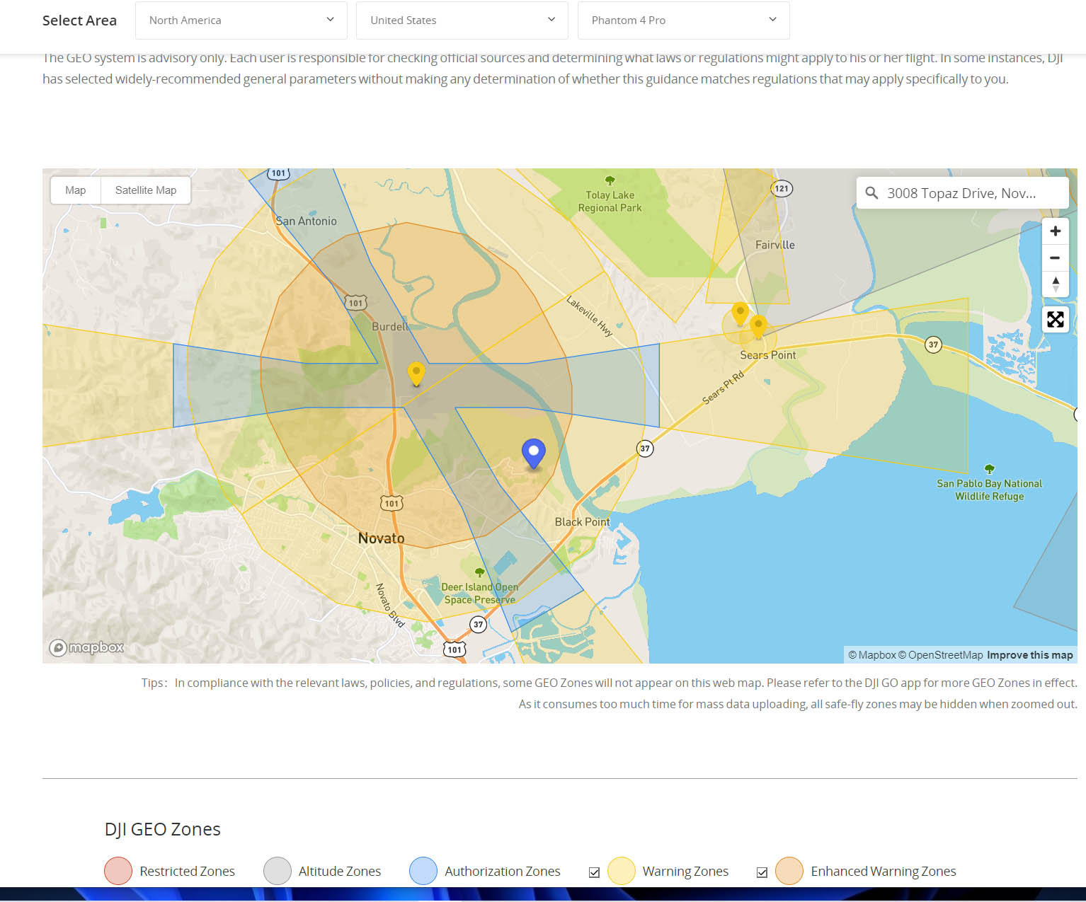

Hi again, Everyone:
I am STILL having problems with this.
The other day I tried flying from in front of 3008 Topaz Dr, Novato, CA 94945
It is close to Gnoss Airfield, which again is a class G airfied. But where I was flying is listed by DJI as an Enhanced Warning Zone:
Here is what it looks like in the Geo Zone Fly Map
At the time I launched, the DJI GO 4 App asked me of I wanted to get authorization to fly there. I tried to get Authoriziation through the app, but after I enter the verification code, the stupid keyboard covers up the submit button and I can't get the keyboard to move out of the way. I tried three times and finally I just hit cancel. Oddly enough, it allowed me to fly even WITHOUT getting authorization.
But the other issue to me is how do I get authorization IN ADVANCE??? There isn't any where on that DJI Geo Zones Page that would allow me to unlick it in advance (there used to be this feature, but now there isn't).
EDIT: Are they all done by logging in to the DJI FlySafe website instead now??? I just discovered that separate URL / Website.
And does this work for an Enhanced Warning Zone, too??? If I use the DJI FlySafe to unlock Gnoss Airfield, will I still have to use the DJI Go App for the enhanced warning zone, too???

Hi Mark,sorry your still having problems, the dji site can be a pain. 1st if it is an enhanced warning zone it should (in theory) only require that you check the box in the app saying you are allowed to fly there. does not require a code or internet to work. I say in theory, because once and a while they are a little off, and an authorization code is needed. In reality there system is supposed to only require the code if you are in an authorization zone, which are the blue areas on their map - that will require both a code and an internet concection to load the code from you app to the drone, which you can do in advance form a computer, so that you don't have the keyboard issue on your phone..
This is the site, Fly Safe - DJI log into your dji account, top right side, I believe at the bottom of the page is a button that say unlock zone, it will have you add your device, & contoller number, click next for a searchable map, when you get to Novato, click on the blue area on the map, and then below the map it will ask for flight date and time, I recomend you unlock the blue area even if you are only flying near it, and especially if you are flying directly inline with it. Of course only fly where the LAANC sysem has given you permision, but unlocking there authorization zone helps insure you don't get stuck while in flight.
Now before you leave you need to go into your dji app and find where the authorization code is, and with your app, controller & drone on, you need to hit the button/slider that says to import the code into the aircraft. You must have an internet connection for this step, It can be done in advance, and I believe the code is actually good for a few days from the date you apply for.
Hope this is helpful, - not the simplest of setups.

Sorry for the delay, but thank you SO MUCH for the detailed explanation and tutorial.
I guess that leaves the SECOND problem for me. How to fly in an Enhanced Warning Zone (not an authorization zone) when I can't click the Submit (or verify) button after receiving the real time code from DJI because there app keeps showing the keyboard and wont let me click submit button.
(Also, what to do when in enhanced warning zone and I don't have cell service nor internet connection).

My understanding per the dji website, is that enhanced warning zone does not require connection. As for you phone keyboard covering up the check box, I don't know. There is probably some way to make the keyboard go way, which would be different on different phones, or maybe different versions of your operating system, I to have had that problem in various apps. I recommend that you google how to do that, for both your model phone, and maybe even you version of operating system, learn how and try it a few times specifically in your dji app until you are comfortable with it.

Thanks for the input. I guess I will have to google it. Just wanted to make sure there wasn't some sort of alternative way in the DJI Go4 app to do it.
