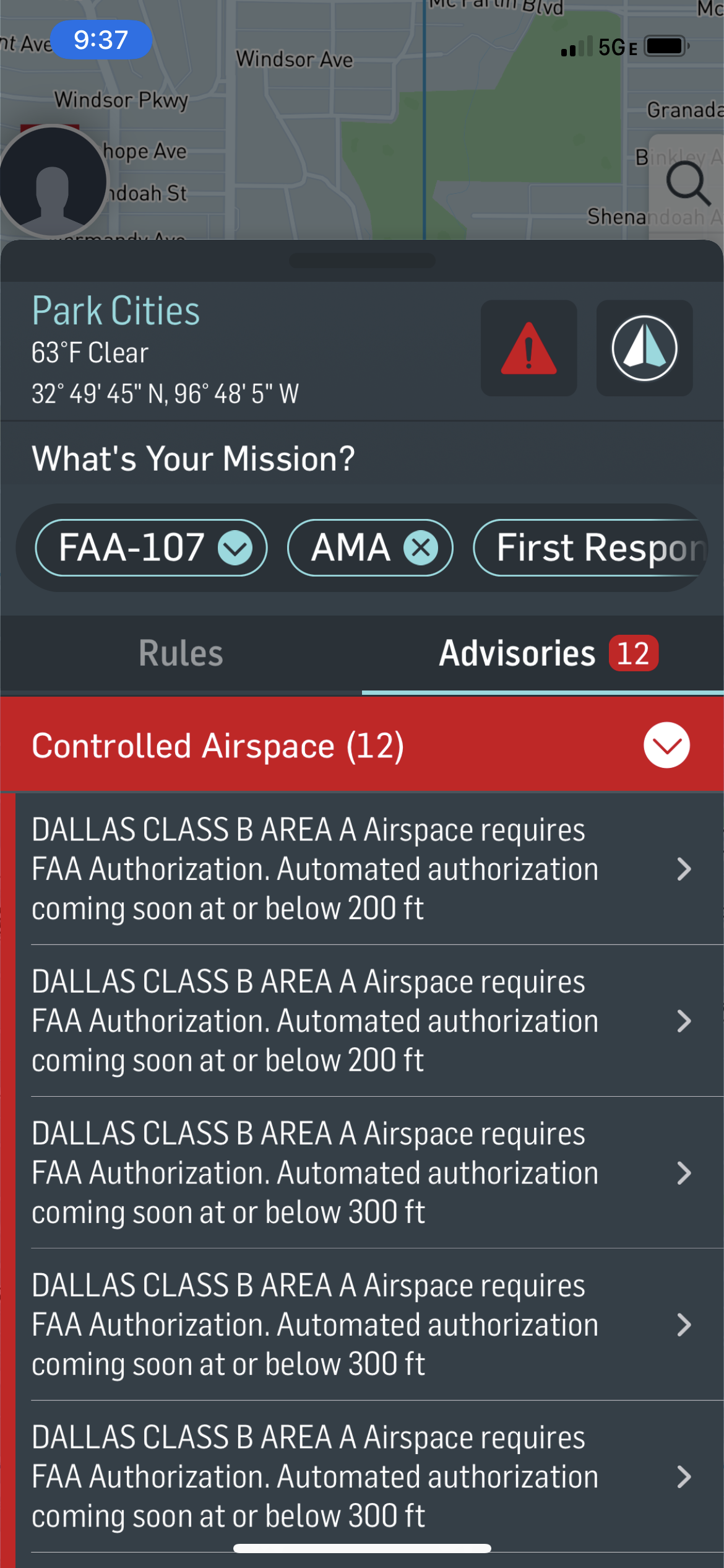

So, I just started a video project that will (hopefully) include documenting some construction over the next 18 months using my P4P. I would only need 100' of max altitude to do this. The site is just at the end/edge of an airport authorization zone. The controller gives me the standard message allowing self or custom unlocking methods but self unlocking errors out. When I check it out on Airmap it gives the attached information.
My two questions are 1. Is "Automated Authorization" really coming soon (as is says on Airmap)? and 2. If I have to contact the FAA does anyone have a proven method for this process? I am Part 107 licensed and will do what I need to for permission but one potential issue is the fact that I'll need to fly here once a month for the next year and a half so the process needs to be duplicatable and as painless as possible.

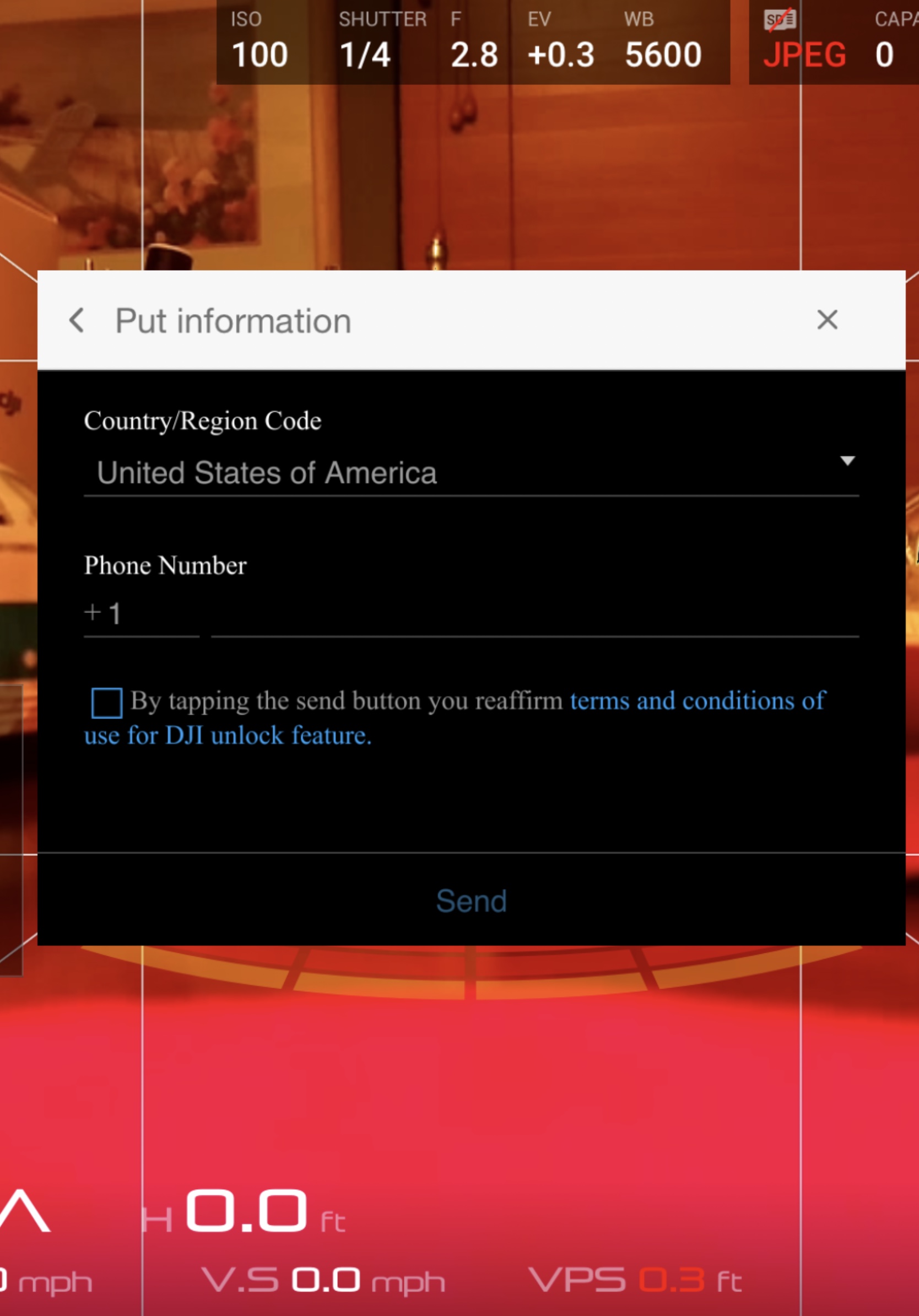

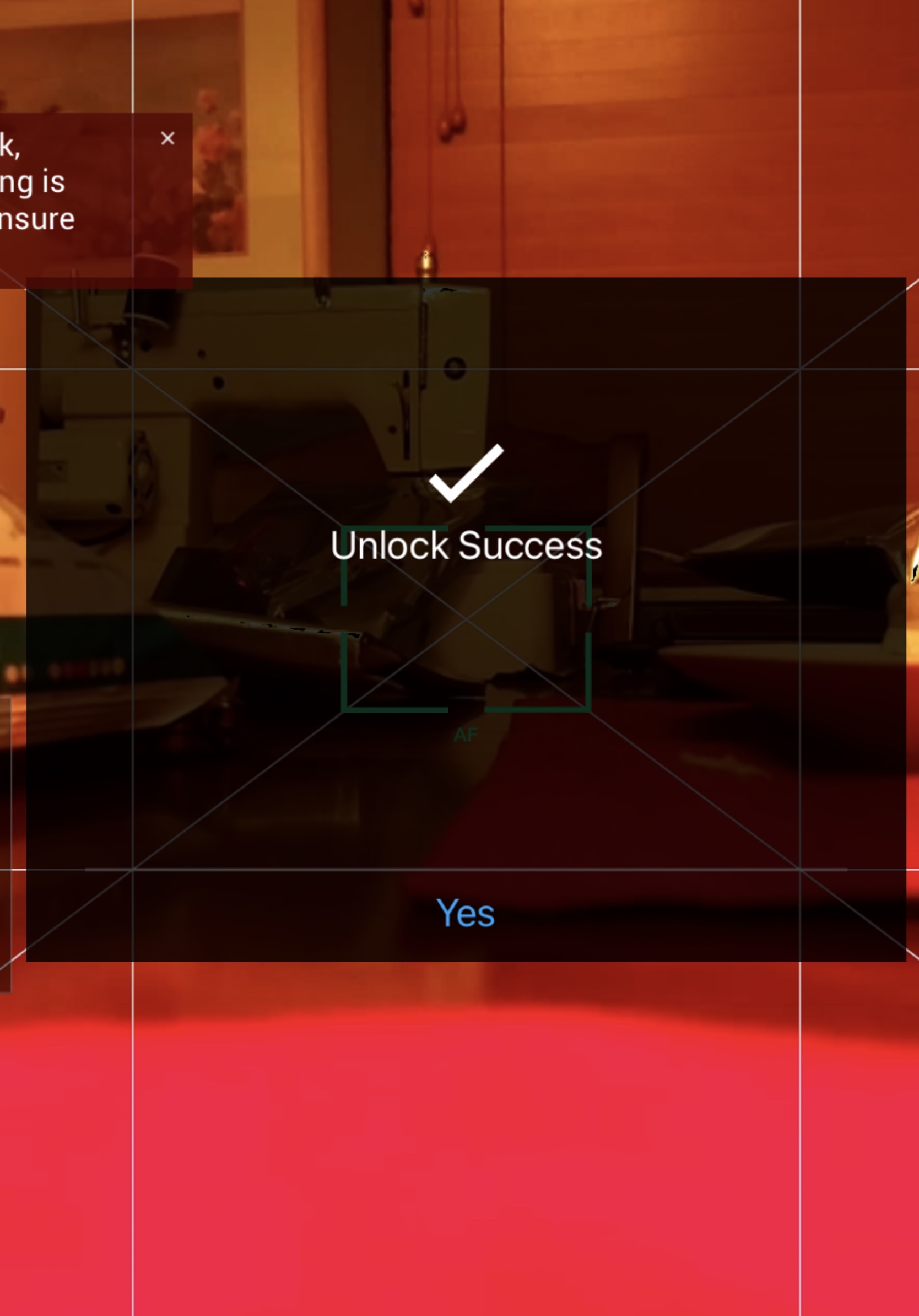

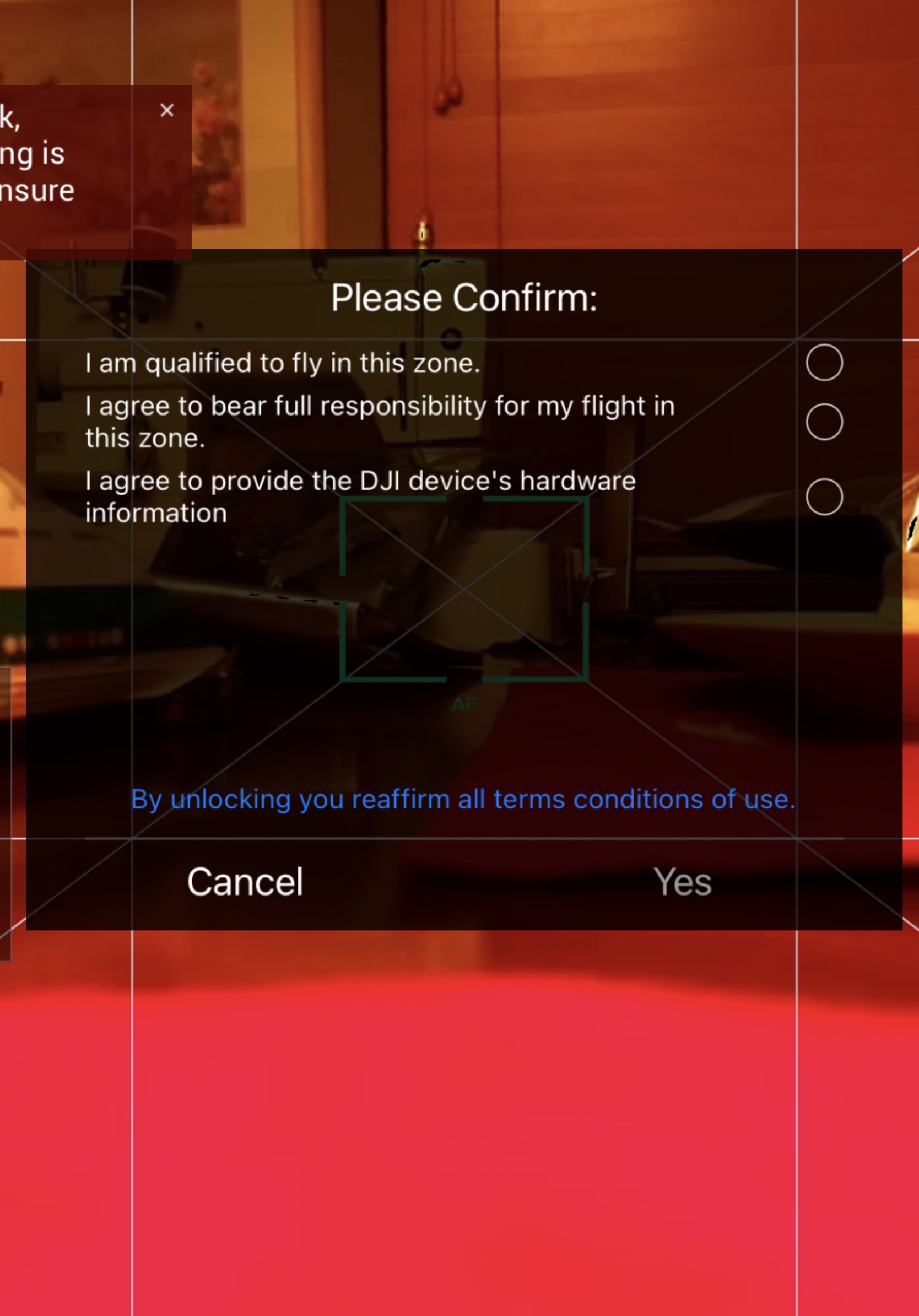

I had a similar Situation with two airports by my house. They said LAANC was coming soon but not fast enough for me. I applied for an air space authorization for both airports through the FAA Drone Zone and got approved within one day. The authorizations were for one year and before they expired one of the the airports was LAANC approved. I had to get an authorization for the other one.
As for the self unlock just enter your number and you’ll receive a code, enter code, then agree to the 3 conditions of use. I live in a class D airspace in a zero grid and I am able to start my drone. I don’t fly of course I only do this indoors when I drain down my batteries for maintenance. The unlock status will last you 3 days then you have to do it again.
