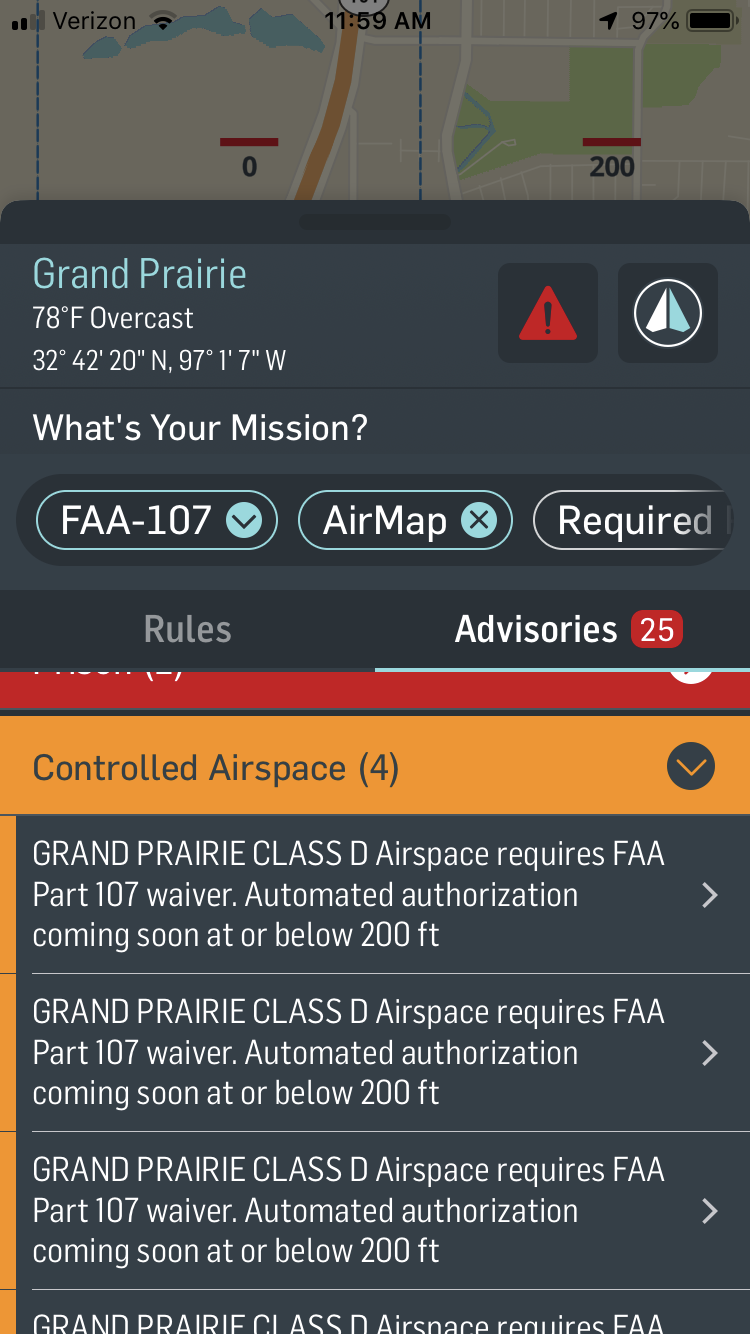

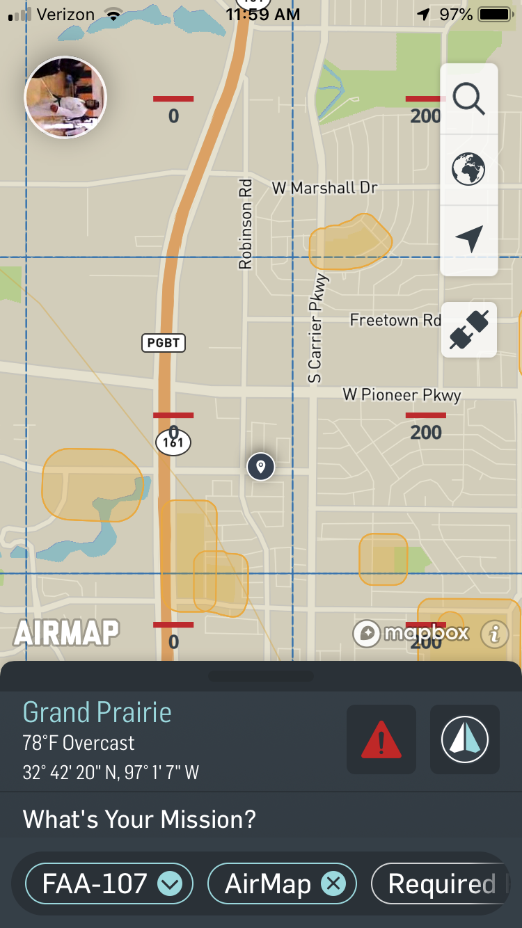

I do as above, I physically drive to location and use LAANC to get FAA approval on my cell. My phantom 4 pro plus then will ground me, I have to make my cell a hot spot and apply for unlock from DJI using WiFi on my P4P+. Sometimes all the little boxes you have to push to apply checkmarks are hard to see but after I self certify, the drone is clear to fly. I’ve never encountered a spot where I have to get manual authorization from FAA though. All mine have been authorized upon submission through LAANC..... but my point in responding to this thread is say the OP had manual authorization from the FAA/ ATC... DJI doesn’t know and should unlock the drone if you self certify. My LAANC says auto authorization coming soon for below 200’. The spot you want to fly is not at the 0’ it’s below 200’

Like I said above, after I get FAA PERMISSION, I apply in real time to get DJI UNLOCK. I’ve always been given the unlock. The OP needs to get manual authorization, then go to spot and turn drone on and press all the right buttons on the screen and he’ll get it. Edited to say make sure you have a cell or WiFi connection to your drone
Thats incorrect. Draw freehand around his site on LAANC. Its 0 feet. Waiver required. 200 feet authorization forthcoming is to the east of his site.
Well I inputted address, put my flight at 200’ and did everything except hit enter. You can see on my attached image I used the OP ‘s address and it marked a spot. I didn’t try and hit enter because it says manual authorization anyway. But, I bet I could still get my drone to unlock because it basically says all liability lies with the user not DJI. Of course I only apply to unlock after I get authorization from FAA. which in this case requires manually applying...
AirMap lets me do 400’ radius before I hit the 0’ mark.
