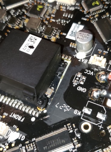

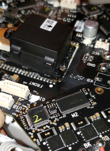

Hi Everyone
I m new in the group and i will appreciate your help.

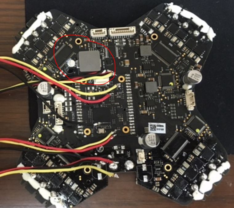

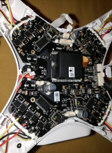

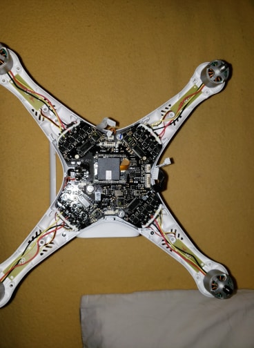

I Need an ESC mother board for my Drone but very confusing which model I have to buy.
Here is some pictures of mine and I need help to identify the reference of the motherboard I need. i found 3 models 2312A , 2312B, SE etc .....
Thanks a lot

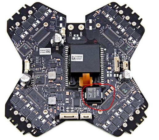

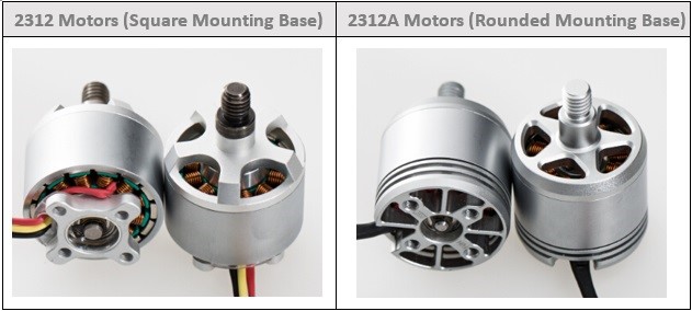

Looks like you have earlier models with 2312Motors not the 2312A

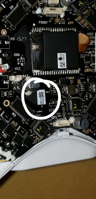

So i beleive i will take the older one... but some persons told me that when the number in the label ( see picture ) ends by A it means that I have to take the motherboard 2312A ... i beleive this is not true... this label has nothing to do with the the type of mothrboard i have to take..i want just to avoid any confusing since the price of the motherboard is expensive..thanks of all your recommandation
You are looking for DJI Part CP.PT.000219 which is has been discontinued. I needed one last May and had a devil of a time locating a trustworthy source. Search with specific description: DJI ESC Center Board and MC for Phantom 3 Professional and Advanced (Part 33).
MAKE CERTAIN the board you purchase is for a Phantom 3 Pro (not Phantom 3) and specifies for motors 2312 (not 2312A).
Finding the board is hard. Replacing it is easy.
Good luck!

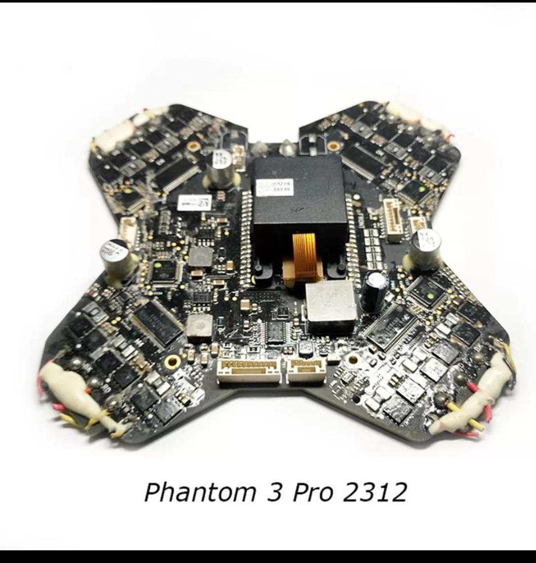

I found this one .. i beleive it s the right one.
Thanks again
Thanks a lot for your help.. really appreciated
Thanks again
Description is right. Obviously used. But if the seller has a good sales history with plenty of stars, I’d pull the trigger.
There is a seller on eBay that has NEW #33 motherboard for $169.00. I have bought 2 from them,very trustworthy. The name of the seller is rotor-logic and they are in California. My opinion, don’t trust used motherboards from China.
