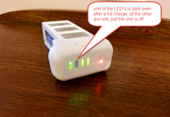

I also noticed that one of the Battery LED's is off. Could this perhaps be somehow linked to the compas calibration?
