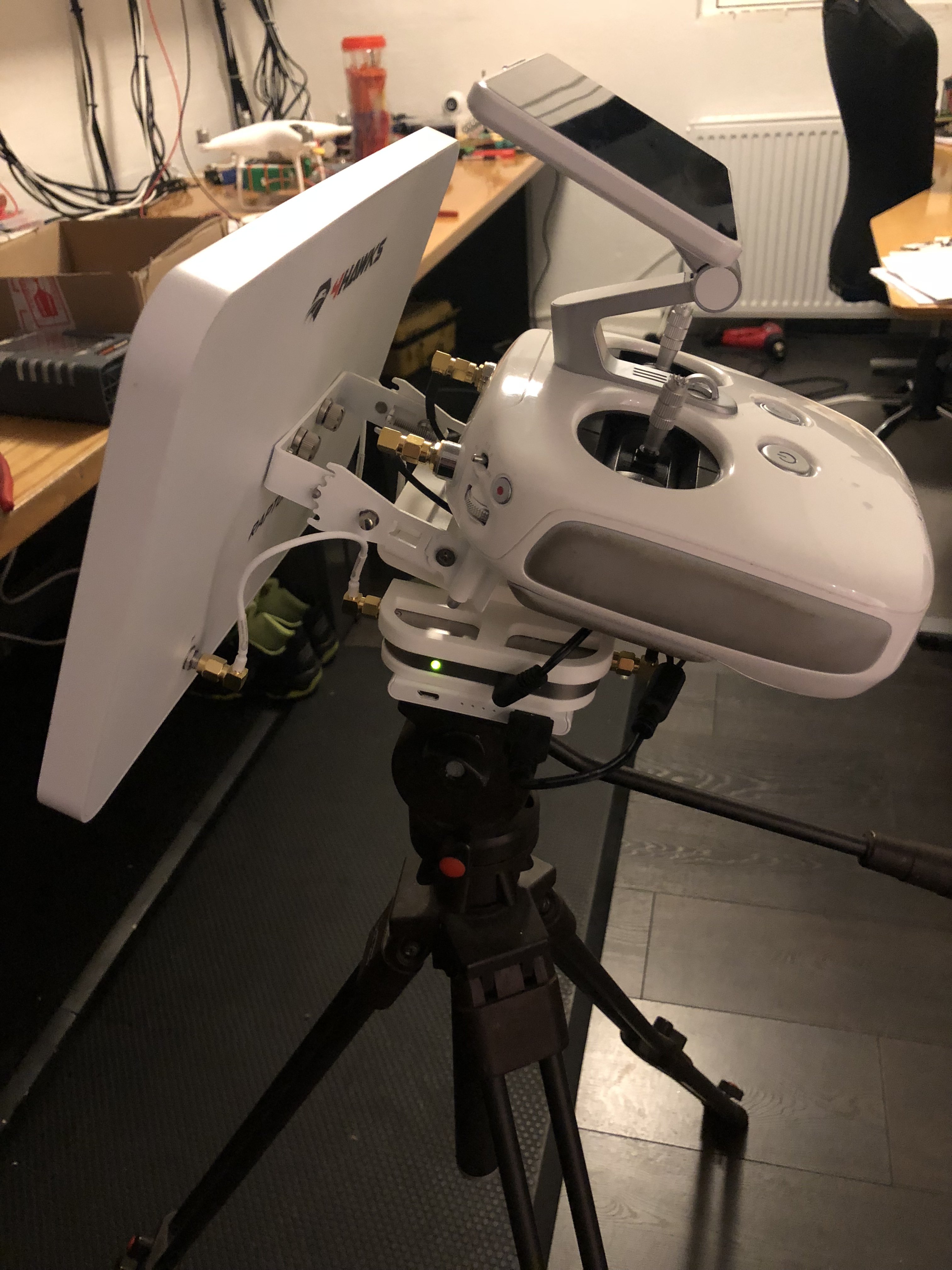

My goal is to fly long flights :) have this nice setup: (see picture) with standart battery, witch has aloved me to fly 5 km out and 5 back and a little around close by, so 13 km total 22 min. Had to stop because of battery.
Goal would be 8-10 km out with the battery mod :)

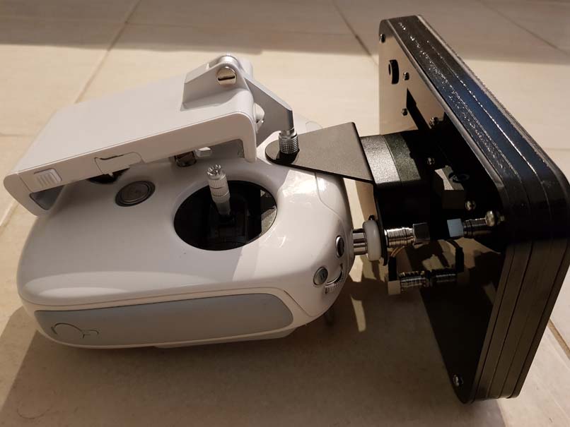

Like but think this is way better: with boosters from maxxuav.eu (they do a really good job)
The titan cyclone is amplified (2x 3w sunhans) and battery boosted, it's slightly neater set up than the 4hawks, with the T-mount I can swap the panel between my P4, P4P, Mavic and Spark controllers quickly and easily, that's why I went this way
Now that looks like an even better setup in that photo with the tripod mount - you have a nice n neat "Ground Station" of sorts. Looks great.
Good luck with your distance flights - that's not something I have ever gotten brave enough to do - will keep an eye out for your future flights.
