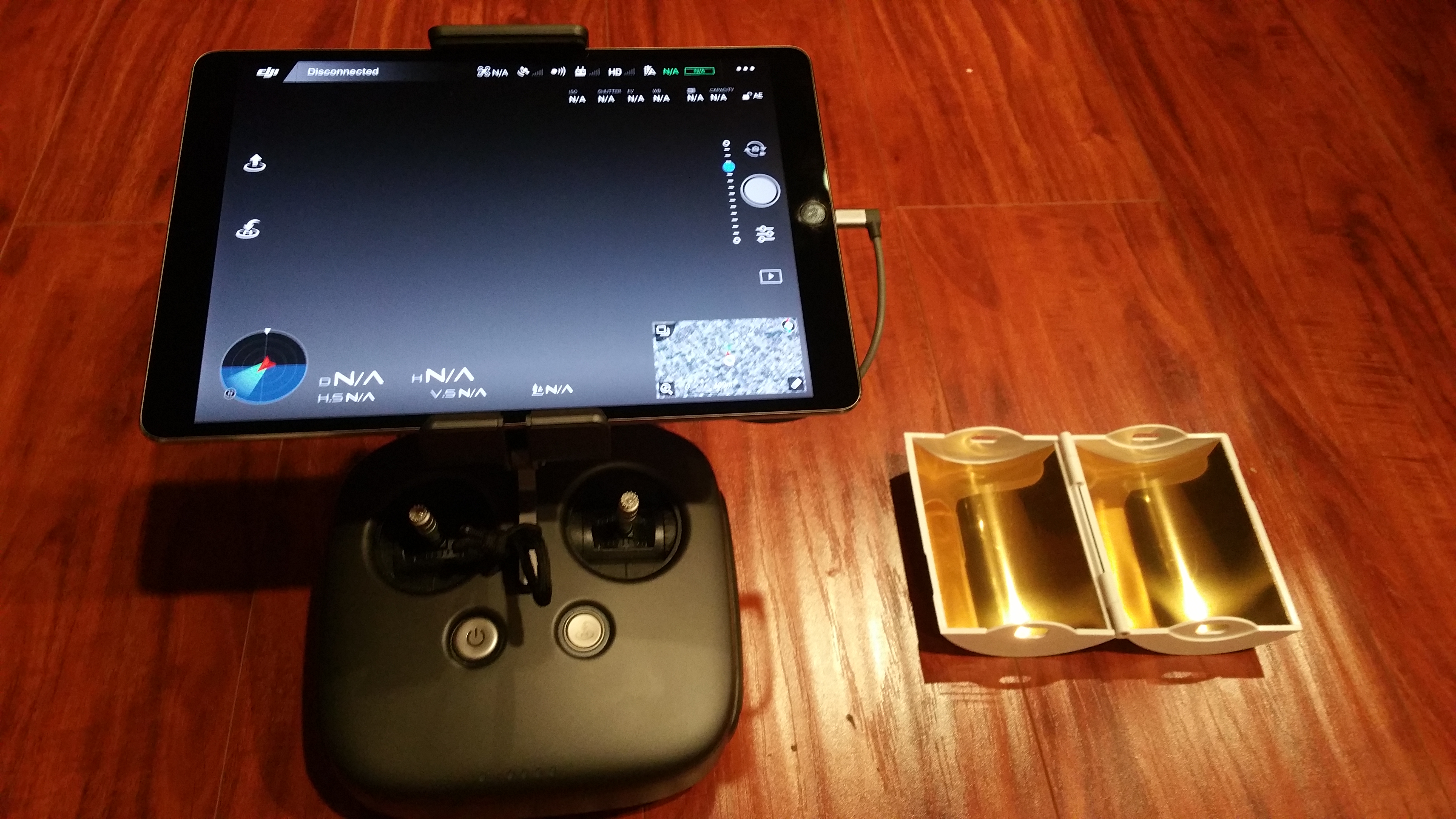

Almosy perfect. I can't find a black parabolic reflectors.
Ipad 10.5 with current OS 11 with latest DJI GO 4. I don't use Ipad exclusively for DJI GO app. I have 512 GB of storage and should be plenty to load and view video clips on the road. It has 4MB of ram so I dont have to keep clearing previous apps. I have not used the full brightness of the screen yet. It is currently set below 50%. I can read flight information with previous flights under the sun. In all fairness though I only glance at screen for flight information. I dont even know if I have live video feed problems. My video caches look OK though. I dont know how to fly it using my screen view yet. Old school from trying to learn to fly on helis. I will get a chance to fly it using the live video feed when I go abroad. Too many flight restrictions where I live. A few more accessories and this bird is ready for a trip! 20171205_061241.jpg
Haha.. thanks. I will try the reflectors first and if it works, Im sure the manufacturers will come out with a black version. They have black reflectors for the mavic. The reflectors only cost me 10 bucks. Besides, Im clumsy at painting.
The reflectors shown are simply ridiculous considering the wavelength of 2.4GHz EM wave is 12.5cm !!
Here is a Chinese-language youtube clip that demonstrates they are detrimental to RC signals beyond any doubts

Are you suggesting the reflector needs to be a wavelength behind the dipole? It doesn’t. The reflector is non resonant- this is why parabolic antenna systems can be operated over a wide frequency range by simply changing the driven element.
I am saying that effective reflectors need to have dimensions much larger than the wavelength.
I am afraid not. Look at the size of the satellite dish for 12-14 Ghz transmission.
What kinda "reflectors" you need to carry around with the DJI remote? :D
Yeah, but the 5" for the 2.4ghz certainly the reflector would be too small, but 5.8ghz is half the size, right? So, maybe 2.1" for full wave, seems like the mirror should work, would be interesting to do a test.:) I will try to do it, but I have never needed the mirrors honestly.
Maybe some who have had great success with windsurfers night post an image or two to support the “afraid so” reality.
The wavelength of visible light is somewhere around 500nm (I haven’t checked for a while but that’s close enough for the purpose of this discussion). The reflectors in car driving lights and flashlights seem to work remarkably well. That is the principal we are dealing with here. It is the shape of the reflector which is important, not the distance from the feed horn (your image) or dipole (phantom RC) that is critical to operation. Yes of course larger reflectors may provide higher gain/directivity.

Nice setup! You can always mask the reflector and spay paint the outside, some paint for plastics really work well, just clean with alcohol first. And Yes parabolic reflectors work! it's not a night and day situation but they do help as long as you keep aiming them at your craft.
Thanks. I will try it when I get a chance.
