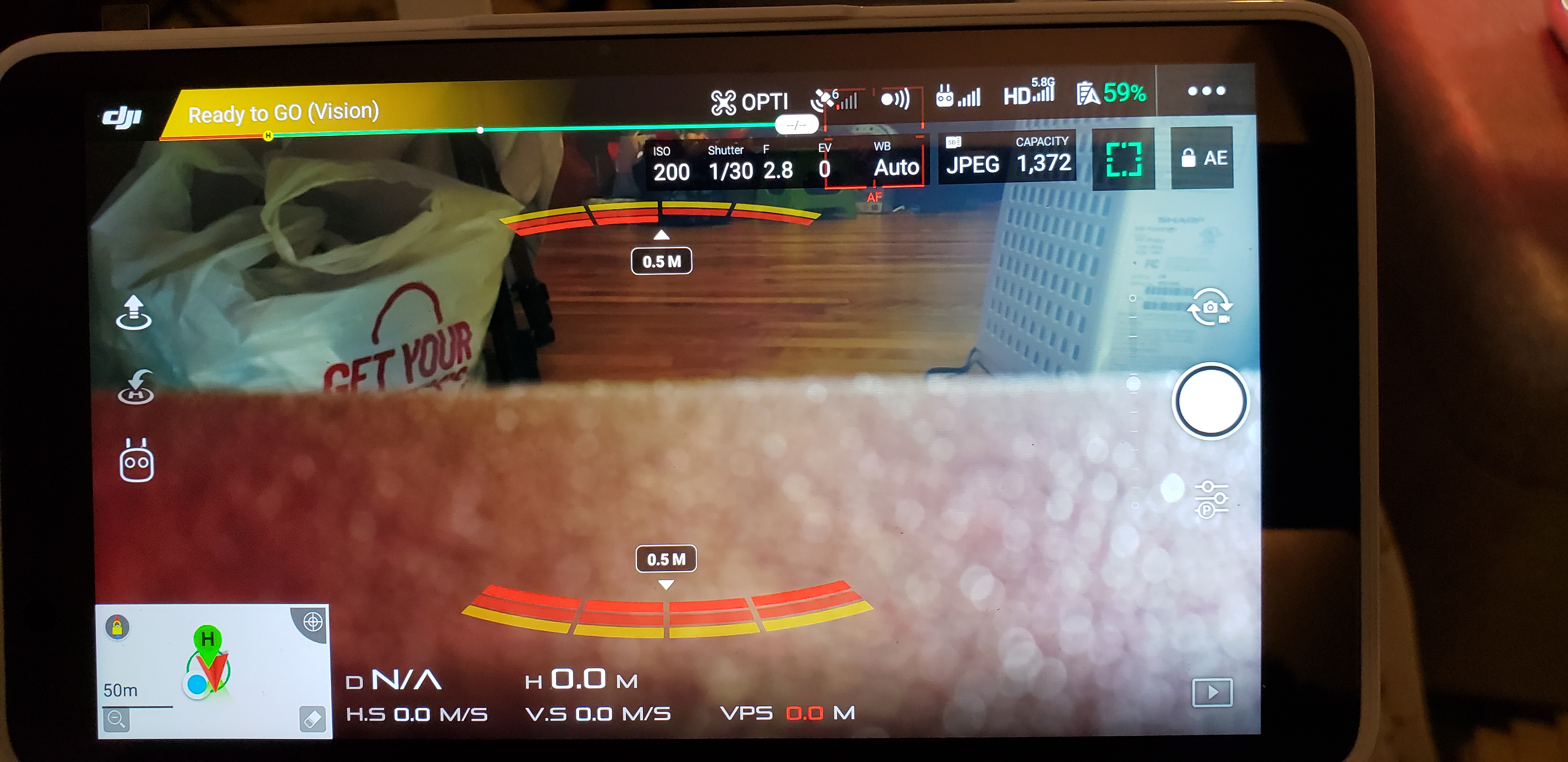

Ok another problem (its me I know) what does yellow mean where it says ready to go? Ok here is my story. I'm new. I only updated the firmware on the controller built in screen but not the drone because when I plugged it in it says I won't be able to fly no more than 30meters unless I'm connected to DJI server! So NO update the craft. I have only fly up and down in side my house because I'm afraid to crash my baby drone. I just bought it for $1100.00 (other said I'm lying) long story.Ha, ha, I remember when I got my P4, I yanked it out of the box, and after charging I ran outside to fly it; only to be stumped over trying to turn it on for about 15-minutes...LOL...

Thanks. It is still drifting. I updated both controller and the drone and it's still is drifting toward the right. When it drifts it doesn't seem to see what is flying to, the sensor system doesn't kick in and I have to manually steer the drone away. I calibrated based on DJI YouTube tutorial. Please help.Yellow means it is not in GPS mode. Probably because you are indoor and the reception is not good. It will turn to atti mode, which is not easy to fly. If you go outdoor, it should turn green to GPS mode and you are ready to fly.
I agree on what you said and thank you. As big as DJI I wish the booklets and manuals are through and full. All was included was a quick start guide. I'll be frank here, I can fly and my first drone was a Hubsan. DJI is not consistent and through with their softwares. I just found out few days ago I can't install 3rd party app for land mapping. There is a model for that but its 7grand same controller as the Plus. If they're giving us a builtin screen controller why can't they give us 3rd party like other Pro models? There are 2 usb ports one regular and 1 mini which is a head scratcher. The one and off procedure is ridiculously not written on the quickbstart guide or whatever you call it.I think it will drift if it’s in ATTI mode and there’s the slightest breath of wind. You’ll need to check which mode you’re in, and see the manual for instructions on how to change it.
