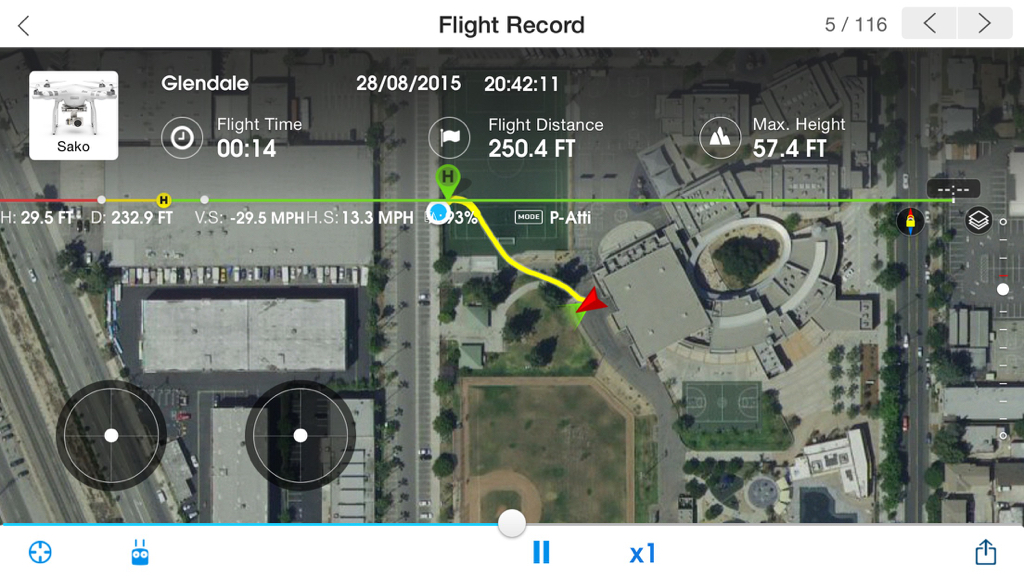

Here are some screenshots.

Weird that although you are in P-GPS mode, it keeps drifting despite that the right stick is centered @0:28 - @0:31 in the video.
Poor GPS signal? Heavy wind?
And just before you crash into the tree you pull the right stick down to pull back, but since you have turned 180 @0:26 in the video, you have the nose pointing at you, so you actually instead accelerate further towards the tree.
Hello everyone.My first post in this forum. Yesterday I flew my p3a and few seconds after takeoff it hit the tree. Not sure what happened in here but I couldn't stop it flying straight to the tree. Here's the log. View attachment 28958
I always begin taking the bird up as high as possible when safe to fly to get better satellite connections. no problems here sorry to here that.
I had 16 satellite signal, no wind, thats what puzzles me from 0:28 - 0:31 it was drifting and going straight to the tree. It should've stop when i released my hand from the stick. I guess going fast couldn't stop the craft from drifting.
