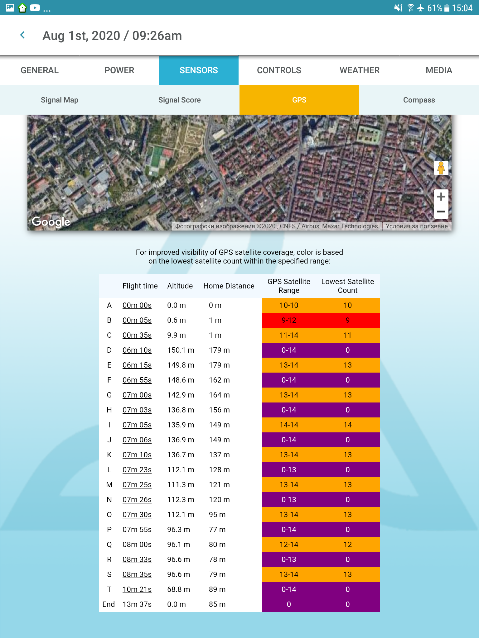

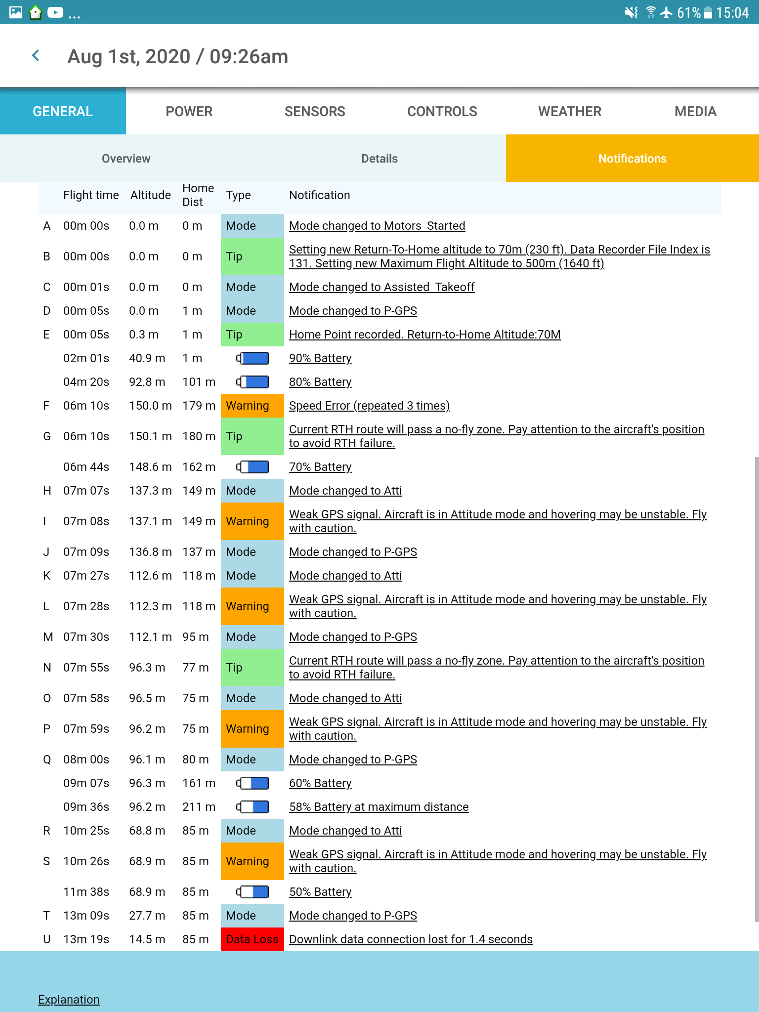

Hello colleagues, let me ask for advice:
For the second time the drone / Phantom4adv /samsung tablet/ does the following after it took off and had gps coverage, starts losing and receiving a GPS signal, finally stops searching for GPS and switches to ATTI mode until landing, / the problem is not in the lack of GPS satellites, because I follow them on another device and there is coverage of at least 12sat. all the time.
After landing / and restarting the drone and the controller /, I make a second flight which is completely normal without loss of GPS. If he hadn't done it a second time, I wouldn't have bothered, and I would have given it a moment's embarrassment, but it's not.
Please advise what could be the reason for this behavior. I am worried that if I go to a service center without doing it constantly, they will not pay attention to this problem. I enclose photos from the fly-log / if anyone is interested I can send it to him.
Thanks in advance!
