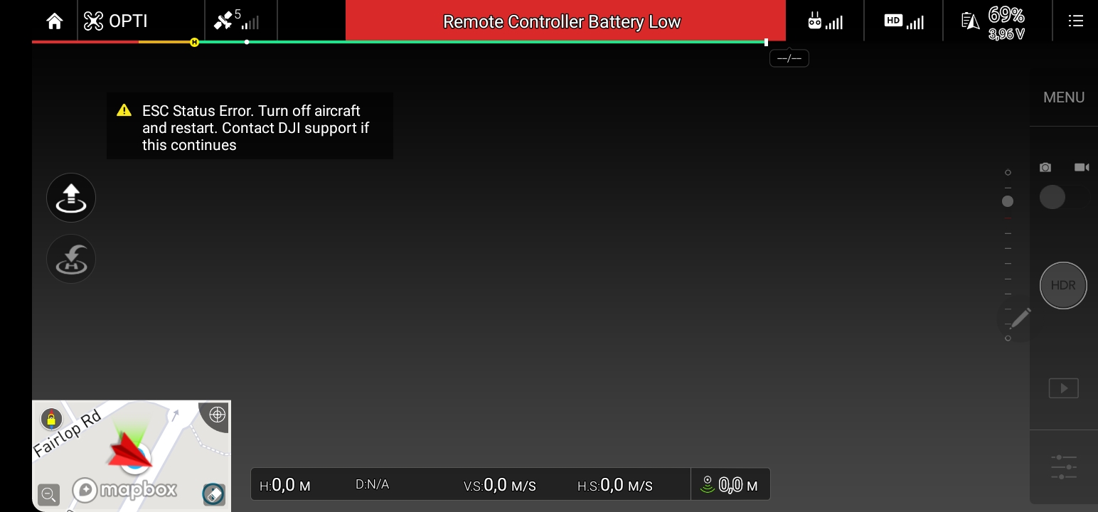

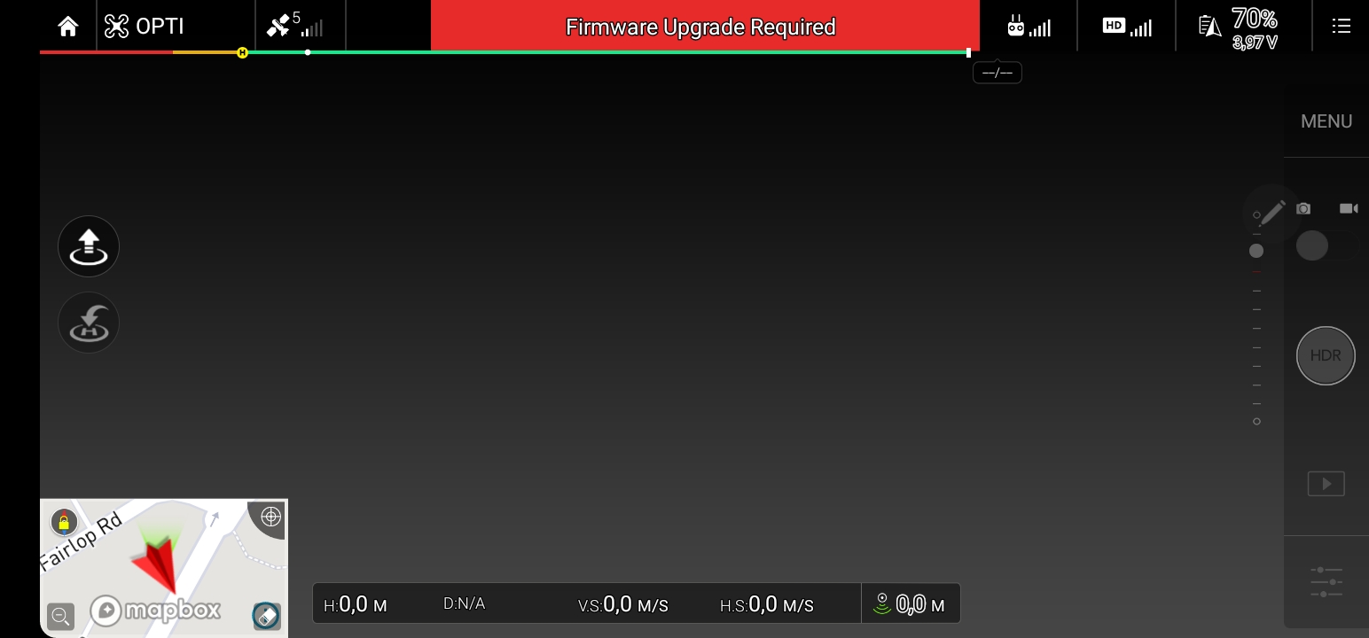

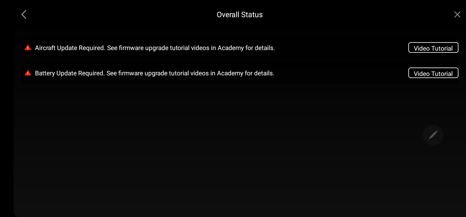

hi again, I'm still having problems with my phantom 3 advanced, when I turn on my controller it starts to beep, D-D-D-D constantly, non-stop, does not want to charge, I left it overnight and nothing. When I open the dji go app and connect it, I get ESC status error, I don't know if it has something to do with it. i opted to buy a new battery but it still won't charge, could it be the firmware? I also tried to link the controller with the drone again and nothing, please help

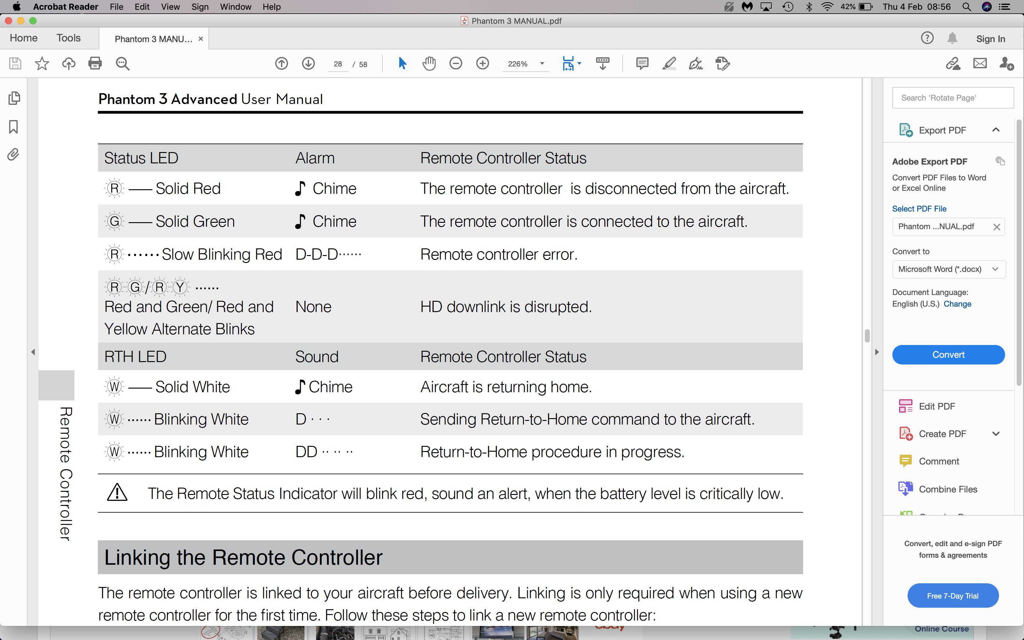

What is the Lefthand light on the RC doing when you hear the D_D_D beeps - see manual page below with suggestions.

What Firmware versions are you running on the Drone, Remote and device?

The firmware on the rc may need upgrade or downgade to work properly
DON'T START MESSING WITH THE FIRMWARE YET! More problems come from changing software than almost anything else!
Please answer my questions in post #4 so we can work through logically to isolate the problem.
Either your RC-battery level is criticaly low, or one of the sticks is not exactly in the middle position when you turn on the RC.
I remember having this stick problem a long time ago, by moving the sticks the problem was solved.
Somehow one of the sticks was stuck slightly off-center.
Trying to duplicate this stick problem at this moment:
I move the left stick about 1mm up, hold it there and turn on my RC (P3P).
Result: The status led blinks red and the RC beeps non-stop (according to the manual: remote controller error).
I let go of the stick and everything is normal again.
I don't know if this would prevent the RC from charging.
