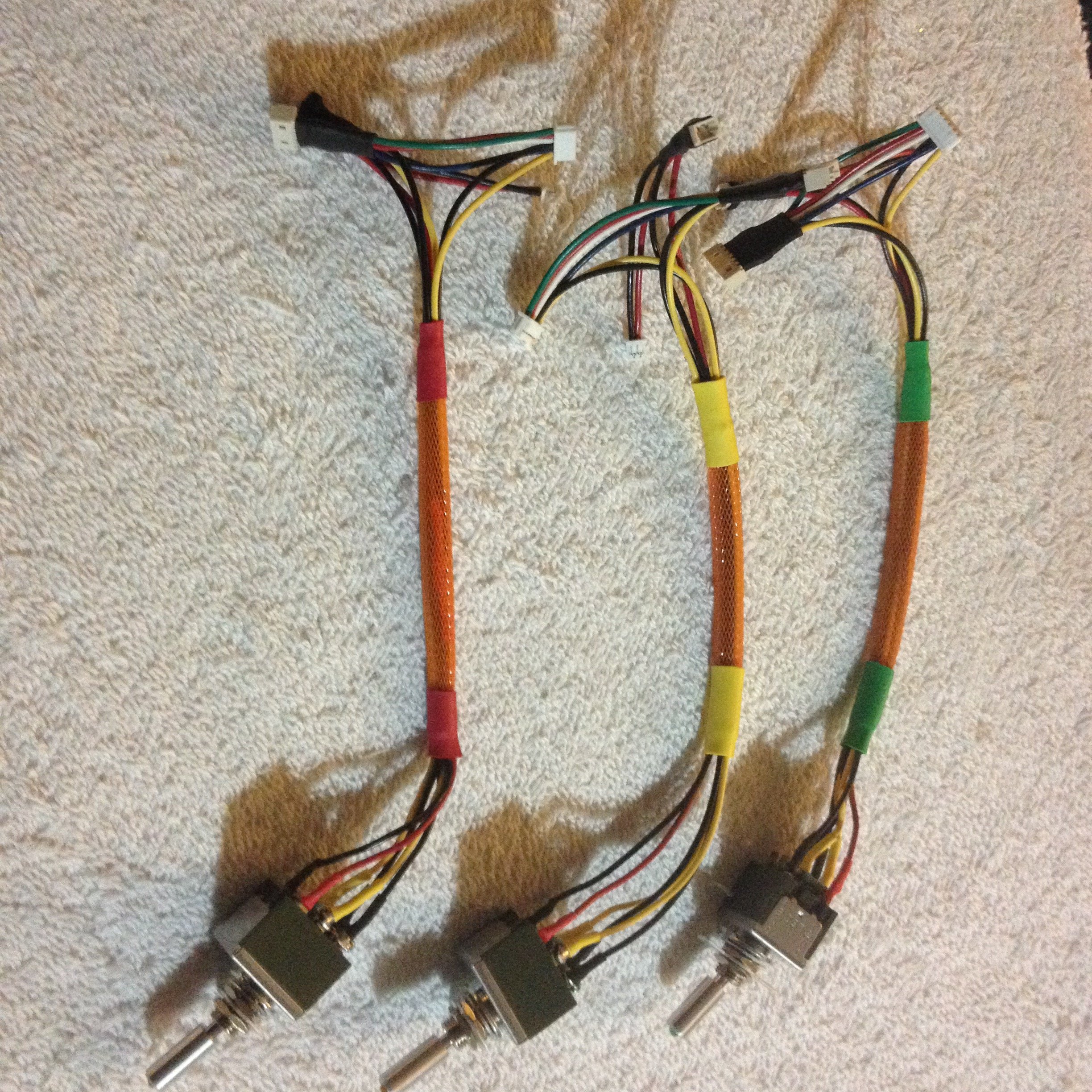

I've been building slow yaw mod switches for a couple years now,
Like these:
Full plug-n-play, reduced to 1/3 speed using 10k resistance, and my switches light up.
Check these out
And it working ( version 1 switch ) I'm on version 5 now.
Hope this helps

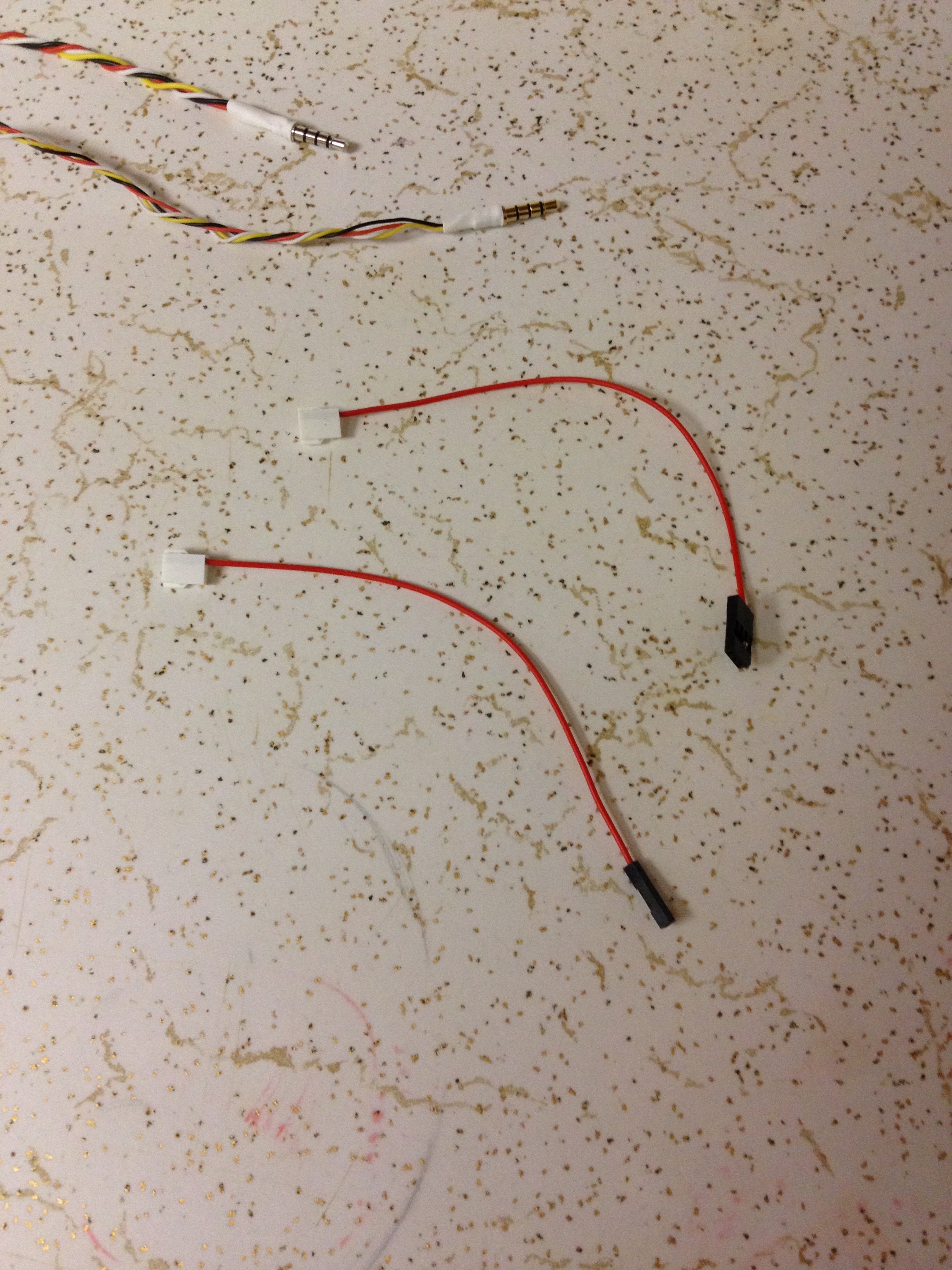

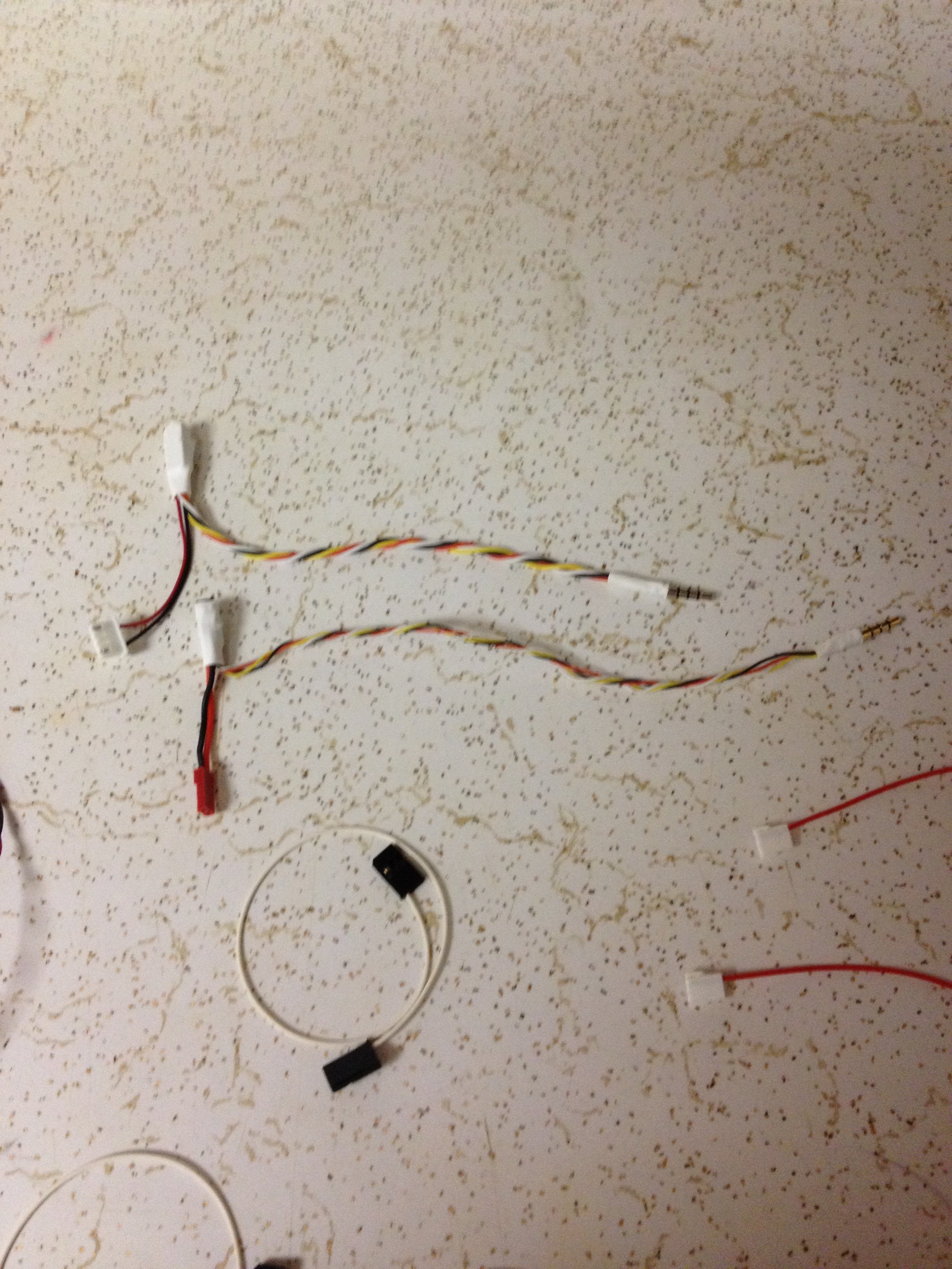

just ordered a 2D gimbal from banggood.com. what cable is it that i need to connect the power without opening up the quad. JDOT
Depends on what it comes with,
Unfortunately they are all different!
But
You'll need 2 wires ( may or may not come with gimbal )
1) Magic wire
The 2 on top of picture, there will be either a JST, or 3s connector, depending on your gimbal ( this lead goes between your white camera wire and camera, is a jumper wire with power tail ) so this wire will power your gimbal!
2) pitch wire
This wire will plug from your existing ( gimbal servo wire on belly of bird, to pitch pin on gimbal! ( there are 2 in picture! )
That's it, may need either, or both, or none!
J Dot
:cool:

Im pretty sure i need the top two wires,not sure about the bottom one. Its the gimbal from banggood.com. Non plug and play.
