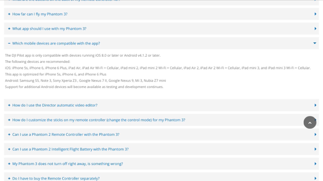

26- Which devices are compatible with it?
The Phantom 3 is compatible with the following devices running iOS 8.0 or later or Android v4.1.2 or later.
iOS – iphone5s/ iPhone 6/ iPhone6+/iPad air/iPad air with WiFi & cellular/ iPad mini 2/iPad mini2 with WiFi & cellular/ iPad air 2/ iPad air 2 with WiFi & cellular/iPad mini 3/ iPad mini 3 with WiFi & cellular.
Android – Samsung Galaxy s5/ Galaxy Note 3/Sony Xperia Z3/ Nexus 7/Nexus 9/Xiomi Mi 3/ Nubia Z7 mini.
With time, more devices will be added in future post firmware update.
