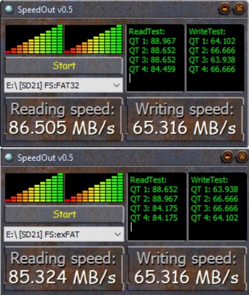

I'm not sure about the frame loss problem, but the 4Gb file size limit is due to the FAT32 allocation table. If you format your SD card using the exFAT allocation table you won't encounter the 4Gb limit. I've previously recorded a single file of over 20Gb on a 32Gb SD card using exFAT in my Nikon P900 camera.
Win10 will default to format an SD card of 32Gb or less in FAT32, but you can change that to exFAT in the format settings. The attached image is a 32Gb SD card which I've just formatted in both formats.

Regardless of formatting as either FAT32 or exFAT, the Phantom will still split video files at ~4GB even though the exFat format itself allows larger files.

Thanks for that info. I've never created a Phantom video big enough, or detailed enough to really experience the problem. Now I understand the OP's question and was obviously looking at it from the wrong direction. My experience of larger file videos comes from experimenting with real time star trails, flower bud opening and duck egg hatching. None of which are best done with a Phantom.:)
