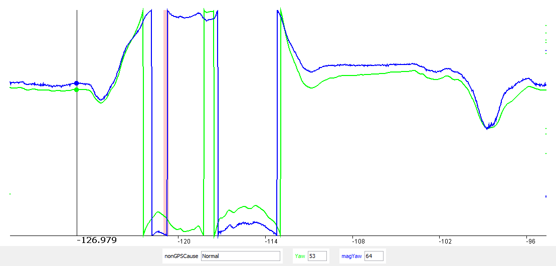

Thanks for the great tools.. here is something from a flight (I am guessing pre-flight due to the negative timeline). It's almost like a coding bug or something where the values are rolling over incorrectly...

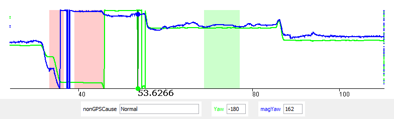

And another flight (again wasn't looking for the compass error)...
Instead of Dropboxing the .DATs you could put the the .csv files in a .zip and attach that to a post. Those .csv files will be in <home directory>/.CsvViewDir/temp. The next version of CsvView will have a "Export .csv" option.
