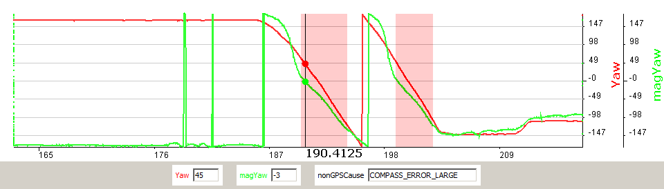

Sounds kind of like what happened to this pilot
The red line is yaw; i.e. the P3's heading. MagYaw (green) is the heading derived from the magnetometers. Starting at 186 secs the P3 was rotated through 540 degrees. MagYaw should track Yaw but doesn't. In fact, the magYaw error depends on the actual heading (Yaw). When the heading is between -117 and 63 degrees the FC declares a COMPASS_ERROR_LARGE (shown by the red background)
another perfect set of flights from the second phantom, did not even bring the first one today.

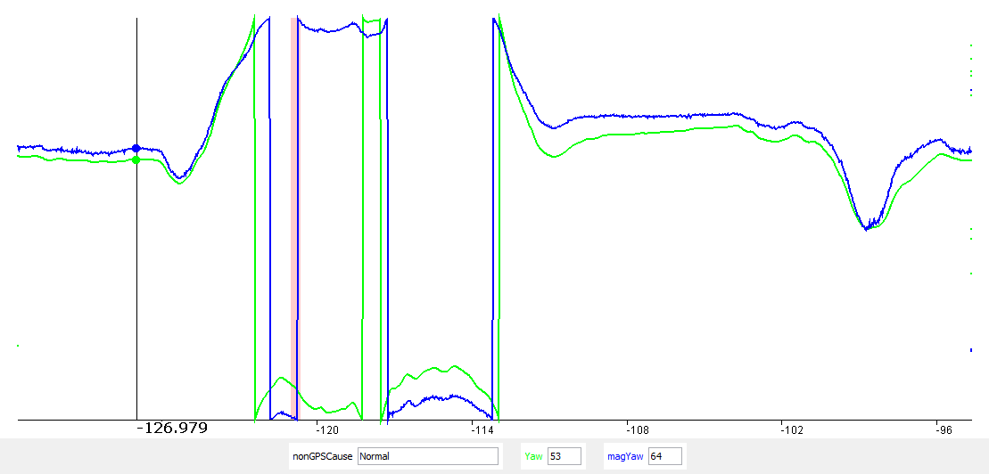

Thanks for the great tools.. here is something from a flight (I am guessing pre-flight due to the negative timeline). It's almost like a coding bug or something where the values are rolling over incorrectly...
And another flight (again wasn't looking for the compass error)...
Thanks for the great tools.. here is something from a flight where I encountered the compass error (looks like i was doing a pan around). It's almost like a coding bug or something where the values are rolling over incorrectly...
Yikes!! I keep mouse wheeling these images to try and zoom in on parts of it:) Any chance you could Dropbox (or equivalent) these .DATs?
Not sure what you mean by rolling over incorrectly.
In the first graph it doesn't appear that the Yaw/magYaw separation is dependent on the heading (Yaw). But this is before motorStart.
In the second graph it does appear that the Yaw/magYaw separation is dependent on the heading (Yaw).
You might want to look at gyro, accel, and magMod and see if there is any connection with the compass errors.
