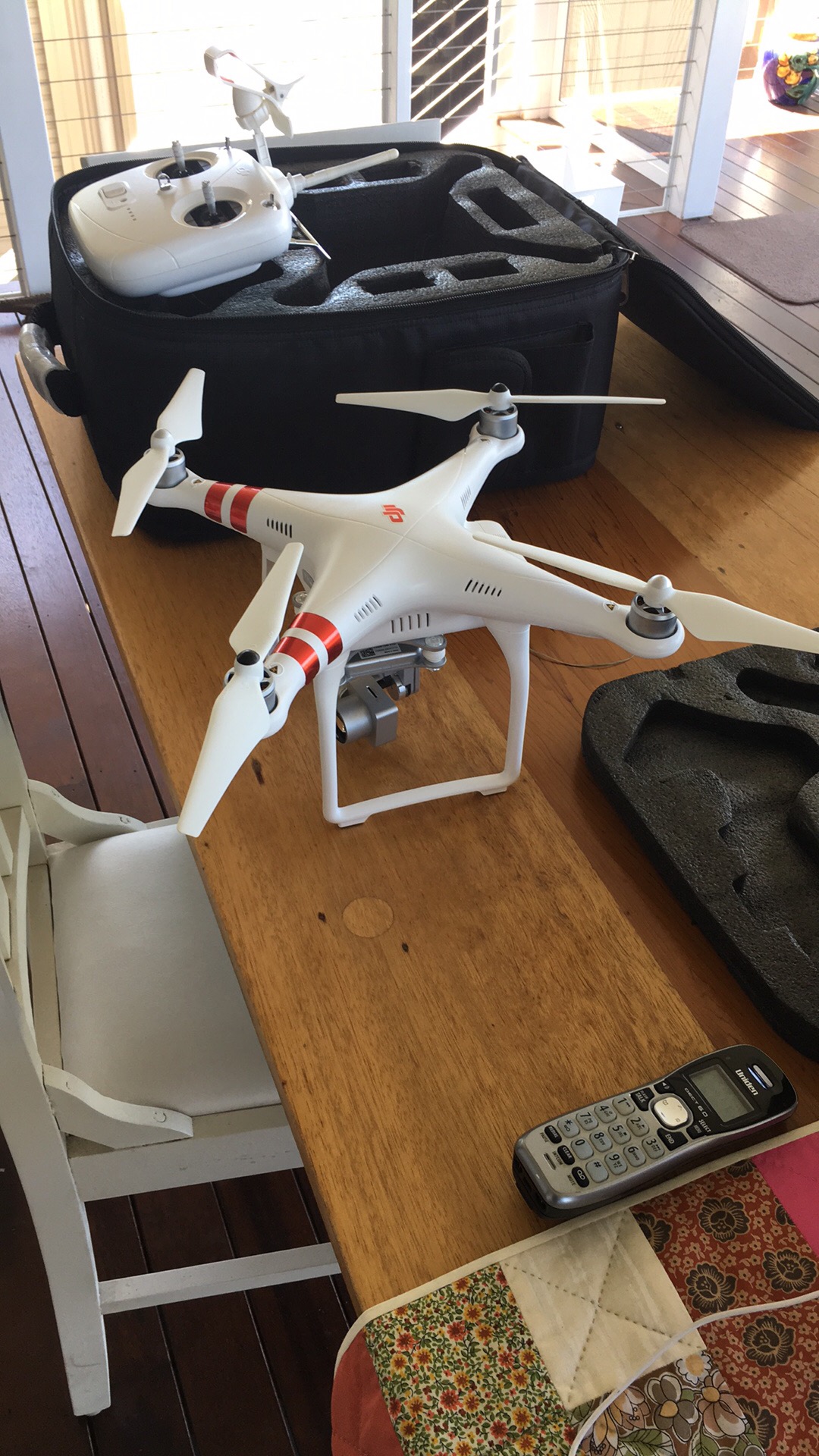

What type of memory card does the Phantom 3 Standard take and what is the maximum size Gb
