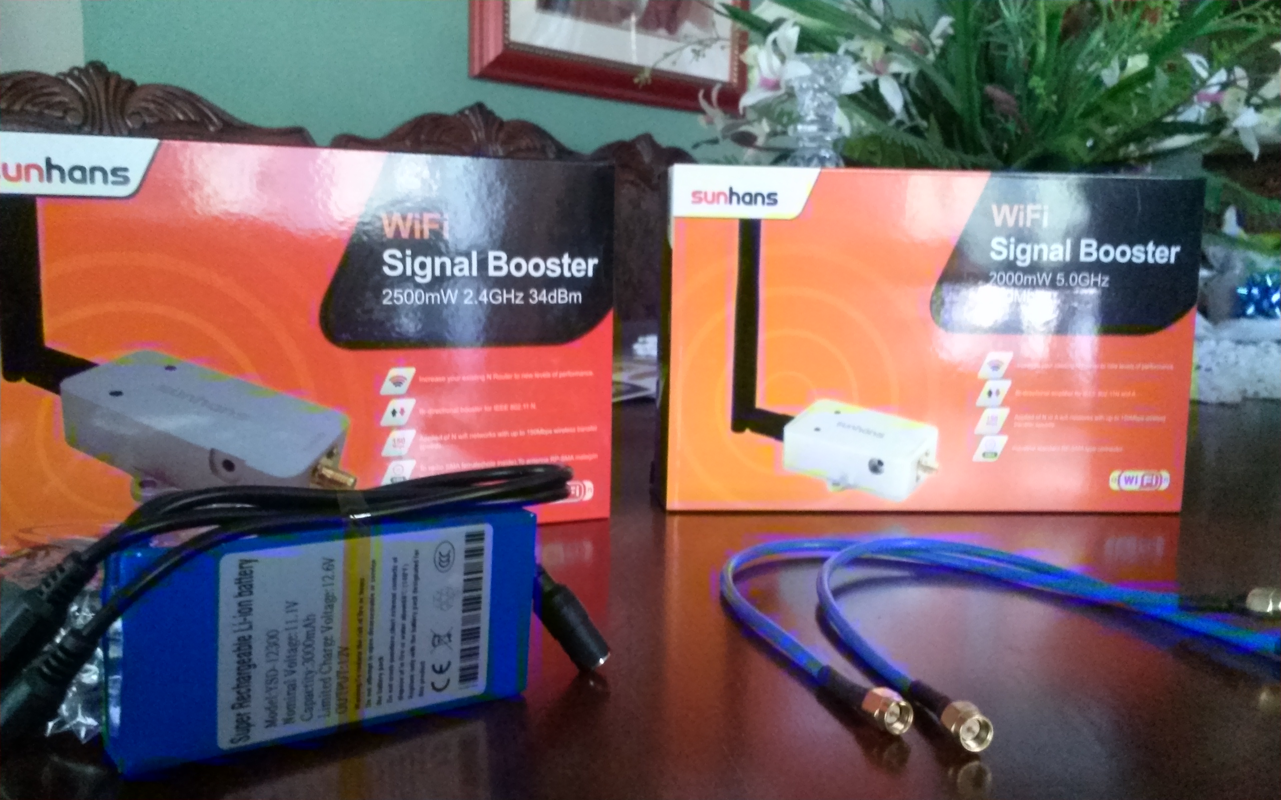

Hmm, I have 2.4 and 5.8 amps from my yuneec days, plus the battery to power them. They work for this right?
Hey Shockwave, unfortunately that will not work. The P4P does not have dedicated 2.4 & 5.8ghz ports. They both run on 2.4 & 5.8. Those amplifiers are not dual band. We have dual band amplifiers on the way though. We'll be launching our EvoLite kit soon.

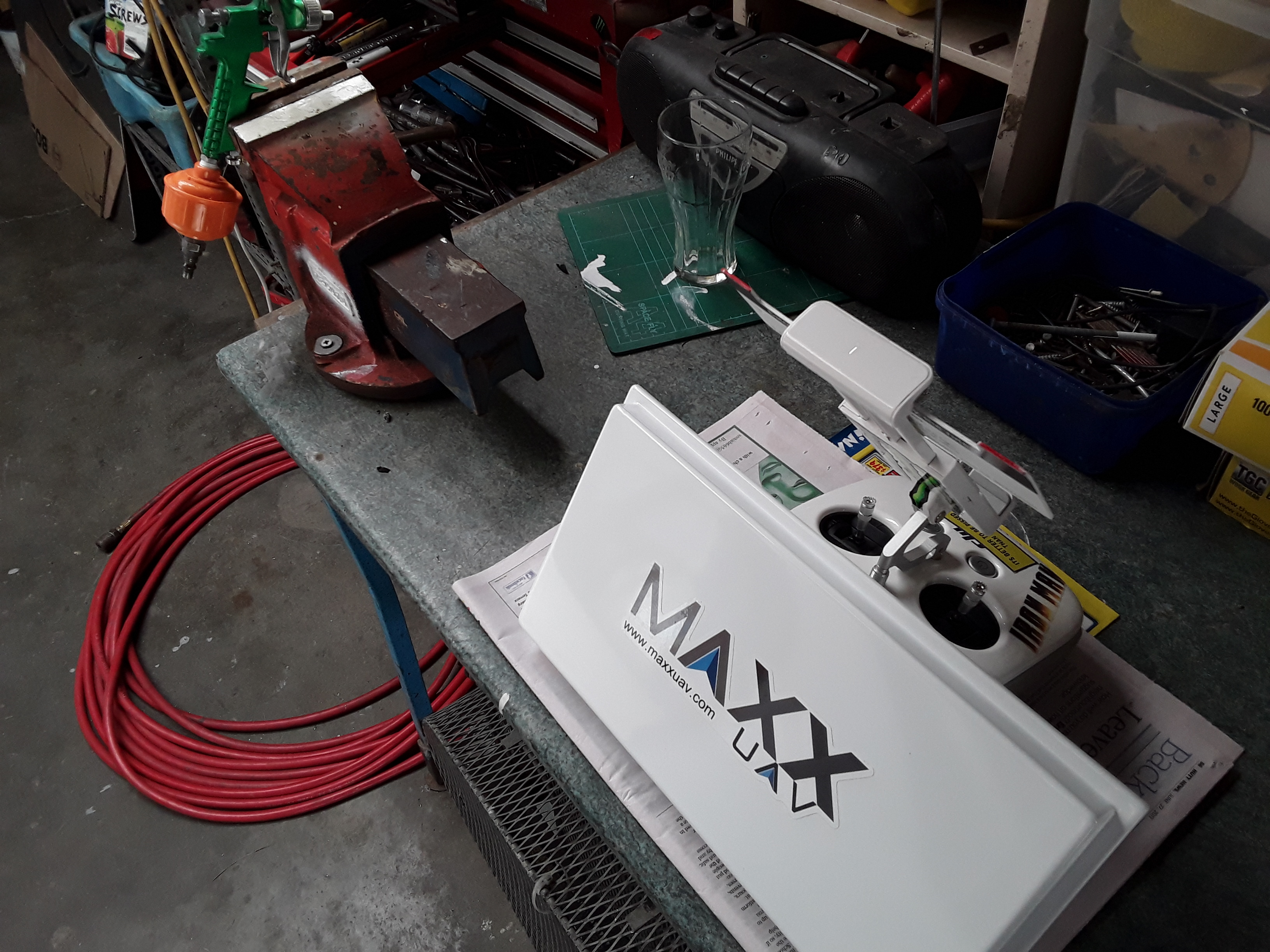

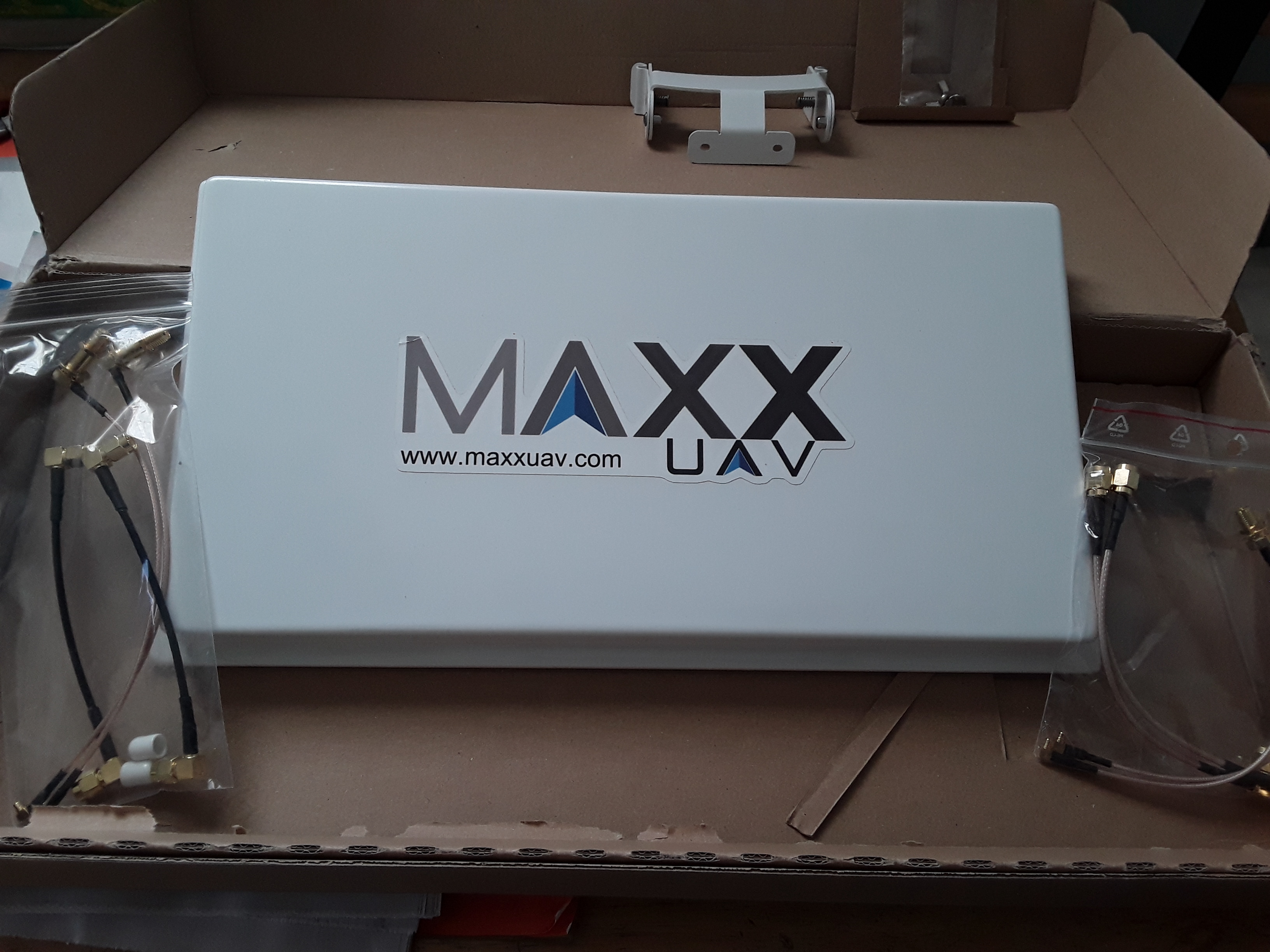

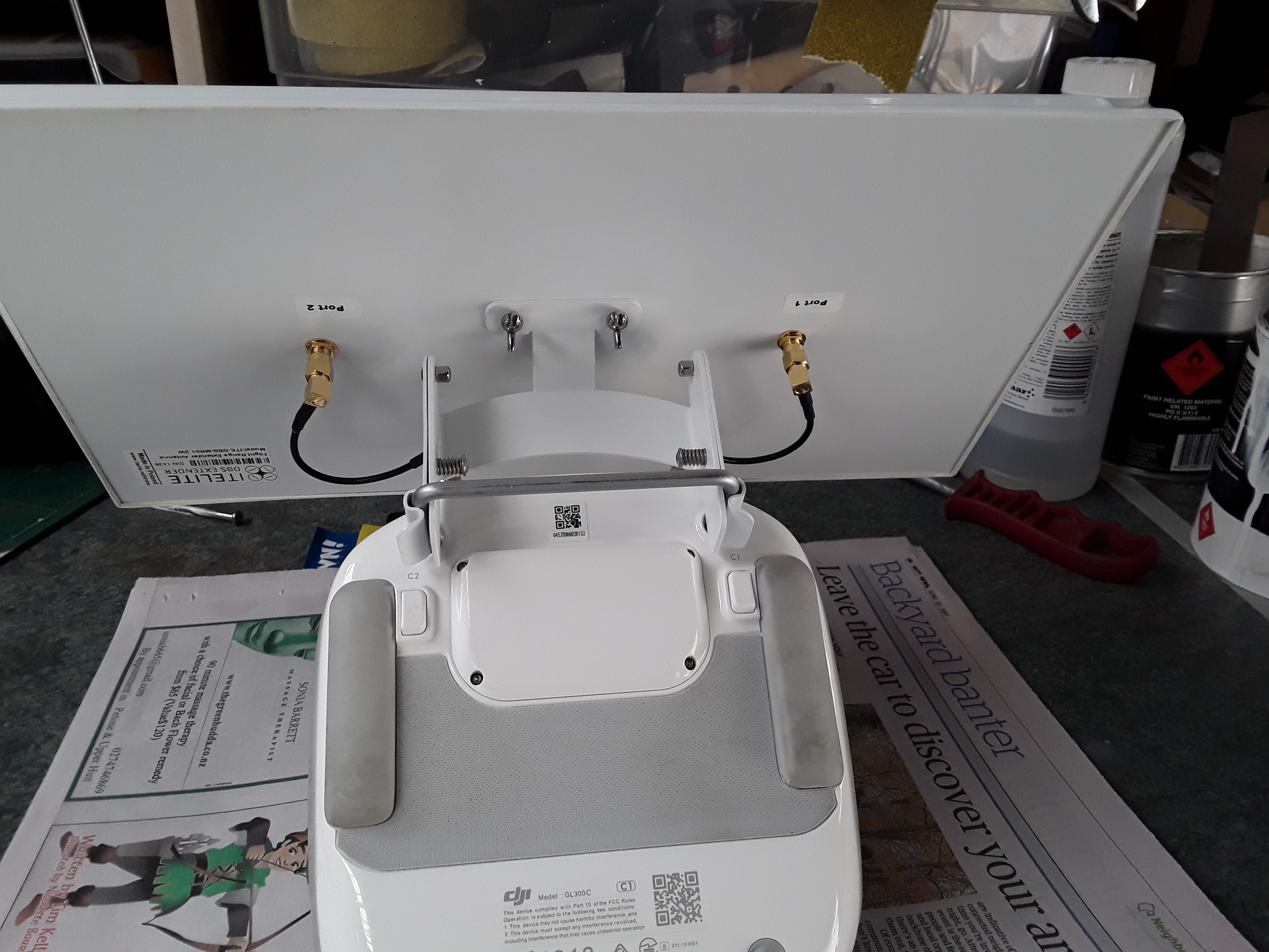

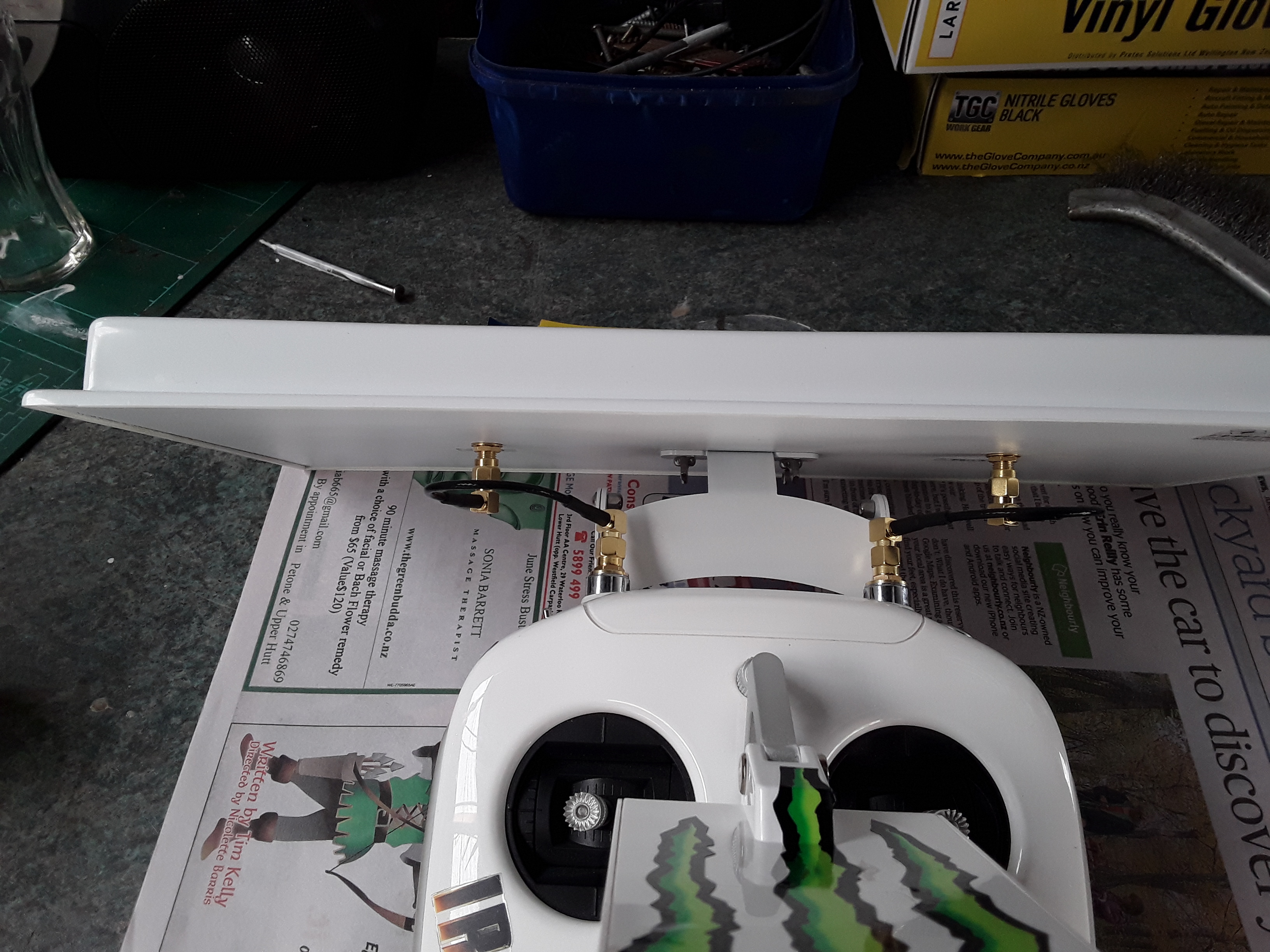

Wow that was quick , it looks a little bigger there I thought what are the dimensions
345mm long and 190mmwide ,pretty staight foward i think hardest part was unplugging ribbon cable behind usb port cover,once i worked it out was sweet, i go test soon ,trying to do 3 things at once but will update,:)
