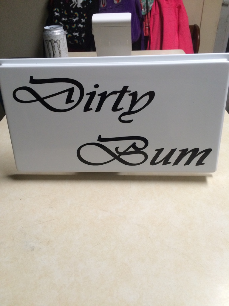

My mind is blown and my face is melting and dripping onto my good shirt!
Ha, not real, I superimposed it onto an antenna pic in this thread by combining 2 pics I googled and blending them together. How cool would it be to have a sticker like that though.
