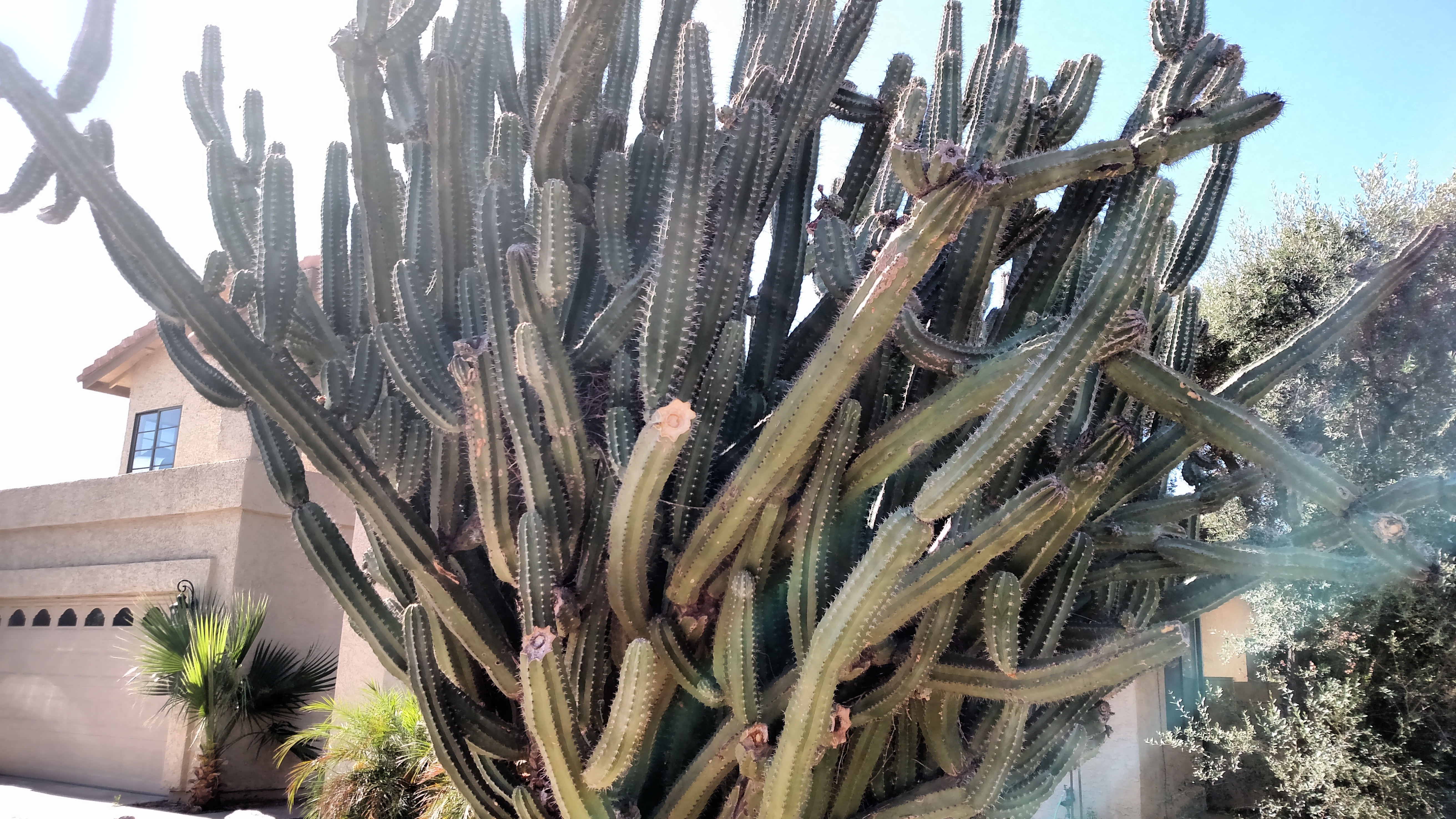

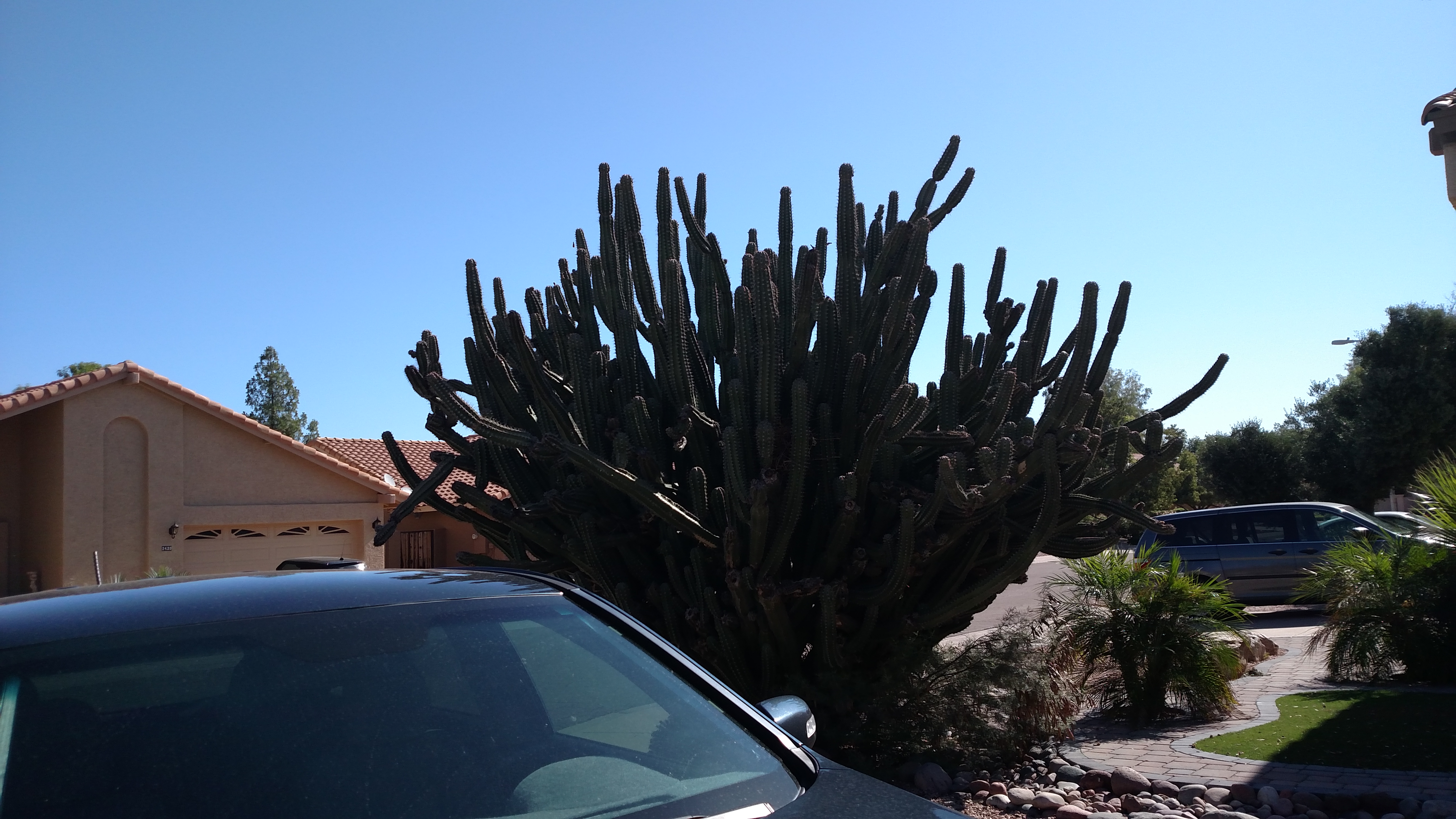

Db & Ed I have one for you and I know there is a few guys from the southwestern states that have this to control though. I did not even think about it till this morning I was doing a quick flight around my neighborhood and you want to talk about thigh trees. How about a 4 foot wall of water. I did loose my sign, the drone was about 800 ft out. Db I know you don't have a cactus in your front yard. I just walked around it and got the signal back. I thought I would share it with you all. Oh This was with my P2v+ and a DBS Etilite panel

Db & Ed I have one for you and I know there is a few guys from the southwestern states that have this to control though. I did not even think about it till this morning I was doing a quick flight around my neighborhood and you want to talk about thigh trees. How about a 4 foot wall of water. I did loose my sign, the drone was about 800 ft out. Db I know you don't have a cactus in your front yard. I just walked around it and got the signal back. I thought I would share it with you all. Oh This was with my P2v+ and a DBS Etilite panel View attachment 53102 View attachment 53103
Oh wow, that makes complete sense. Radio waves do not travel well through water. Having to send radio through water isn't really common for anyone except high humidity, rain, fog...I never thought that **** cactus is pretty much all water. It would certainly kill your range!
Yes since I got completely blocked by a construction semi truck backing up right in front of me for 20 seconds 10 feet away from the end of my 15 turn super canon boosted and didn't drop a bar I'd say a cactus pretty much reigns supreme as ultimate signal killer[emoji41](and it does make perfect sense)
Cactus a signal killer? That's the least of it. I wouldn't be surprised if there's some cats, dogs, or even humans buried in that thing! That cactus would be on my list to be removed entirely. But, maybe I don't have enough cactus appreciation. There can't be cactus huggers can there? That would be painful, I would think.
Reactions: Reed L and dirtybum
