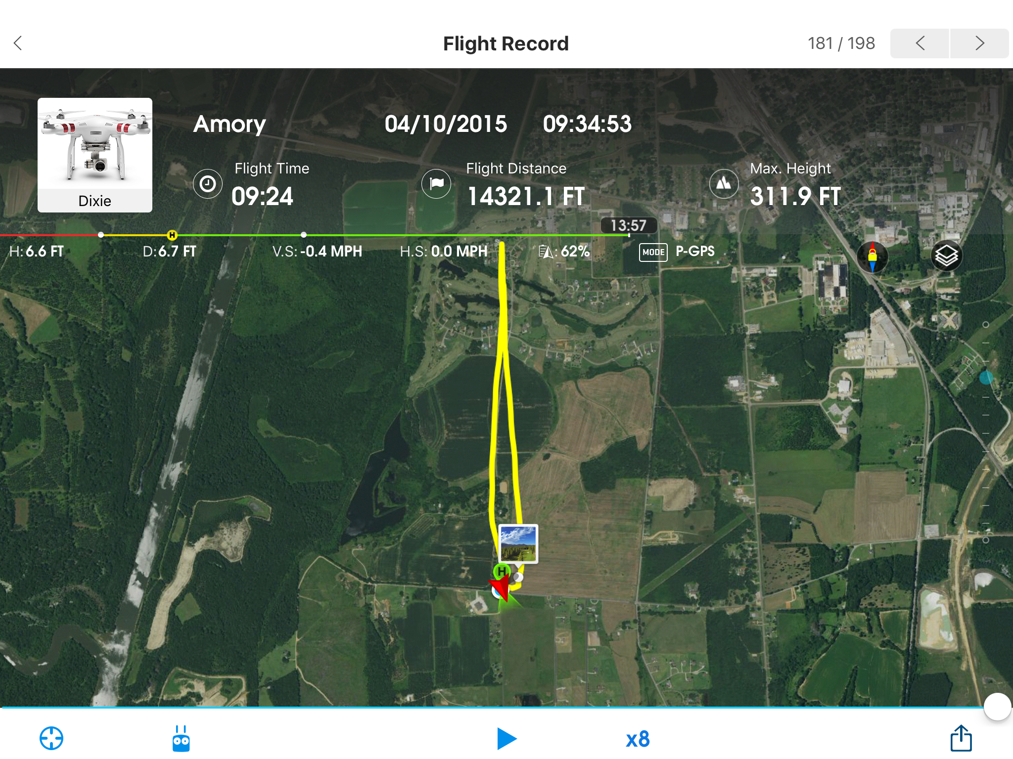

I know Dirk got close to 7000' as I just him and I saw the complete flight log and healthy drone reports. It is real and we are not blowing sunshine you know where. Now if you really want to get out there pop on a DBS antenna! :D

Look at the distance 6670 feet on dirks

Dirkclod summarized the stock range issue nicely here. I've been out as as far as 4500 feet with stock - but I only tried that once. I have different results at the same location all the time. I have made it a habit to fly by visual, FPV and instruments on every flight. Some methods more than others depending on location and objective of the flight, but always by instruments. (Learned to do that here BTW.) I have only used a windsurfer mod (so far) and my max distance was 7949 feet. But that was to the point RTH kicked in - something I will never do again. Watch what the bird is telling you about video and controller signal strength and you'll always fly under control.
